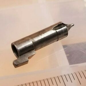

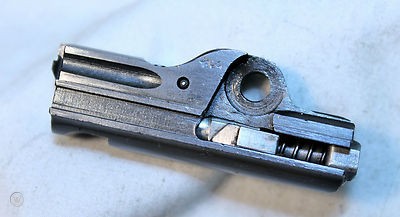

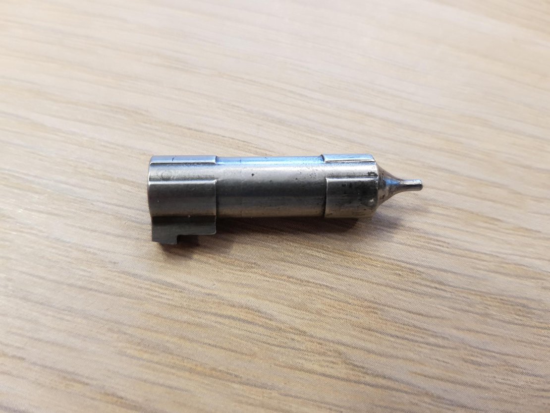

Don, while Gortz & Sturgess acknowledge that the flutes had the primary purpose of allowing oil and dirt to flow past the firing pin to prevent build up of residue that reduced the impact force of the firing pin, they also point out that the flutes do, in fact, allow gasses from a punctured primer to bleed off and reduce the rearward thrust of the firing pin that would otherwise cause damage if the firing pin was not fluted. G&S point out that it is a benefit but, as you state, not the purpose for which the flutes were intended. G&S red books, pages 1115 & 1116.
Doubs,
I know G&S "say" that, but it is a physical impossibility.
"They" got that statement wrong; it just is not physically possible, there is no where for the gas to escape to!
Marc,
The reference to the fluted, or gapped alignment disc shown in the drawing for the rifle bolt is an entirely different situation, and those channels do lead to an "expansion" area and eventually to the outside of the bolt.
Carefully observe the length of the grooves in the luger striker, and how far they extend, and find where the closest gas "escape" route is- the two do not intersect.
There is a slight possibility that some grooves cut by hand, when an old style striker was modified to include the grooves, "Might" be cut deep enough, and long enough, and in the correct alignment with the sear tab opening to "connect" just a bit-
But that condition is only met if all three requirements were met by accident !
Such a co-incidence was not intended and is not observed in machine/jigged production strikers.
I know the presence of the grooves just begs for the answer to be "gas management", but it just is not so.

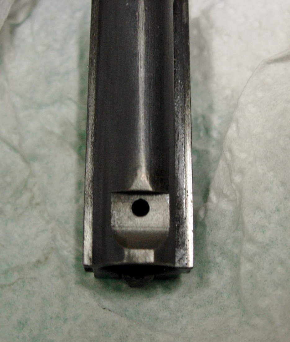

Just an addition note, the Finns added a "real" gas escape hole in the bottom of their breech blocks, that hole is far enough forward to allow gas to escape.
Swiss strikers have a flat milled into the front and rear bearing surfaces of the striker to allow gas to pass along the length of the striker and exit the breech block.
Both of these later techniques/modifications do serve to allow gas to escape from the front of the striker in event of a pierced primer.

Doubs, I know G&S "say" that, but it is a physical impossibility. "They" got that statement wrong; it just is not physically possible, there is no where for the gas to escape to!
Don, I understand. It's somewhat surprising that the flutes weren't extended past the collar to allow gases from a ruptured primer to escape. I've actually had a FP keeper shear the small lug off when a primer ruptured. I've often wondered if the keeper was made of softer metal for that very purpose.
I also once owned a Finnish M23 that had been modified with a hole in the breechblock to allow gas to escape. A logical and good idea IMO.

Doubs,
I'm sorry to say but I don't agree with you. There is indeed a way for the gas to escape. It's from the side cut of the breech block.
Mind you that you only need to relief enough pressure to prevent the firing pin to act as a piston and go full force backwards. And you know what? It works.
Unread 11-02-2020, 10:51 AM   #30
Kurusu,
That is the nearest spot/point for gas to escape, for sure.
A portion of gas can escape around the gap between any style striker and the breech block; but not due to the presence of the fluting cuts - but due to the normal tolerance between the two parts.
As I wrote, some cuts could be long enough/deep enough and could function that way.
Retract the pin all the way and see if you can see the flutes; most of the time one can't, but occasionally a groove does reach that point.
My basic point is that gas relief is not the primary reason or intended purpose for the flutes-which is to provide a place for grease/oil/debris etc- and keep the striker functioning; if they relieve gas it is serendipity at work. JMHO.

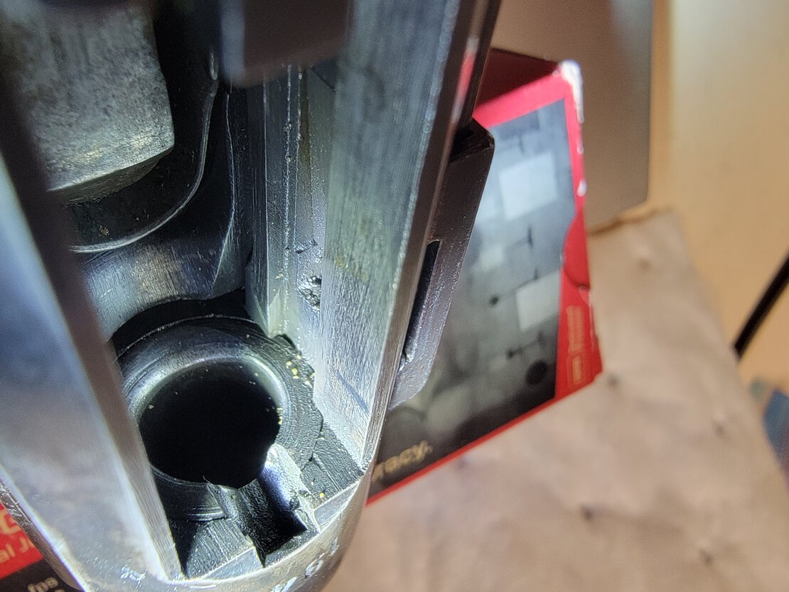

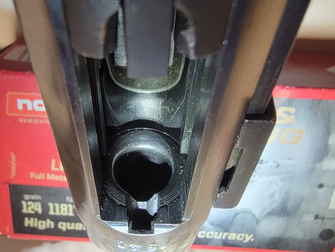

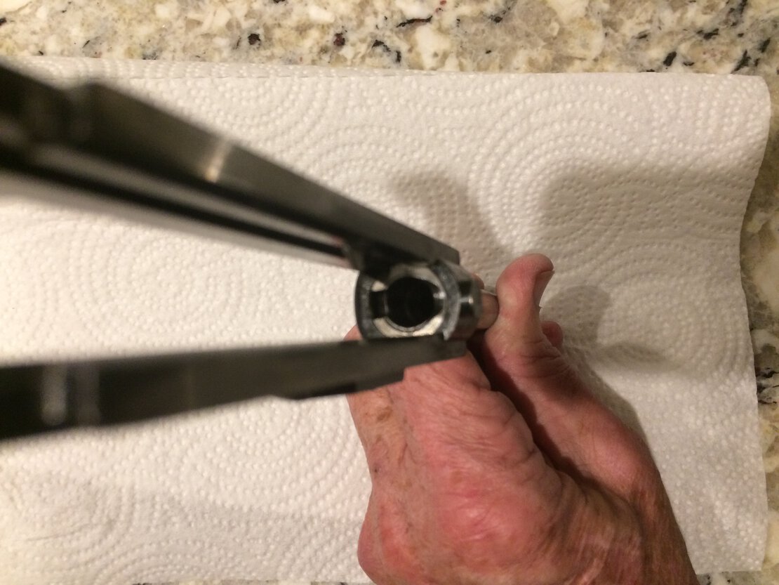

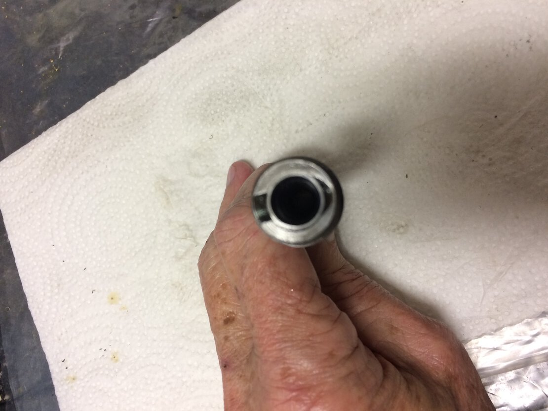

Well, I am hard headed, but I have to admit when I am beat. Since my last post, I went out and bought a second Luger P-08 to better understand the gun and what was correct.
So the gun with the issue I will refer to at 1940.
And the new one is 1916.
I am gaining an appreciation to the old armorers and the new guys working on these hand fit guns today. GTI think this gun will need to go to you, but I am not sure if the lower needs to go also.
The breach is not correct. Not sure if issue.
Extractor doesn't look correct. Not sure if issue.
The bullet ramp on the lower and the feed ramp on the barrel. The lower has had material removed. The barrel has not. I am guessing this is where my real problem is. This is beyond my skill set.

Hi RWBlue01, from the chamber pictures you show, the problem could indeed be the feed ramp cut on the barrel chamber lip? The frame looks fine to me, and I think we could do the barrel first and go from there? I could modify the ramp to the correct angle and length and range test it on one of my test frames to insure proper function? My mailing address is:

If I revise it and it works on my frames, it will be good, and if any problem still exsists, it is most likely that the upper will not be the fault...Just the complete upper for now.... best, til....lat'r.....GT...

From the picture, it almost looks like a relined barrel sleeve? either way, it can be corrected... best, GT
Unread 12-17-2021, 10:27 PM   #40

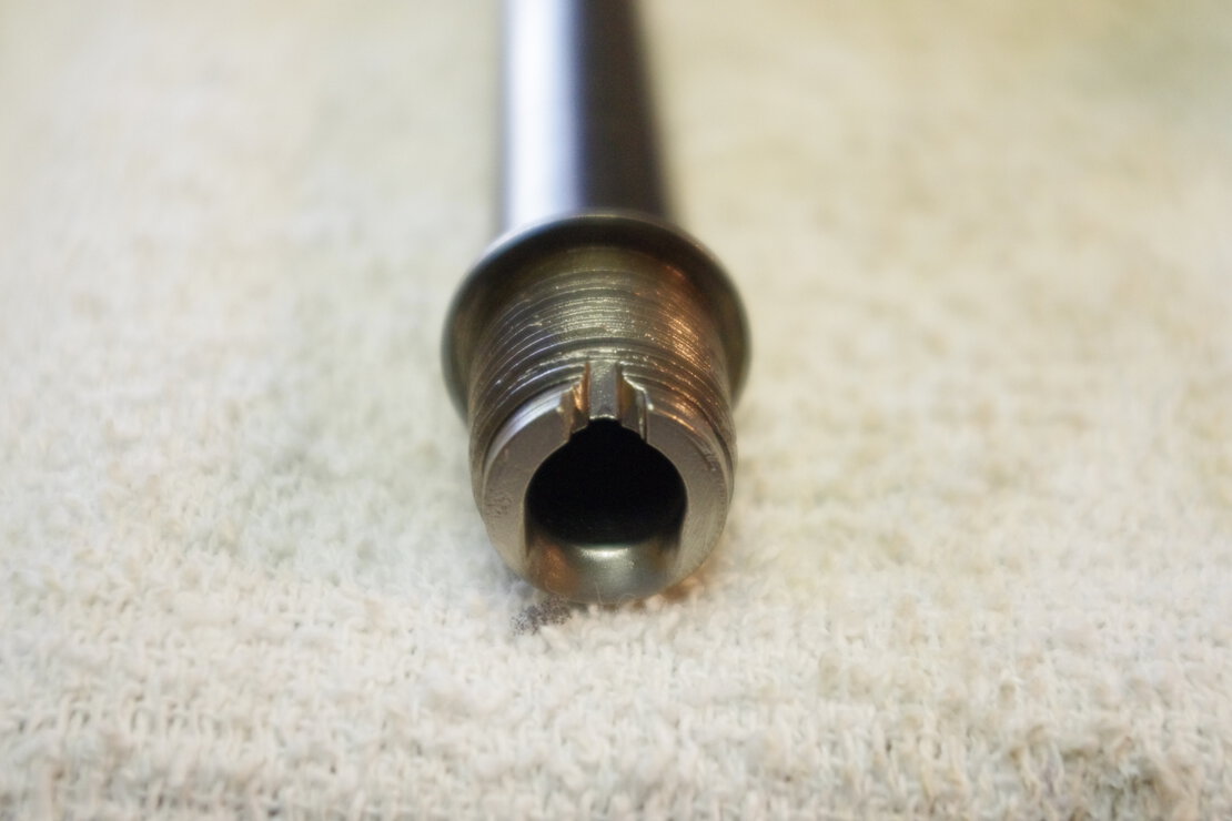

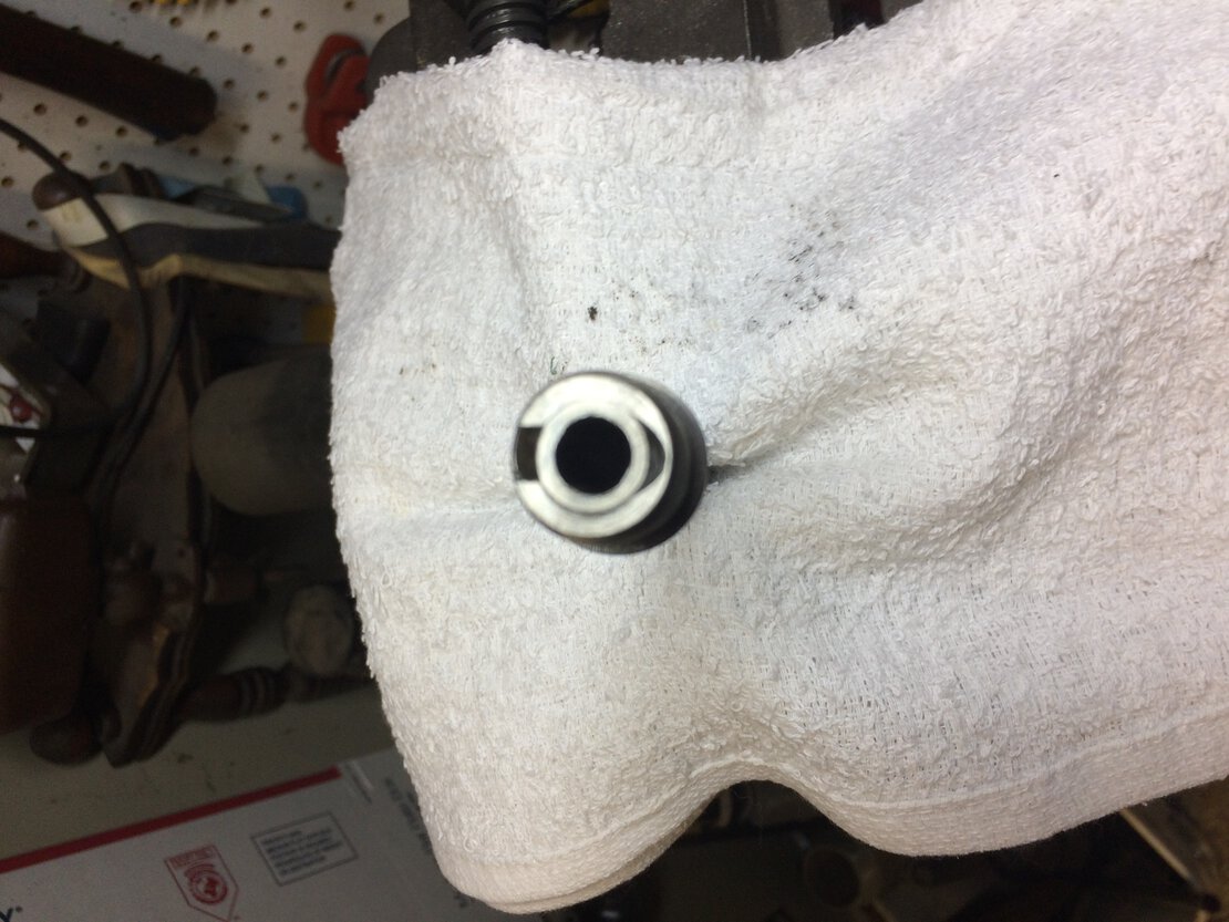

Have you tried the 1916 to see if it feeds ok? Fired it?
If the 1916 feeds ball ammo, it does not need any work on the barrel ramp.
Barrel ramps are only cut into the barrel, and not into the upper receiver.
The pictures below show a 9mm barrel with its ramp on top;
the next three show three stages in lining a barrel to .30 caliber.
The top picture shows the barrel liner in place, the second shows the .30 luger chamber reamed, and the third shows the finished ramp blended into the original barrel.
