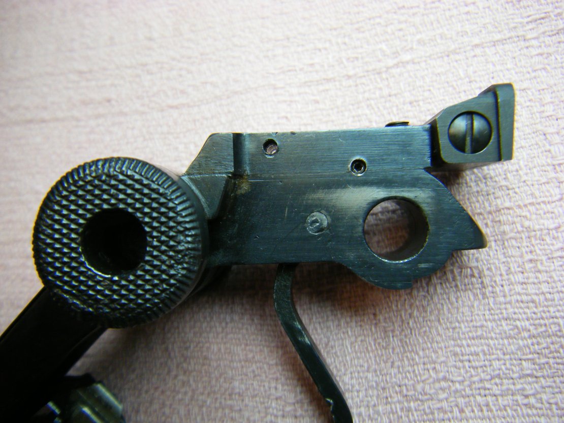

for possible reference here is an original dewey custom luger base with the original micro sight replaced with a bowen sight
the original micro sight had a damaged front section from usage as elevation - was bent at the point of the elevation adj screw
thanks
Bill

Quite a deal of activity here in this last week. I have been out of the country for the past week, but have been watching the thread progress via my email notifications on my phone. I'm definitely going to try loading up some 110 gr. loads, just to see if I can get the thing to work. I have received my Wolff springs and will install it when I get a chance. The laws in Canada are... awkward for this, and I cannot posses my Luger until is gets reclassified from Prohibited to Restricted, which is apparently rather easy to do, so fingers crossed.
Bill/lfid:
Thank you for more pictures of the rear sight base. I plan on doing something nearly identical to that. How is it attached to the pistol? I see a roll pin there, but I cannot fathom what purpose it serves.
I'll shoot you a PM back soon. However, tonight is late and I'm weary from travel. Having said that, I am very interested.
the Dewey rear sight base appears to be well soldered to a machined flat that removed the rear toggle original axle bump and sight. the front pin is the pivot point for the elevation on the micro sight/bowen eqivalent. the rear side "pin" near the soldered base line is actually a very small allen head screw that engages the elevation screw threads to prevent it loosening up from the toggle sight dynamics. problem in using elevation screw is that it likely fails - I suspect due to the bounce effect when the sight elevation springs get hammered by the toggle slap against the luger rear frame stop.
the Werle web sight has a reference that future target lugers would have elevation locked down and so elevation would be in the front sight. the pinned blade in your blueprint should allow variable height blades as needed - but the prewar colt woodsman 22 front sight method might be a better as allows adjustments.
VERY interesting project !!!
thanks
Bill

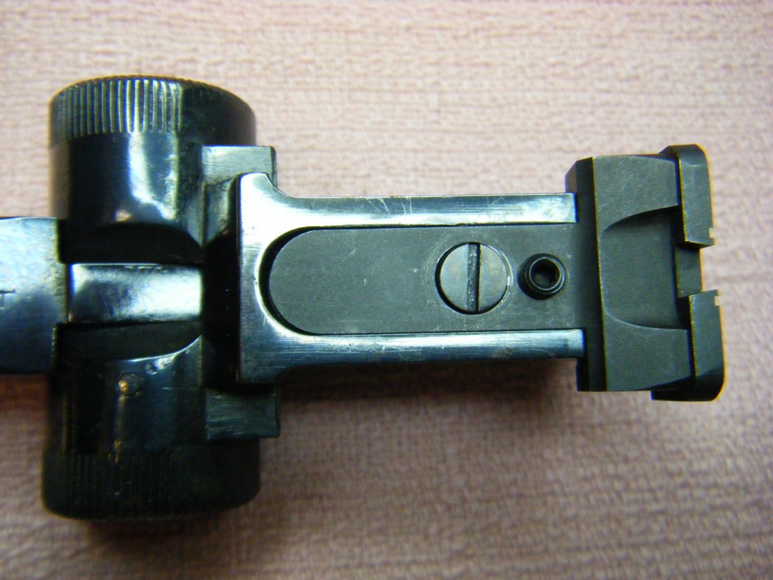

Default top view Dewey base
some more detail re the side lock pin and base design

Interesting how the base is attached. I didn't expect it to be soldered on. Figures though, and could potentially be better than a dovetail, or other friction based attachment. I'll post my other blueprints later. busy busy.
