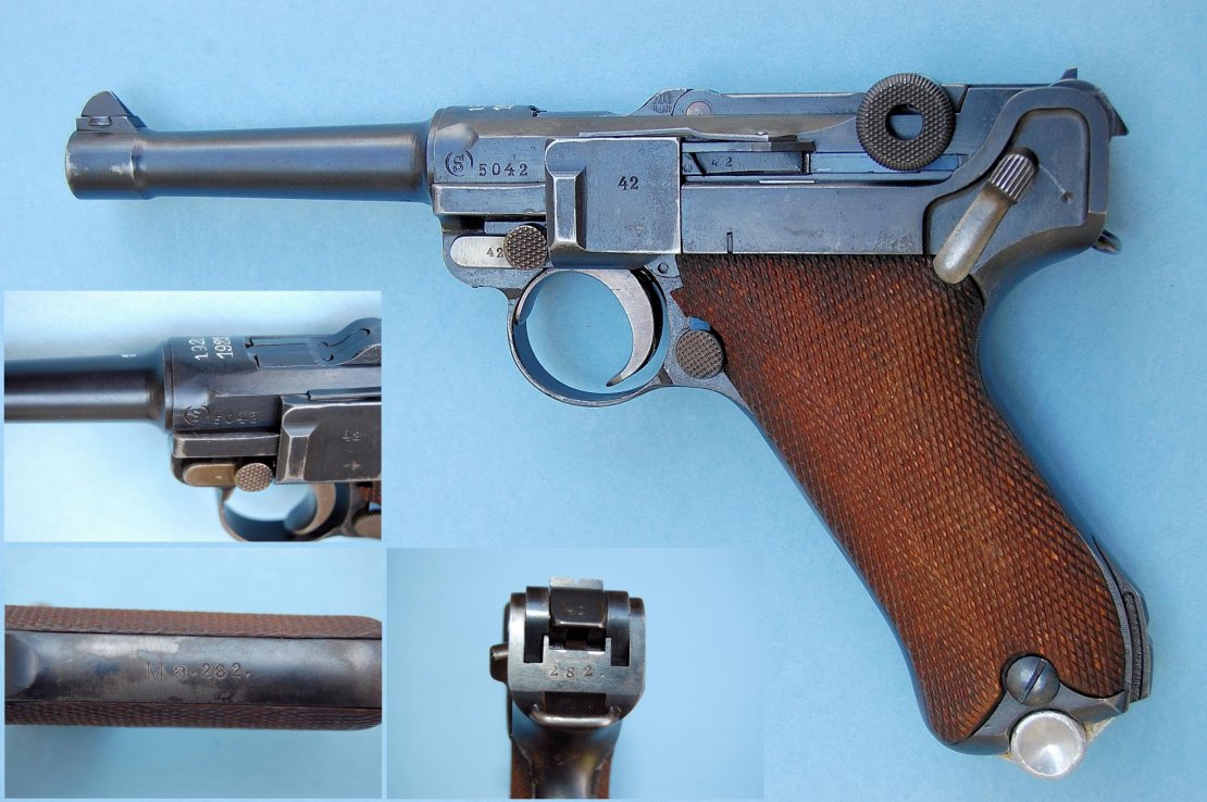

Default Corcle-S Police Luger
Information for your study: DWM 1921/1920, 5042a, Ma.282, sear safety present, mag safety disabled, grips unnumbered, barrel serial number and suffix with bore gauge, right receiver two WaA4, one ArA4, barrel ArA4, breech block WaA4. Rear frame 282, mag 282.
File Type: jpg 2010-03-271921-1920 DWM Police 5042a.jpg (143.8 KB, 286 views)
File Type: jpg 2010-08-051921-1920 DWM Police 5042a_1.jpg (102.1 KB, 247 views)
abzug is offline   Reply With Quote

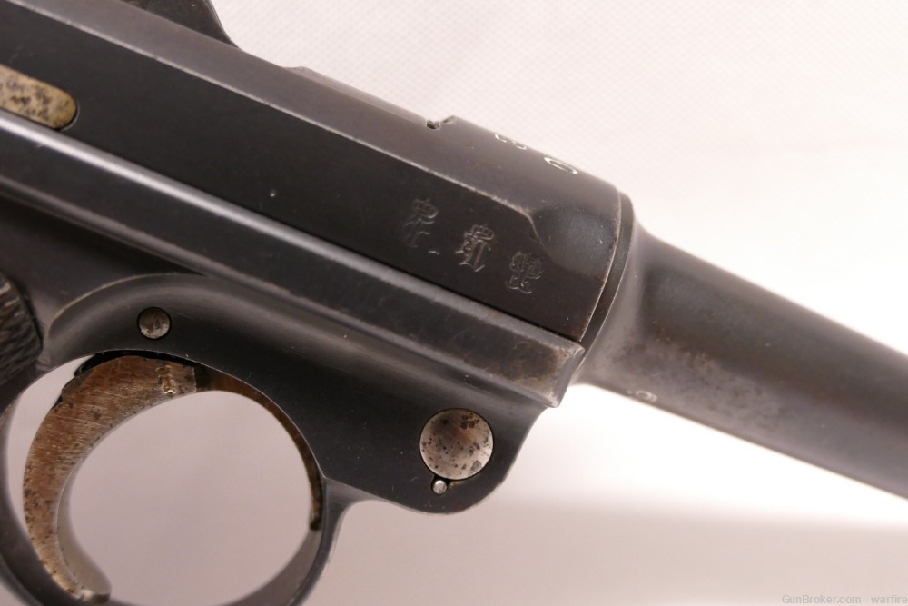

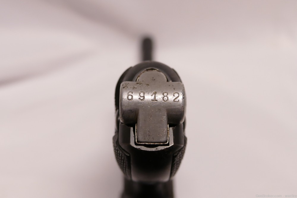

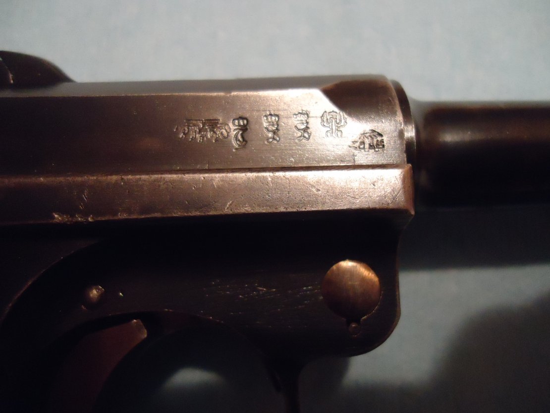

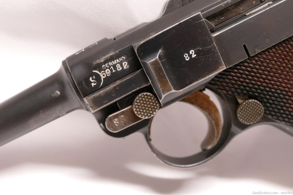

Originally Posted by ArtB View Post
I have 1912/1920 DWM, serial 69182, matching including alumnium bottom mag. Cut for mag safety which is no longer present. Right receiver proofs are standard for 1912. Left barrel in front of receiver has proof that is a bit double strike. I believe it is #48, page 85 Costanzo. Could possibly be #44. Left receiver in front of side plate, Circle S #110, page 190 Costanzo. Serial # is also on left front receiver and is an over stamp with faint couple previous numbers visable. Numbers are a bit out of line. It even appears that the number 1 was part of a previous number. Above the serial number on receiver is stamped a small "GERMANY". I acquired this in 1995 and it came with a 1939 dated holster, tool and extra mag. Inside mag pocket was piece of paper with name S/sgt Johnson written on it. Hope this helps.
This pistol has resurfaced and researching it brought me to this thread. Fifteen years later.
