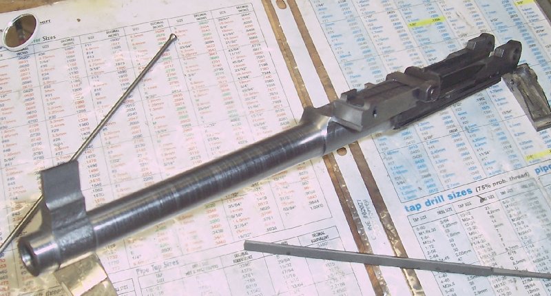

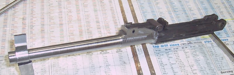

Got a bit more done tonight...Cut the rear sight base dovetail, and the dovetail for the front sight blade...

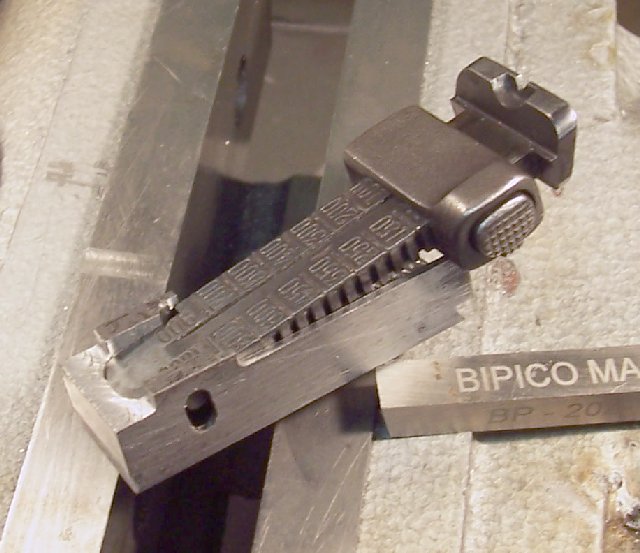

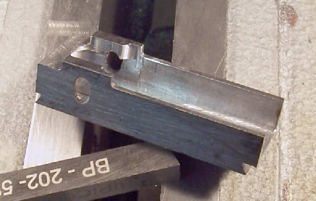

Got a bit done on the rear sight base today...Roughed it out; cut the dovetails; milled the ramp...I'm not entirely happy with it...I made a mistake with the axle hole, and the whole base ended up too high for my taste...(all your base are belong to us)...
Sight blade is not cut down yet; just looking at how it fits...
