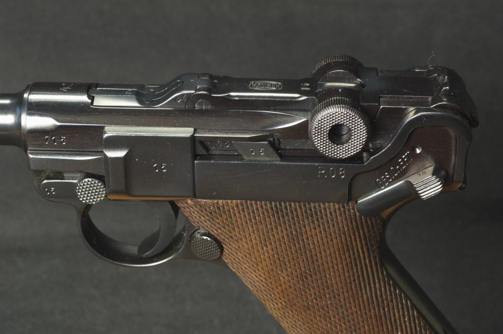

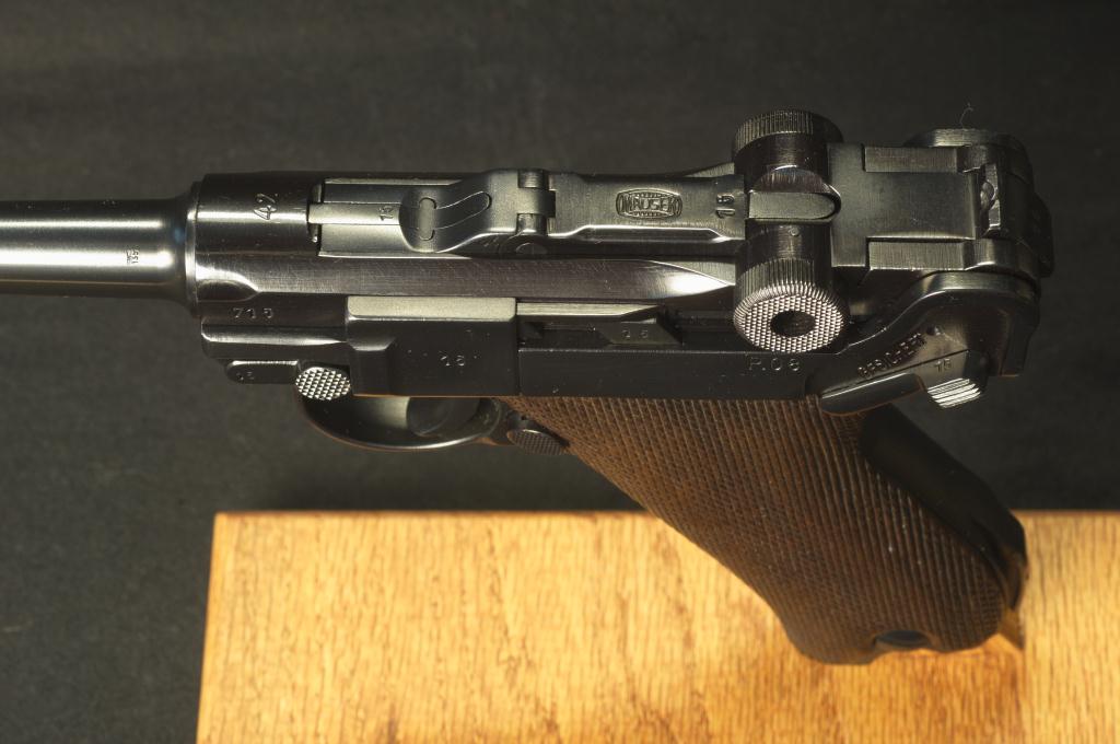

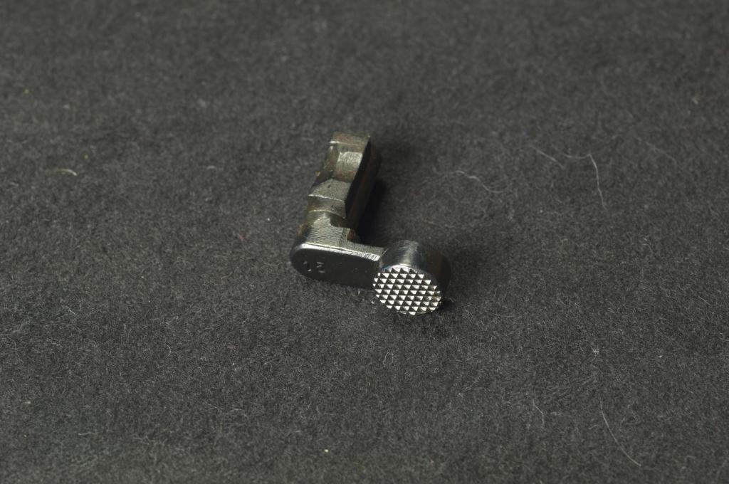

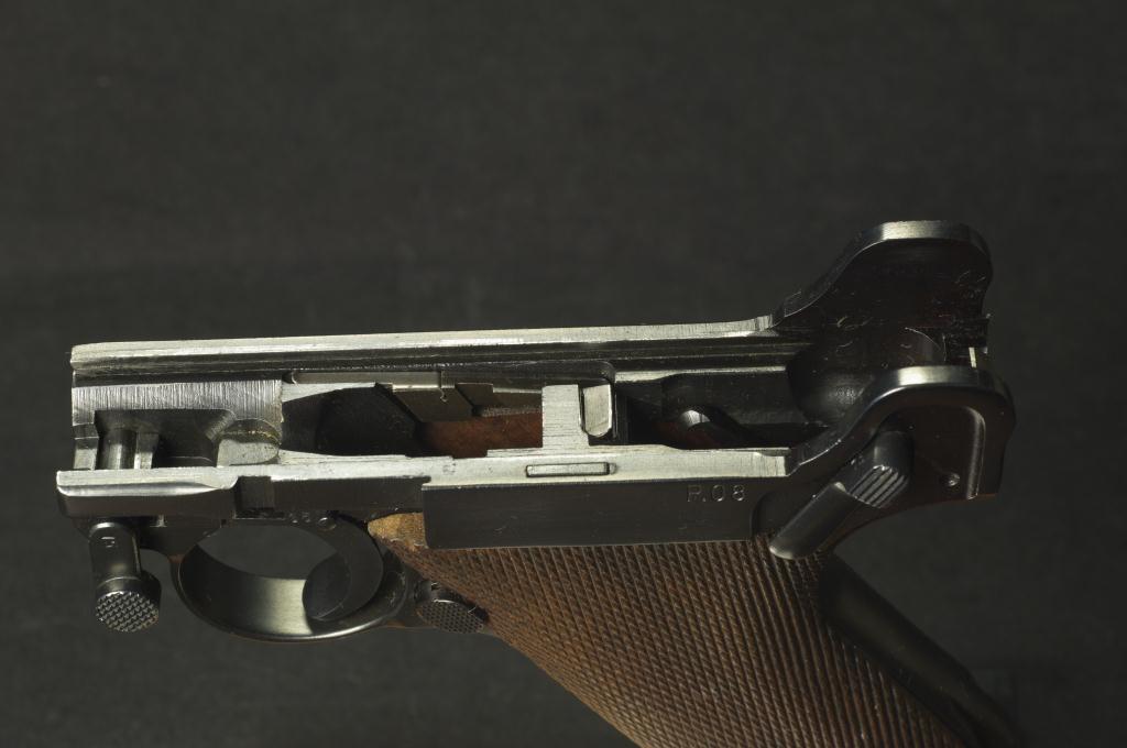

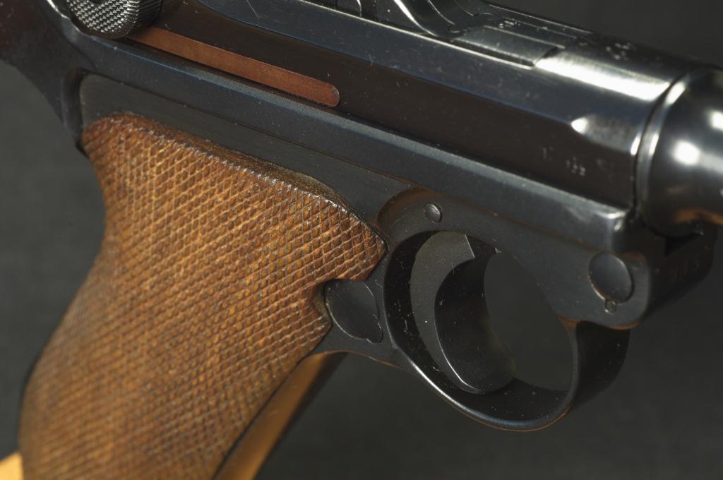

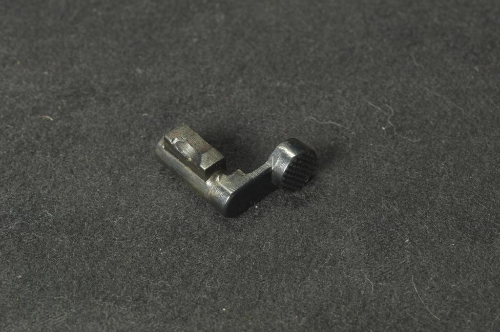

Souldn't the sideplate trigger lever and pin be in the white on an original blued Mauser?
Hi Jerry, Here's a sideplate on a 42 byf. I'm reserving judgement pending better photos. Best regards, Norm

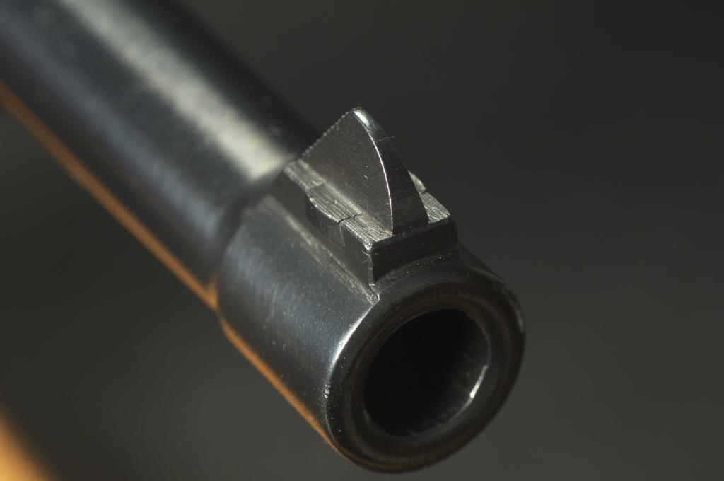

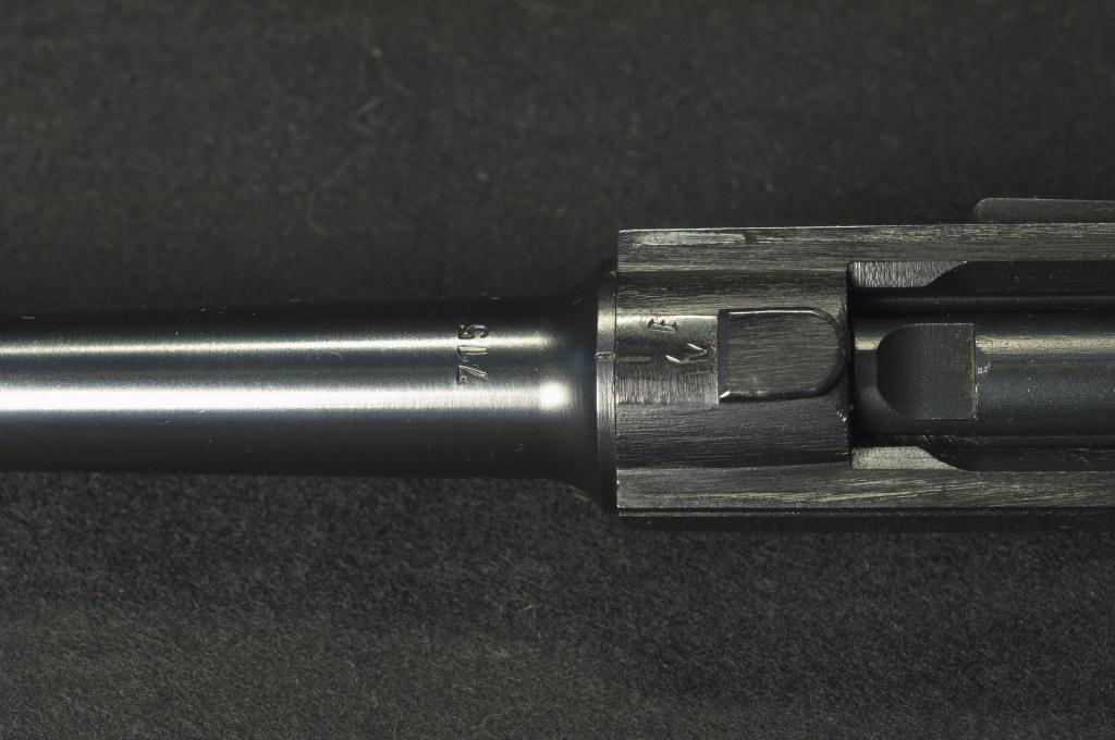

How is the muzzle? I guess Mauser Luger's muzzle is like their Broom, in white. And a new gun like this, the muzzle should still have fine machining circles visible....

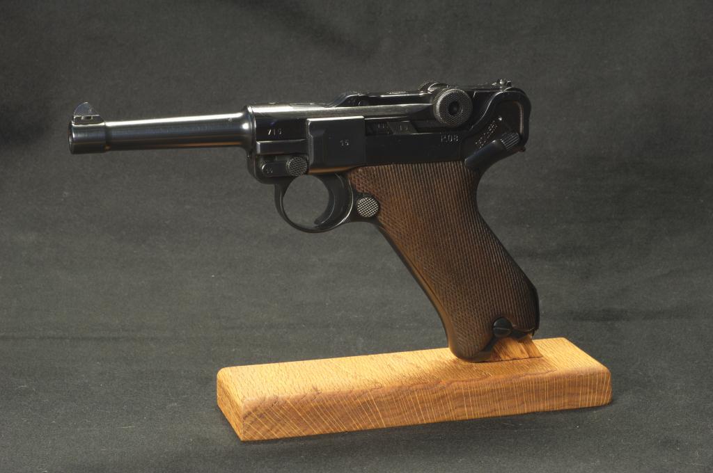

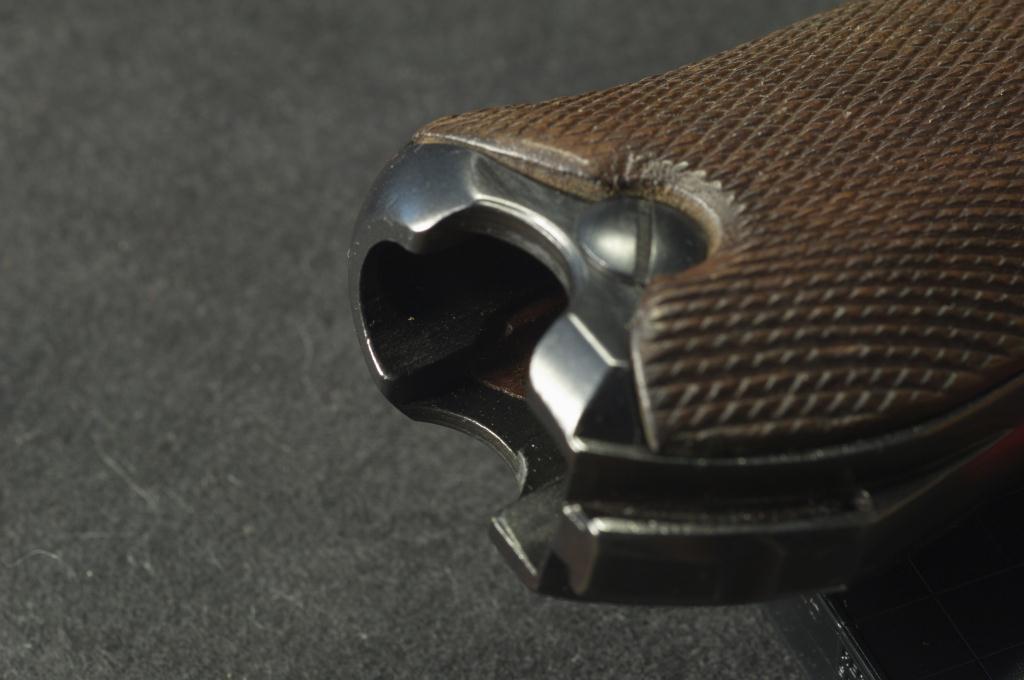

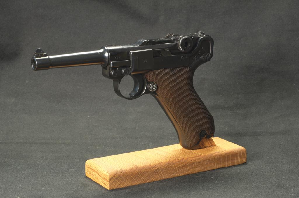

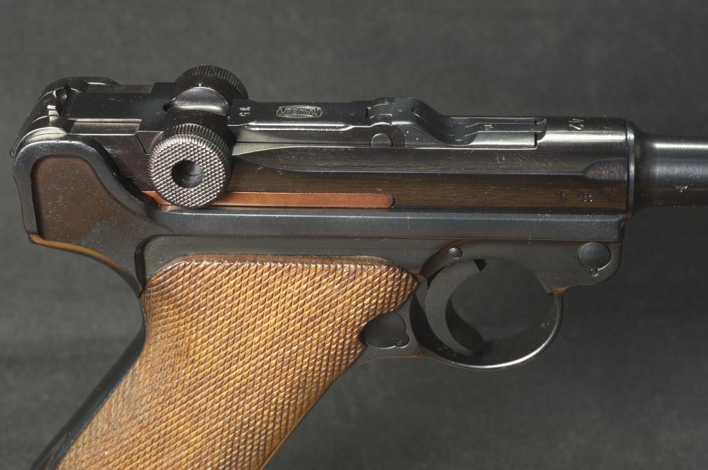

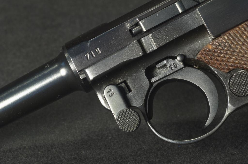

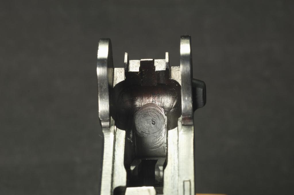

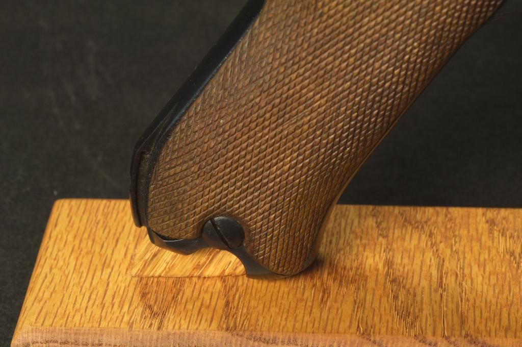

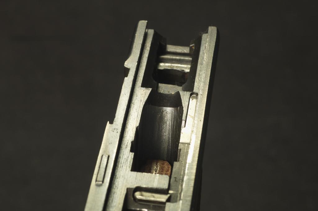

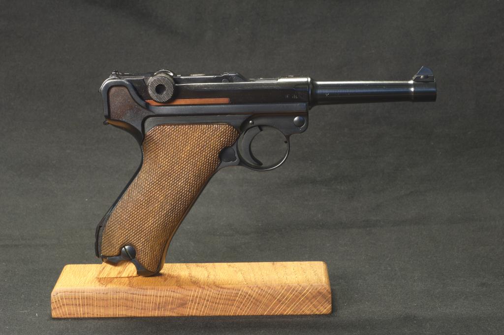

Default New Photos Mauser 42 Banner 715g

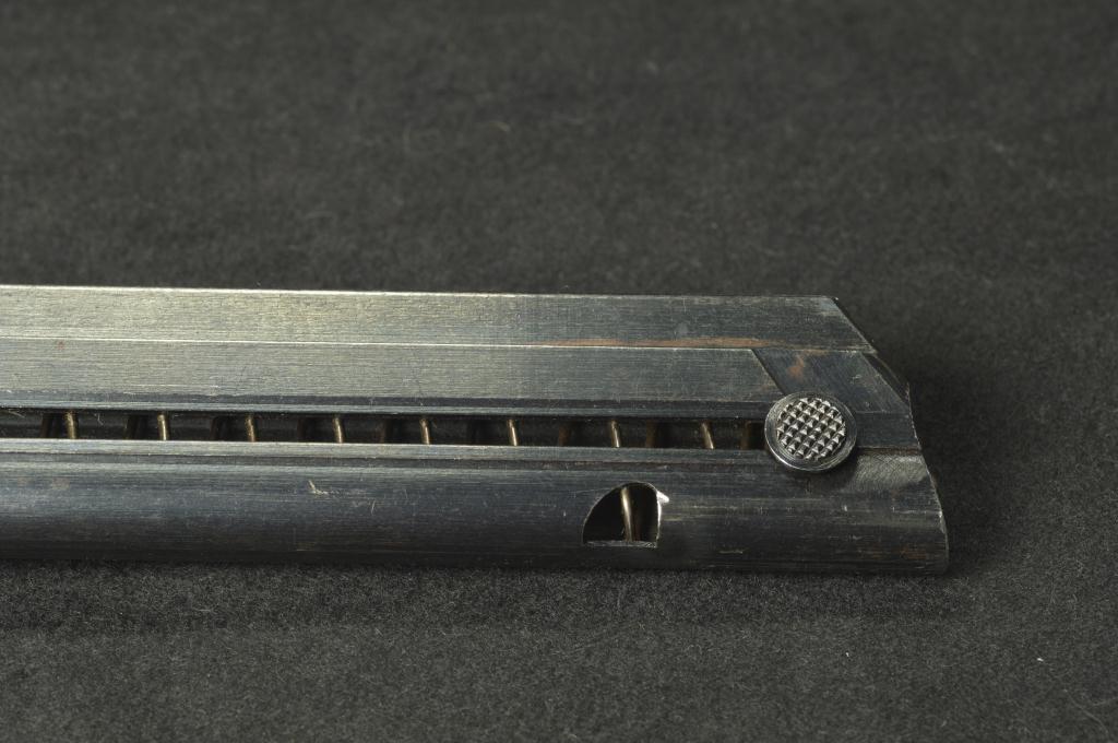

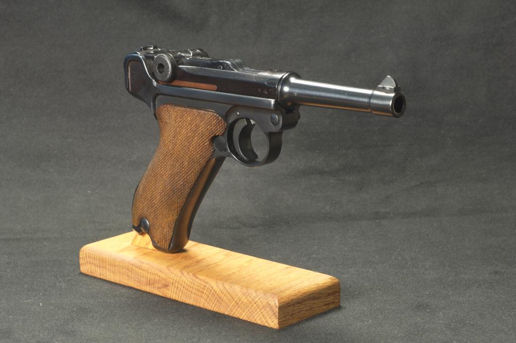

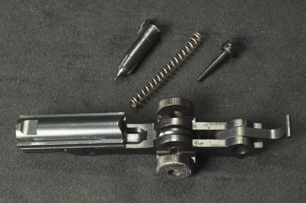

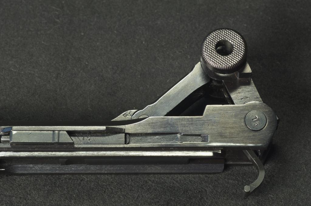

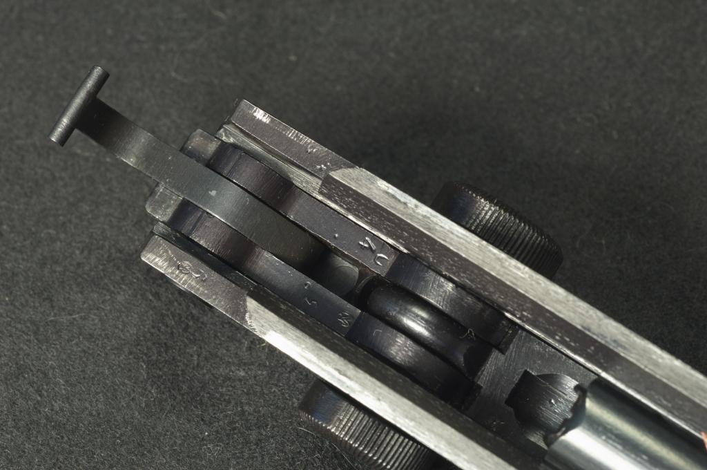

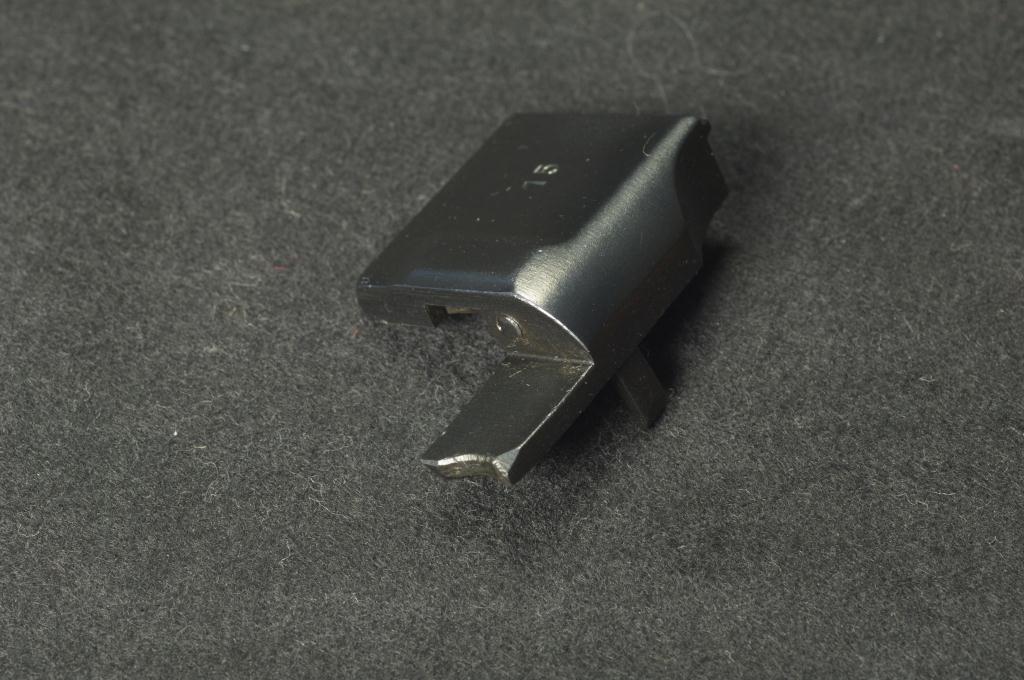

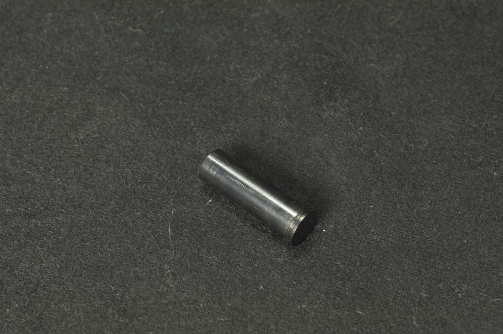

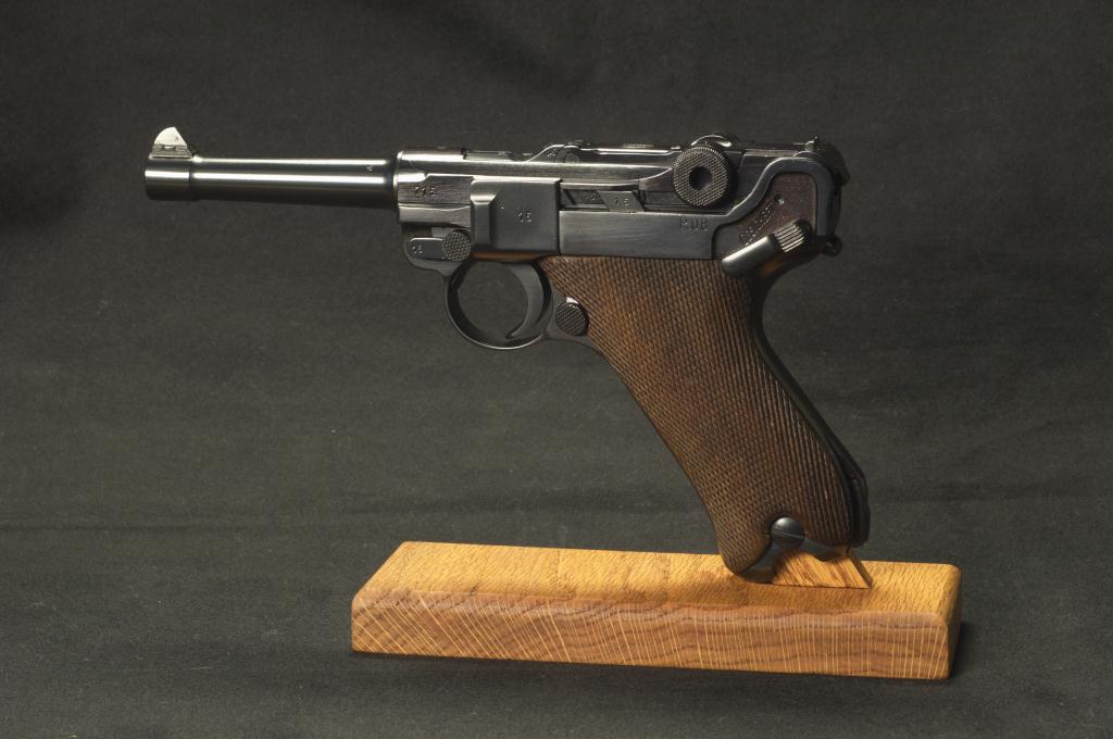

Hi, I'm attaching several new photos of Mauser "42" Banner 715g...
In fact, there are several small parts that should be in the white that are blued on this Luger. Including... Firing pin; firing pin spring guide; trigger plate pin; safety sear block bar; toggle recoil link; it's pin...
I've tried to light this so that the metal's grain is visible, and tried to give a good rendition of the actual finish condition. These are not retouched, and were photographed using indirect soft daylight balanced florescent lights used for video production.
I've got higher resolution photos (4x) should more detail be needed.

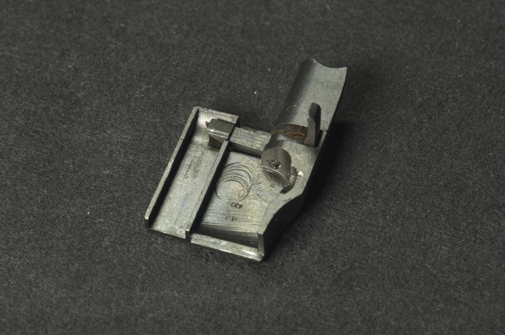

Default Additional Photos 715g
Additional Photos...

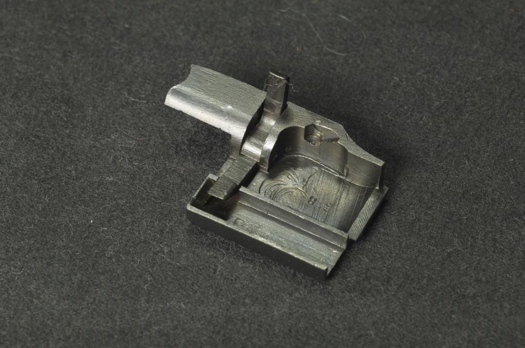

More...

Hi Marc, It looks good to me. I think it was assembled from parts anytime between 1942 and the end of hostilities, and that all the components were thrown in the bluing tank, regardless. Remember, Mauser was still assembling Lugers from parts after the war, when the factory was under French control. Regards, Norm
P.S. Nice photos.

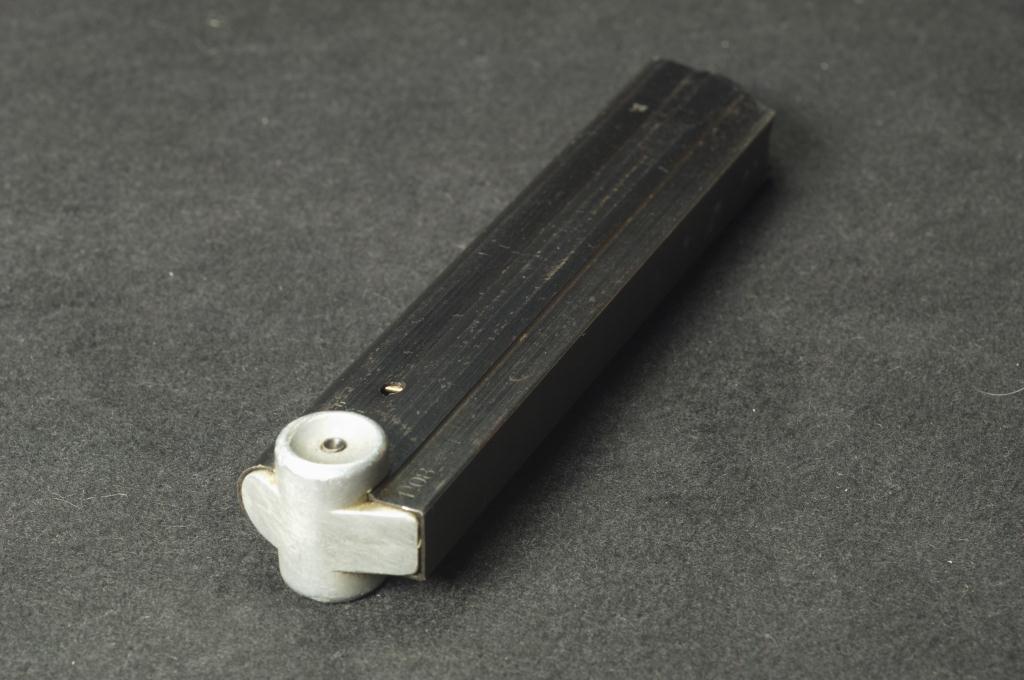

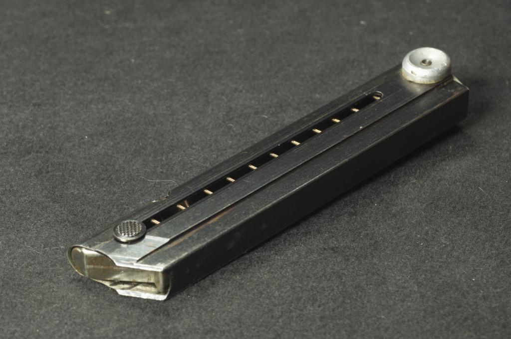

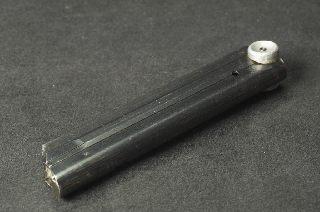

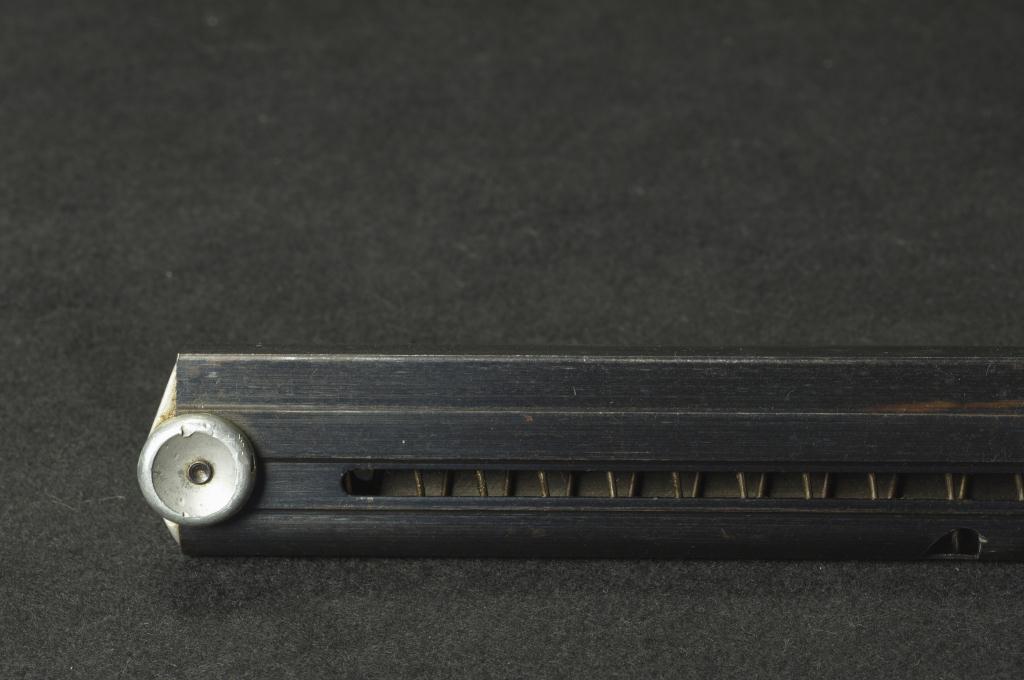

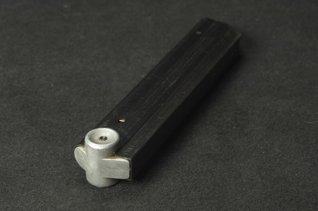

Default More and Magazine
A few more...

Alvin, The rust blued Mauser Lugers have the front of the muzzle in the white, but they were blued on these salt blued pistols...
Norm, the combination of high condition, proper number die stamps, out of sequence toggle train and odd bluing made me wonder if it could have been one of those done late war (after Mauser conversion to the P-38) or when in French control. Also possibly one of those "made" for returning GIs at Oberndorf. That could also explain why someone wanted to "improve" the appearance of new parts.
I'll certainly be on the lookout for any background on this period.

Marc, I don't have Mauser Luger in my collection, no hand-on experience on it.
I just looked up Don's book "Mauser Parabellums 1930-1946", page 335 shows a commercial pistol, chamber date 42, s/n 8267y, it has white muzzle.

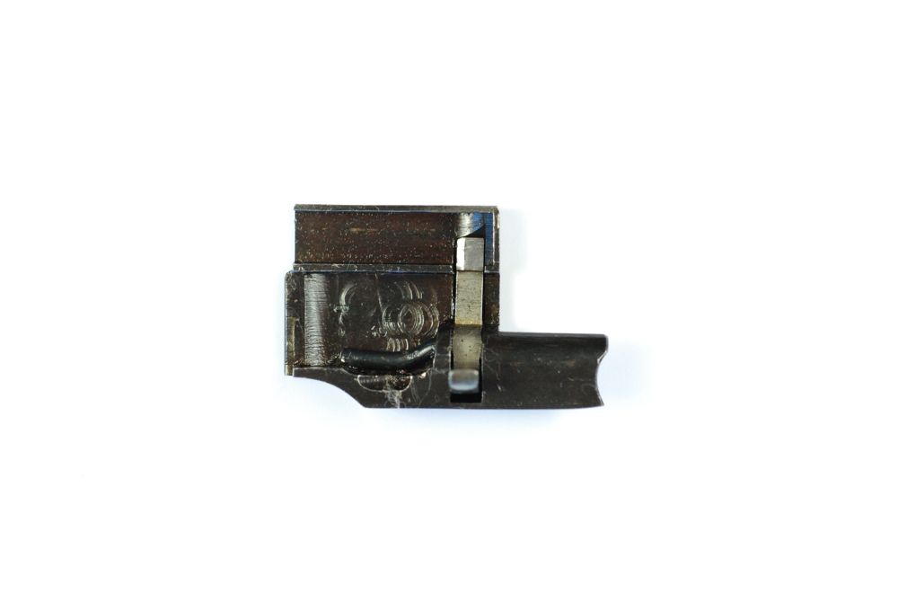

Old 03-20-2012, 05:38 PM   #10
Oops... Alvin, I stand corrected. I'm away from my books, but checked my 1938, and the muzzle is in the white.
So, that's likely conclusive that the cannon was completely re-blued.
Upon inspection, looks like the trigger plate pin was broken off at some point. The broken off area of the pin is also blued, so the entire part got salt blued as a unit.
This lends more credence to end of war or post war finishing and assembly, since I doubt that the WaAmt would have accepted one with a broken pin.
So... probably post war, new parts, originally blued or re-blued to improve appearance for commercial sale. Note done under French control. Probably done before commercial nitro proofing was re-established after WW-II in West Germany. Brought into the USA before 1968.

Old 03-20-2012, 08:20 PM   #13
Hi Bob, I wasn't suggesting that this gun was made under French control. Those guns,as you said, had a five pointed star preceding the serial number. I carefully said "up to the end of hostilities". I think this gun was assembled for commercial sale after all military contracts had been filled. Regards, Norm

Side plate is correctly numbered - inside and out. The inside of the sideplate on WWII Mausers is one number higher than the first two numbers of the S/N - in this case one higher than the first number as it is a three-digit S/N. So "8" would be correct for the inside. As for authenticity, I can't say - only numbered correctly.

I have Mauser Banner dated 42 and serial 8300y, a fully matching and commercially proofed gun that I believe was assembled at Mauser before the end of the war with what ever parts were on hand. My gun also has some blued small parts that are normally in the white, muzzle, sideplate lever etc. I also see some almost matte areas but not as much as the subject gun. I see no sign of reblue on my gun either. Except as mentioned by others, I do believe some of the parts were re-blued by Mauser at Mauser before May 1945. Some of the stated opinions are trying to apply pre-war and mid-war rules to these late war commercial guns. In the late period the rules and practices were not so strict especially on commercial guns.

In the last pic by the cartridge ejection port...is that pin not supposed to be silverish white? If it is blued...then not normal? I think that is what mrerick was saying...Also shouldnt there be some aging on the bluing? Or is there a recorded versions...that show this correct? Just trying to increase my knowledge. It sure does look good...could this be a DDR or Berliner Polizei redo with out stampings?

A very nice Luger, but I'm with Alanint....there's subtle signs of refinish....the" borders" around the frame ears are "soft"....the biggest giveaway I see is the middle toggle piece.... look how sharp the bevel is on the back half of it, and how its smeared and rounded further forward.
