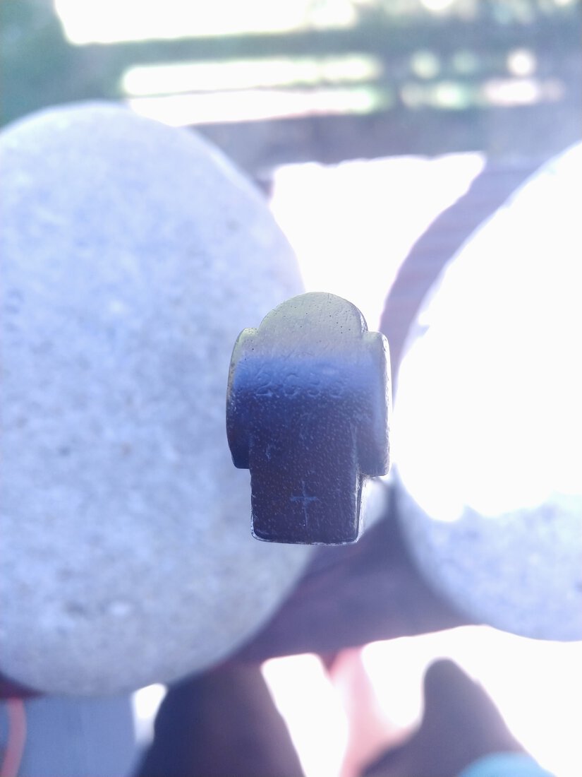

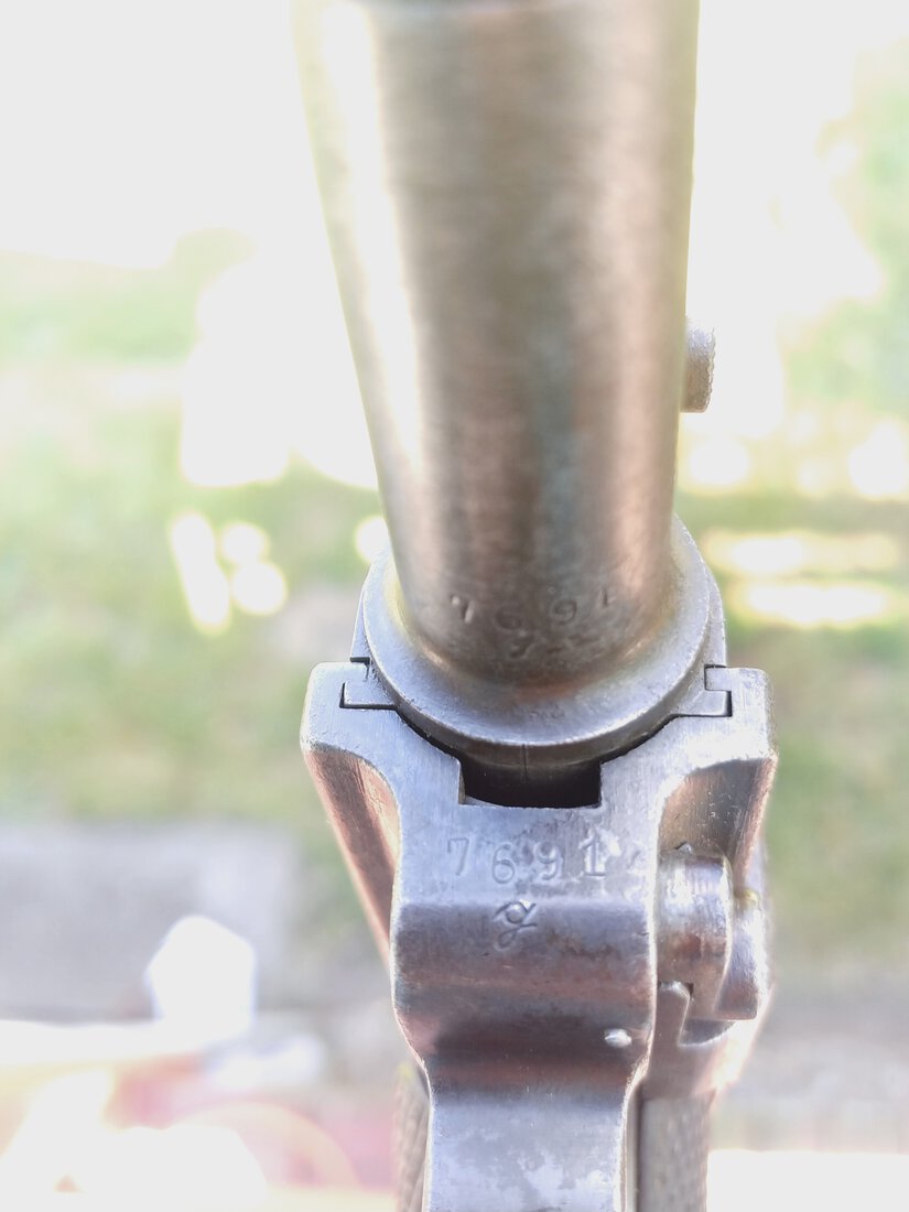

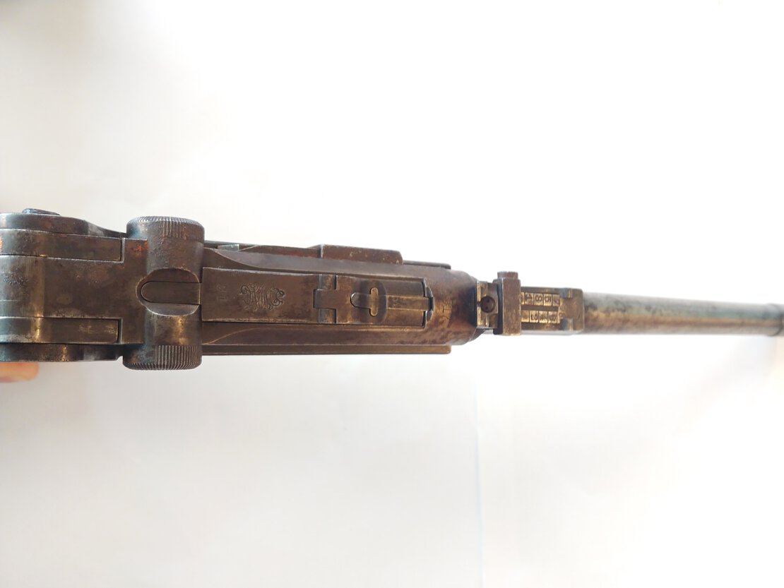

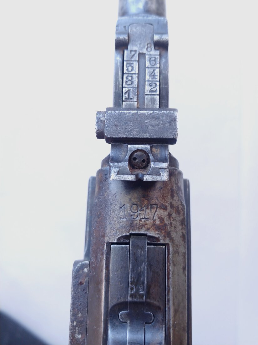

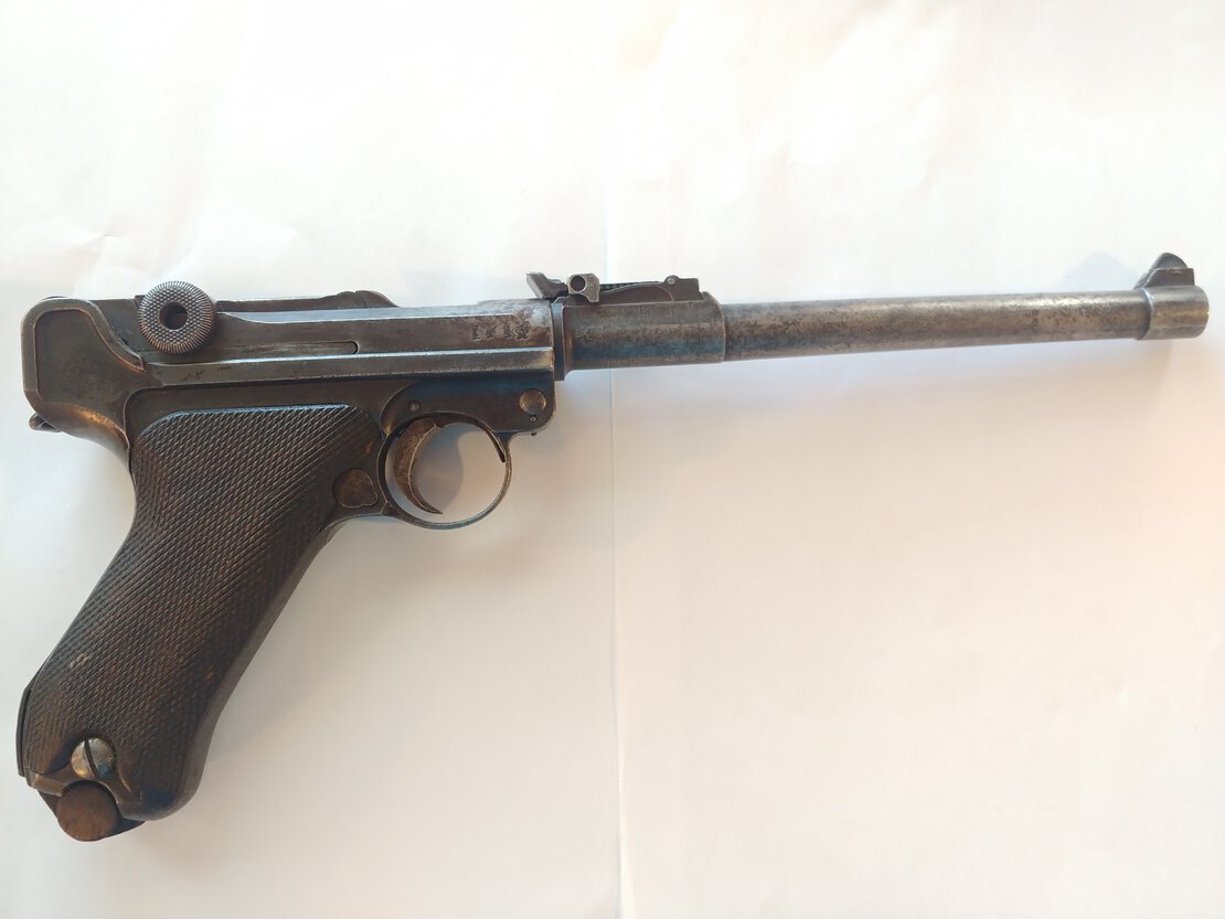

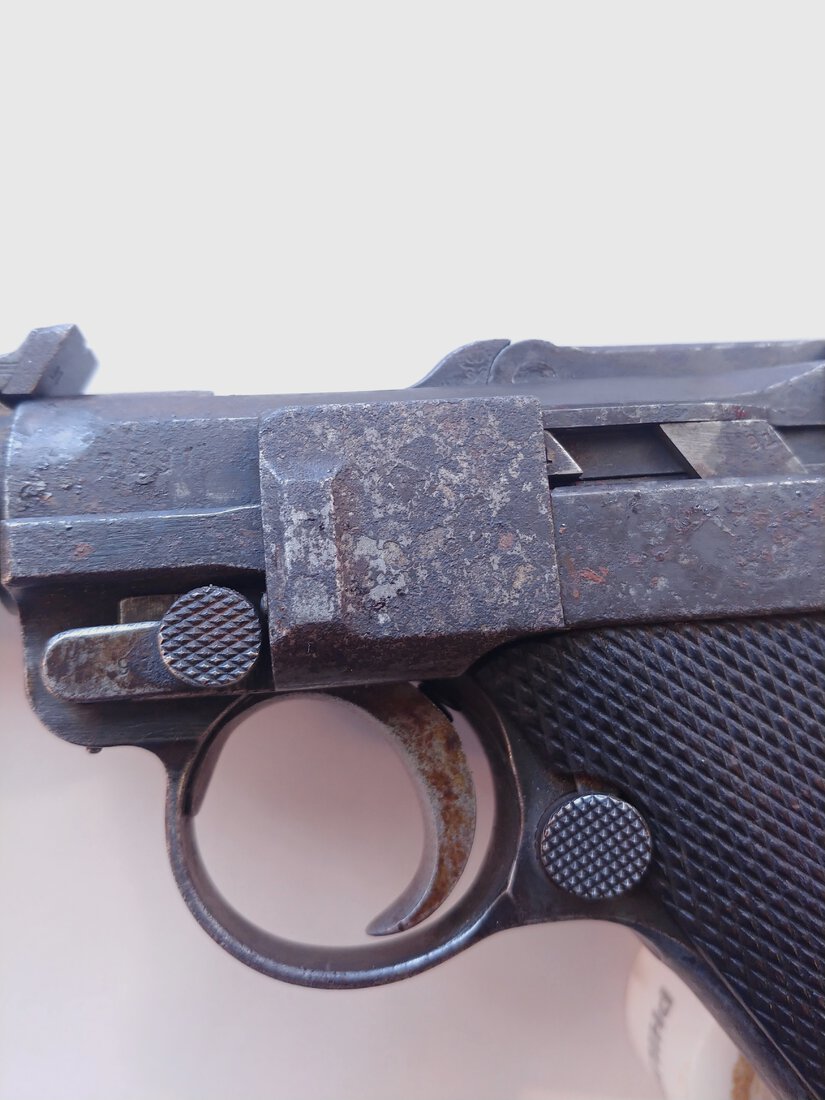

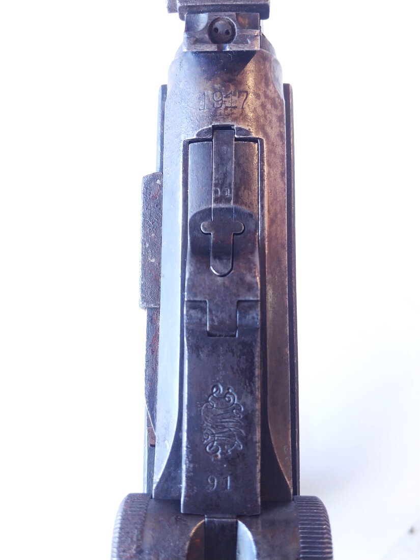

Hello all, I was recently left this Luger by a relative. I am completely new to owning a Luger and was hoping to get a better idea of what I have here. I'm fairly certain that this is an Artillery Luger, so I hope I'm posting in the right forum.
It is a little worse for wear, especially on the left side, but I hope these pictures are what you're looking for when trying to I.D. Let me know if I can provide any more information.

It's a 1917 DWM LP.08, pretty much what you thought.
That was a year of very high production, because WW-1 was going on.
The barrel is numbered to the frame, which is a good thing.
The finish is in poor condition, with a lot of pitting and corrosion.
The serial number on the left side of the receiver is almost obscured.
I don't see any serial number ("91") on the side plate.
The grips appear to be in good condition. They may be numbered to the gun.
(Be careful removing the grips. Push out the right one first from the empty magazine well. Then the left one.)
I can't make out small part numbers that should be on the side plate and other parts.
The middle toggle has the correct number "91", but the ejector looks like it's numbered "04".
You will want to remove the receiver and look at the firing pin and hold-open for partial serial numbers, too (ie "91").
There is about 20% of the straw color remaining on the trigger, safety lever and takedown.
A lot of lugers look this way after being stored in poor conditions (water or even salt water), particularly on one side.
Hopefully water didn't damage the inside of the barrel.
The magazine looks like the right type, wrapped metal with wood bottom.

And I'm looking for partial serial numbers of "91" hopefully on all parts. Is the middle toggle the part that also has the DWM stamp? My picture might not show it well, but the partial serial number on the top of the gun between the 1917 and DWM stamps is "91". The "9" is very faint. Is that the ejector? I'm scouring for any partial of "04" but I cant find it.

remove the right grip first, using your finger from inside of the magazine well.
Then carefully remove the left one. Be careful not to crack or chip it near the safety lever.
Glad to hear the small part is numbered "91" and just doesn't show up well in the photo.
That happens a lot.
While the grips are off, you can go over the entire gun with a light gun oil. That should be enough to clean off any left over gum, grease or old oil.
BALLISTOL is an excellent cleaning and preservative product that works well for the pistol and grips.
If you are only going to own one Luger, this would be the model to have.
It is iconic and was only produced for a few years before an during WW-1.
The finish is nearly gone, but having all matching parts is much more important.
This is the same make and model luger that I first bought for my own small collection.
