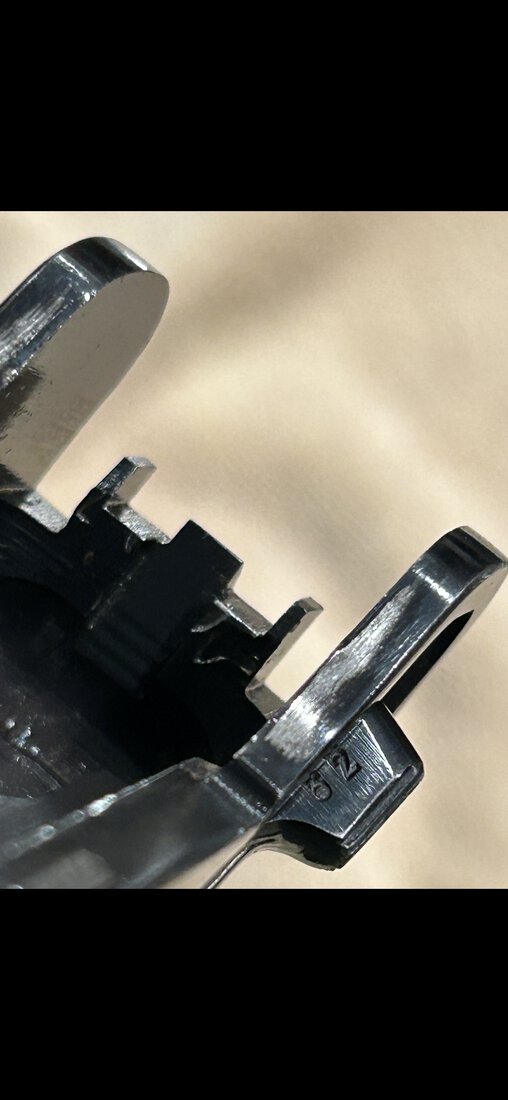

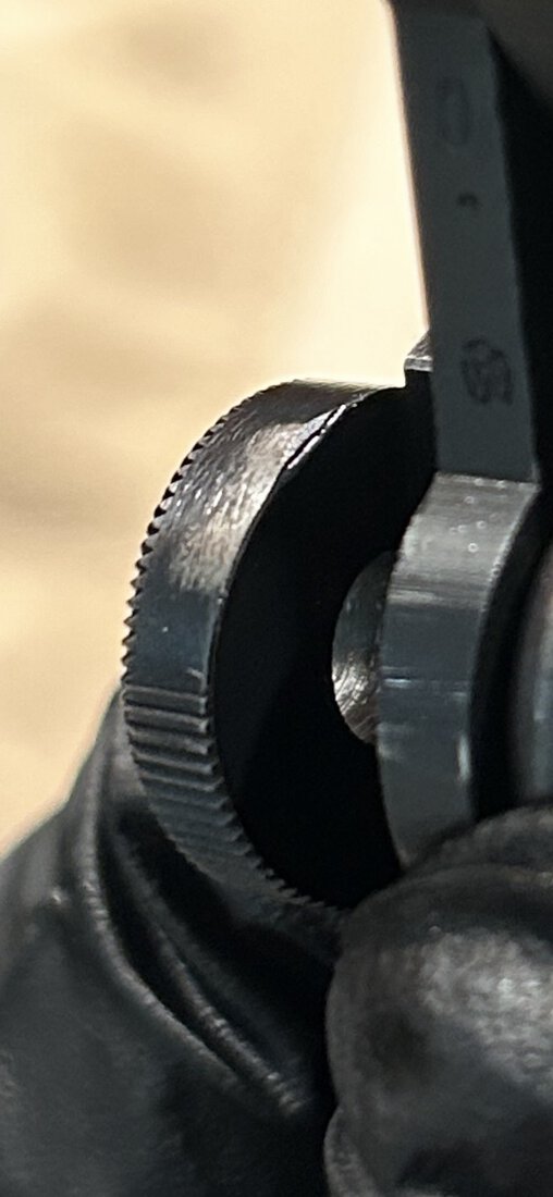

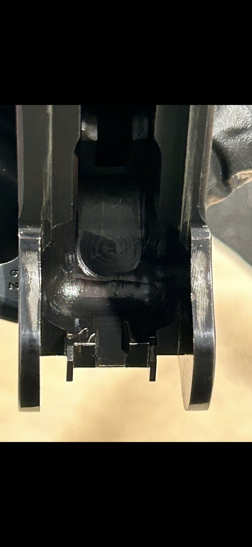

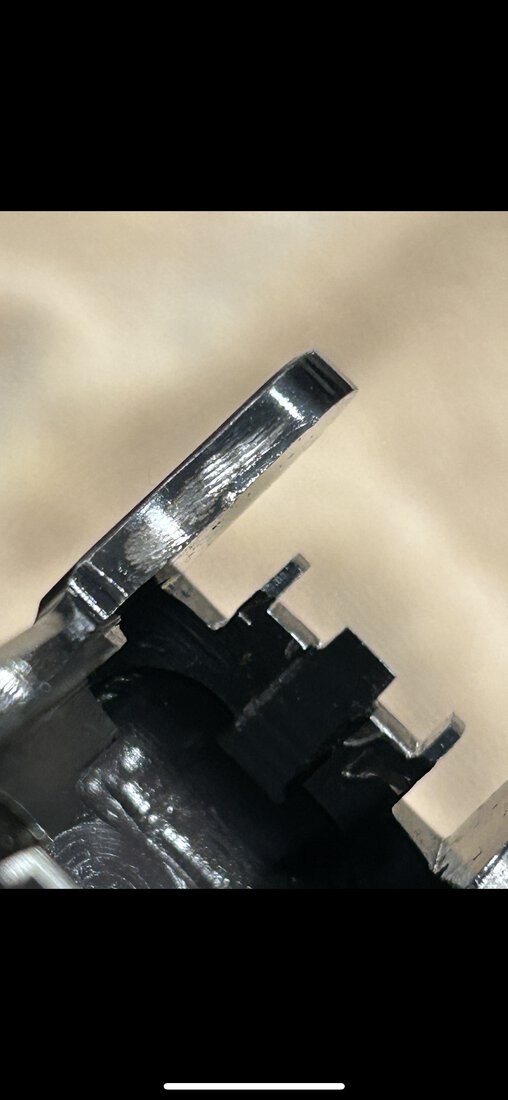

I just bought my first Luger (1939 Mauser S/42) cleaned and oiled it, and fired 1 magazine of regular WWB 115 grain. It functioned perfectly however upon inspecting it when I got home, I noticed some peening on the toggle knob and frame rails. There are also some scratches on the inside back of the frame. I honestly can’t remember if the peening was on the gun when I bought it because I needed a magnifying glass to spot it, but I do remember the finish was already worn in those spots.
I am thinking that somebody fired some hot +P or subgun ammo through it at some point. I only go shooting once a year so the pistol will most likely be a safe queen but my question is…do you think the peening will cause issues if it is ever fired again?

I can't imagine how these points could not be "peened". The toggle knobs striking the rear frame ramps is what makes a toggle action work. I think you can go ahead and fire the bejeebers out of it.

Those are the common wear points on a P08. All of mine have the same bright spots.

Thanks for the replies. I was mostly concerned about the dents on the edges of the knobs and ramp and how it related to function. I assume the smoother the surfaces the better. Anyways, if you say it is normal wear and tear then that is all that I needed to hear.

I usually throw a little grease on the shiny spots, it probably cuts down on the wear and tear, and stays put better than oil.

The wear doesn't look particularly extensive. Doug's tip about lubricating the interface certainly can't hurt.
Talk about peening! I had a 90s Stainless Luger for a while. When it arrived, there was enough metal displaced in the same area to present a "lip" that had been upset towards the inside of the frame. A few licks of a file took it back down to flush.
