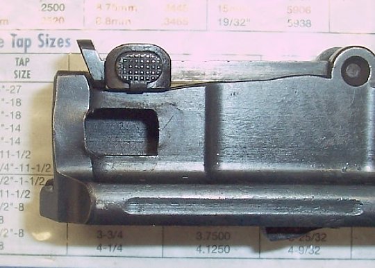

Here is an example of why you don't want to shoot Tokarev ammunition in a C96...
That bent piece of steel is the only thing separating the bolt from the back of your head...

You’re welcome to your opinion concerning what causes that kind of damage, and I don’t have to share your opinion to respect it.
That said, in my opinion the example of a deformed barrel extension is more likely caused by a worn out or improper main spring than it is related to ammunition.

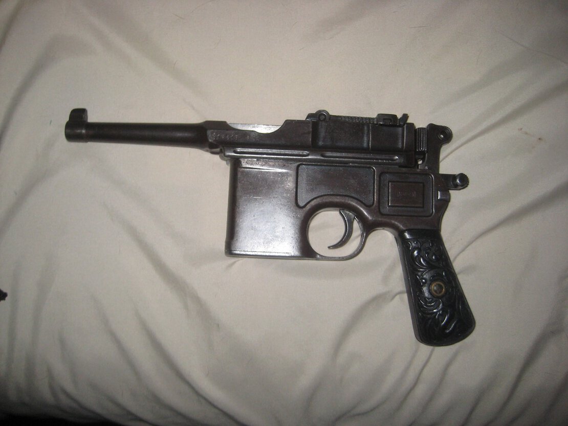

Here is another deformed C96 barrel extension:
This is a Chinese Hanyang (in Hupeh province southeast of Shanghai) produced C96, I believe produced in 1926.
Kyrie is offline   Reply With Quote
In one of the C 96 books I have I remember a comment about inferior / softer steel in the Chinese made models. They did mention a factory if I remember correctly.

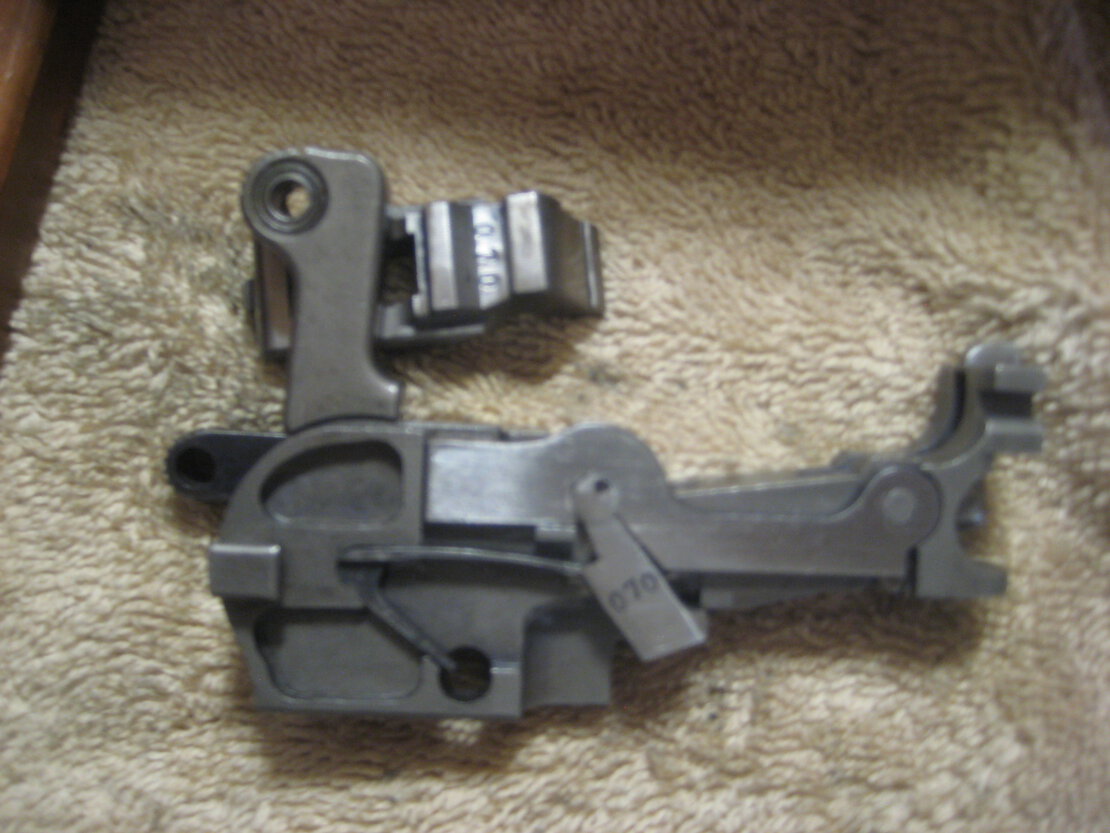

Picked this up the other day...the barrel/extension does not match the frame by about 3700 pistols but is tight to the frame. The internals don't match either but are 'tight' and it has been converted to 9mm by a nice sleeve that has great rifling. There is a slight dimple at the bolt stop but I suspect because the springs were not changed out.... I do not fear for my life.
It shoots well and cycles well (after I changed all of the springs and the bolt stop for new) but was piercing primers...
Took a while to get a balance between the new springs and that firing pin. I shortened the FP tip and rounded it (numerous times) ...took a few coils off of both the firing pin return spring and the trigger spring (both very stout) and finally got there.
You can't go too soft on the hammer spring as that also helps retard the bolt upon firing/cycling....there is a fine balance there between the bolt return spring/hammer spring/firing pin return spring.
That took a lot of re do's and went thru a box of Blazer Brass 115 9mm (which is a lot less stress than the original 7.63x25) on the 100 year old booger. Regardless, that is half of the fun.... I have Lugerman refurbing a 9mm Broomhandle so this will do for furn.
The internal mechanism is simply amazing in its complexity and design...the Federle brothers were genius.
It does have a nice dimple but I do not fear for my life and will shoot it, have shot it....the dimple (not as pronounced as the pics in this thread) is due, imo, to not balancing the 3 primary springs...hammer, recoil/reset, and firing pin.
If you shoot this system with a weak hammer or recoil/return spring you will send more impact to the bolt stop than was initially planned.... regardless of ammo. I think many focus only on the recoil / reset to battery spring and ignore the hammer spring that also acts in retardation of bolt recoil. If these two are balanced you will have no issue with the bolt stop absorbing more than it was designed to.

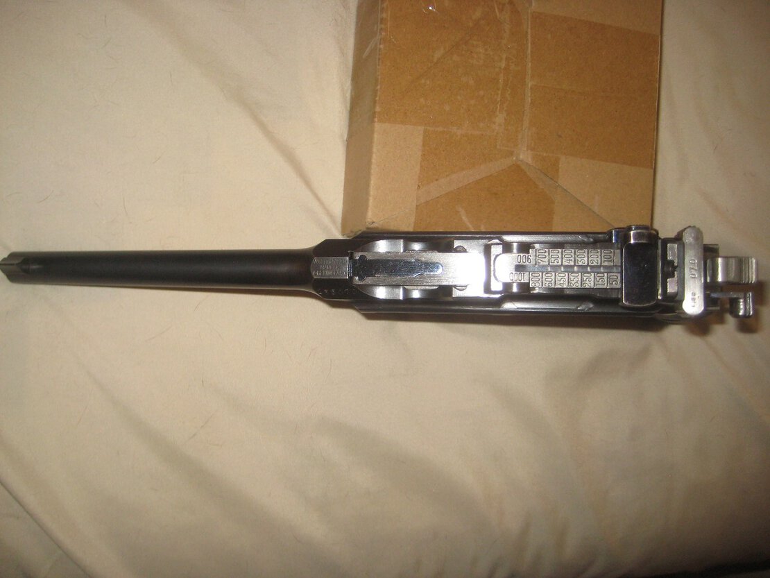

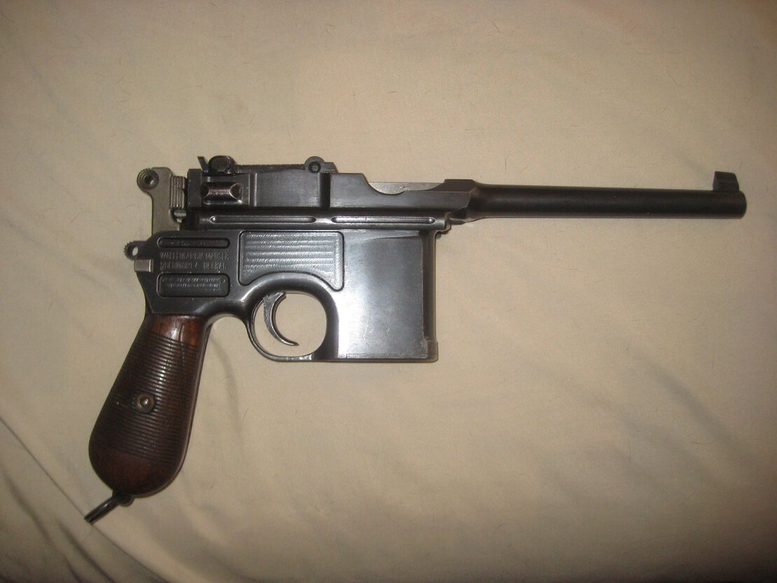

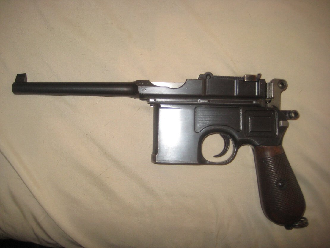

Looking for reload data (yours or source) for the 7.63x25 .....I have a bunch of accurate #2 and #7 so hope someone has that. Want to load mild rounds and will replace the bolt stop with new for that.
Got this today and just very pleased...got it from Simpsons, not cheap but you know what you are getting. Chatted with Leroy about this pistol and he went over it with me and answered my query's....
1911/1915 year group (too bad the records were destroyed in WW2) and in amazing condition. The bore is very good plus...excellent in my eval. Everything on this C 96 is tight as a drum and the only spring I changed out was the firing pin. The others were more robust than the Wolf spring new ones.
All numbers match to include the grips. 98% original blue. There are no import markings. The only non original piece is the lanyard ring that was removed at some point...replaced with a key ring lol.
Whoever had this stored it and rarely shot the piece. I will shoot it after making some milder reloads and will use a replacement bolt stop (new) when I do.
I will have to go with .308 as the bore is so unused...I tried the muzzle depth with both 86 gn .308 and the XTP .309 and the .308 is just right.

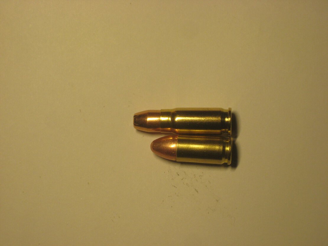

Forgot the pics. The XTP round and a 9mm for comparison.
