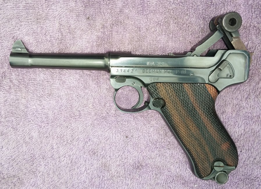

Beeman P-08 .22lr (KGP 69) and my project, the "Ermarican Eagle," a KGP 68A in .380 The grips on the latter are factory originals, but modified to extend their pattern to the edges.
Ithacaartist - how does the KGP-68A shoot?
Meh. Seems to have lots of felt recoil. They're dinky, about 66% scale of a real Luger. The .380s can break front toggle links and crack their cast ZAMAK frames along the frame rail up front. All KGP series pistols can potentially throw their extractor systems into the stratosphere.
Not that they're not very cute and sorta fun to shoot... I basically have an example of most of their variations, sell parts for Erma's toggle pistols, and have wound up with opinions and procedures to get them running.
They're realizing higher prices on Gunbroker now than when I bought the ones I have. Penny auctions seem to get the best bidding on them. And any of them is more scarce/rare than a Luger!
