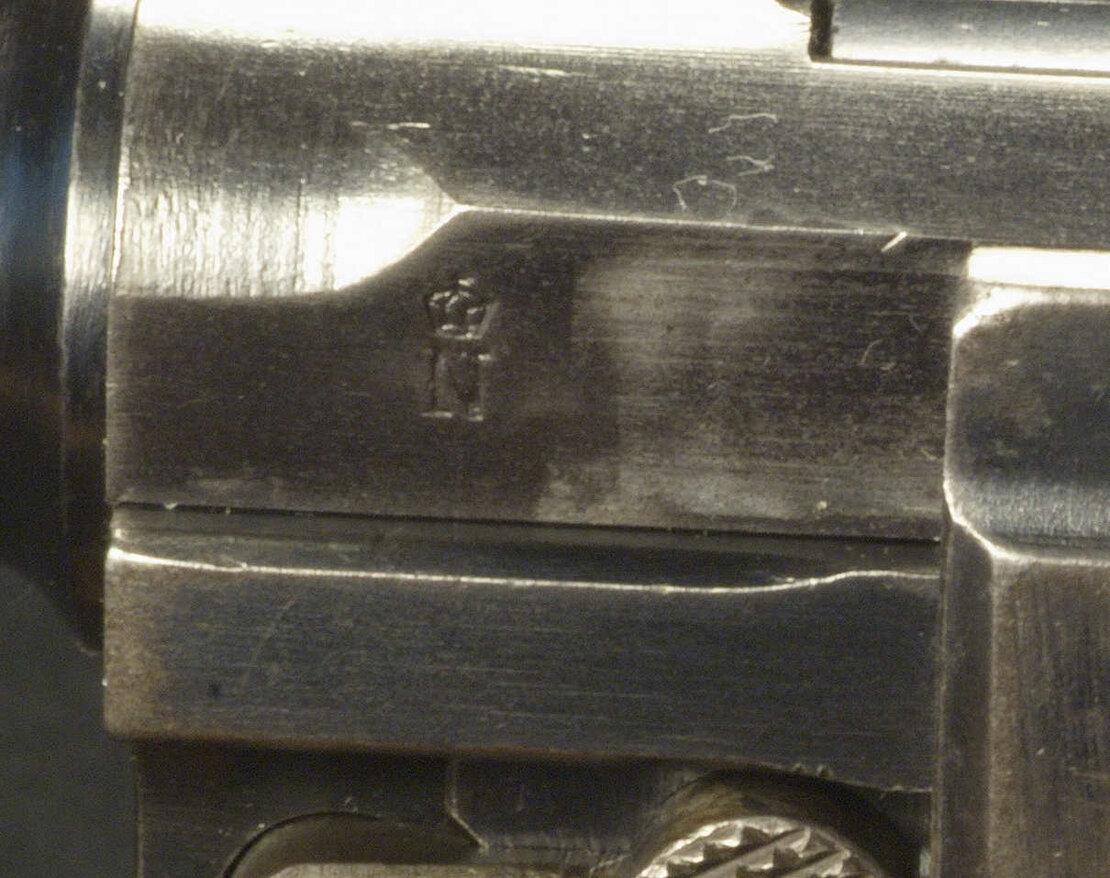

Serial number: DWM Alphabet Commercial 7053m
GERMANY haloed
Standard commercial model
Proof stamp: Crown/N
