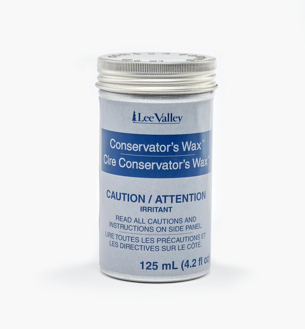

I use museum wax as well from Lee Valley Tool ... same as Renaissance but 2x's the volume @ 1/2 the cost.
And NO ... I don't work for Lee, it's just one of my favorite stores. https://www.leevalley.com/en-ca
