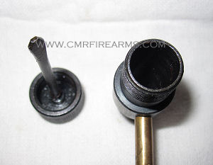

Default This Early Makes Sense
It hold the oil and pointed tool! 1906 French Contract~
Old 07-28-2021, 06:17 PM   #11
Is it actually a 'tool' or just a dauber???
Old 07-31-2021, 03:01 AM   #12
Doubs
Doubs's Avatar
Location: Byron, Georgia
Posts: 1,744
Thanks: 828
Thanked 1,794 Times in 592 Posts
It's identical to the cleaning rod/oiler issued with the model 1906 Portuguese Lugers.
Old 07-31-2021, 12:49 PM   #13
What does the 'tool' (inside the oil bottle) look like it is intended to do??? Eric's pic isn't clear...
Old 07-31-2021, 04:32 PM   #14
Doubs
Doubs's Avatar
Posts: 1,744
Thanks: 828
It's as if the post was made into a diamond shape but the point blunted. I'm sure it was designed to pick up oil and deposit it precisely.
I gave the entire rig to my youngest son as a present. I've since replaced the pistol with one not quite as nice but still better than the average Portuguese.
Old 07-31-2021, 10:20 PM   #15
Makes it easy to put just a drop of oil in a certain spot.
Hence the term 'dauber'.
It looks like (to me, from Eric's pic) a thick blunt screwdriver shape. I know the grips use slotted screws, but the firing pin spring guide uses a slot too. No one else has given an opinion besides oil dauber so I'll go back to downloading pr0n and shut up...
