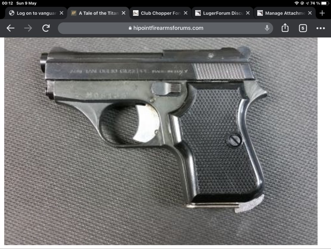

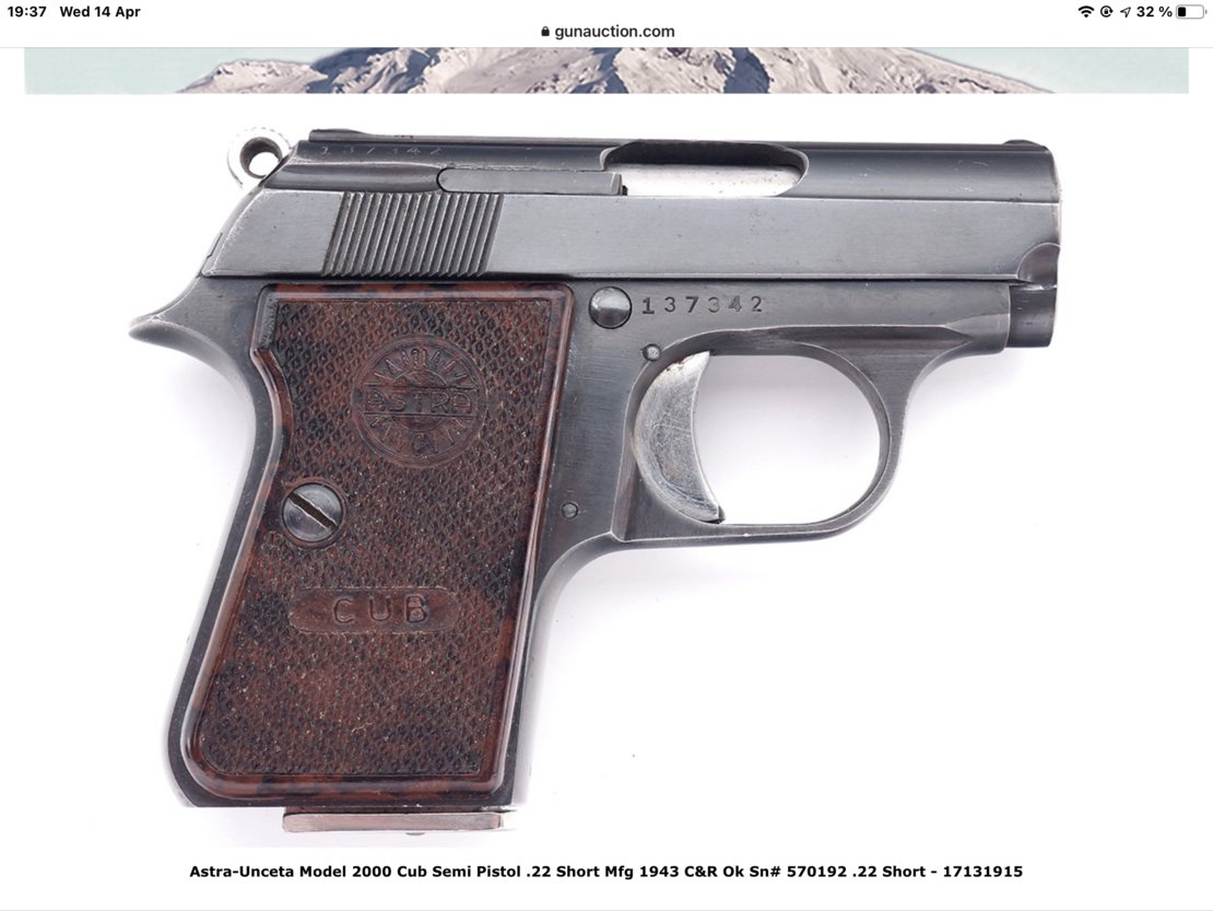

Hi guys. I have bee very interested in guns engineering /mechanisms.
Just recently I discovered a tiny semiautomatic pistol which uses puny .22 shorts and seems to be doing it very reliably. Altogether
30 parts+magazine. Simple blowback. Perhaps only Makarov is simpler... or an open bolt gun( I, aware of some Argentinian handguns. )
I found it in a local gun shop , $200. Seems in fair shape, operational. Don,t know if this is a decent price, But I could not resist.
I,m waiting for NICS.

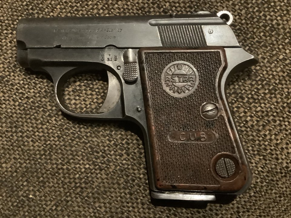

Finally cleared paperwork and brought the gun home. It,s NJ!!!
Disassembled completely, cleaned, reassembled, oiled.
The gun works very well. I,m impressed.
Shame that this rimfire has no bolt hold open on the last round.
Not an issue.
Took example from .22 Erma Luger conversion kit,s magazine and made a new follower for my Astra cub.
Now I have this function.
Here are the pictures of my actual gun, I,m impressed with the machine work of it, seems like hand fit job, tight tolerances. Many parts numbered , I guess for the same reason as Luger,s.
All Steel, heavy for it,s size.

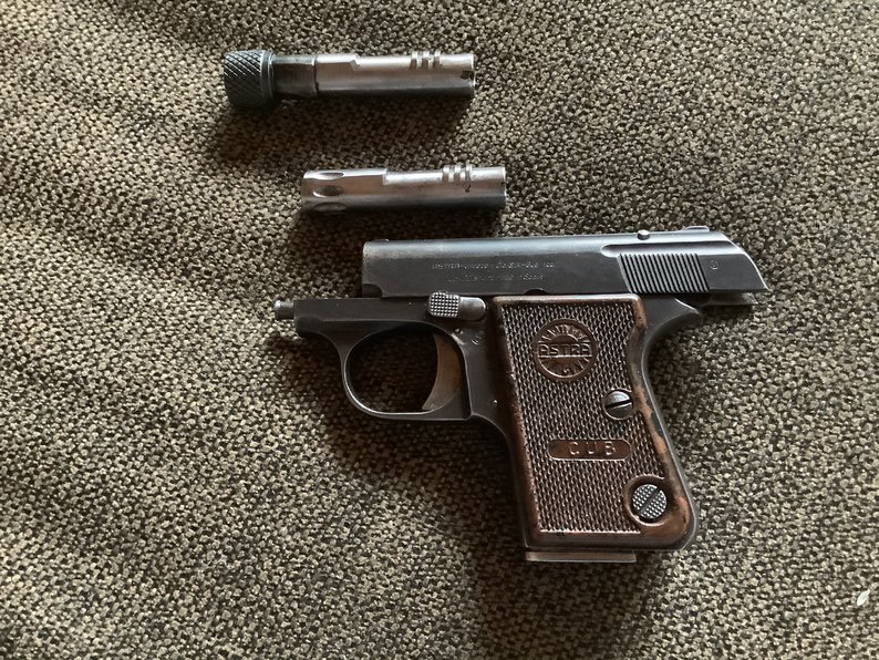

Originally Posted by tomaustin View Post
is the cub threaded for that barrel ?
Are you asking if the barrel has threads for an attachment?
I could not find a threaded barrel,
but I bought an extra barrel, rounded the front ~1/2 of the length and threaded it 3/8-24 for the extension below...
Once receive it this week, will add, machine to fit the profile of the slide opening and install.

Well, this is how it came out- an extra barrel with the threaded extension. Everything has lined up good.
Now my little Astra looks like.... mini Stechkin...
