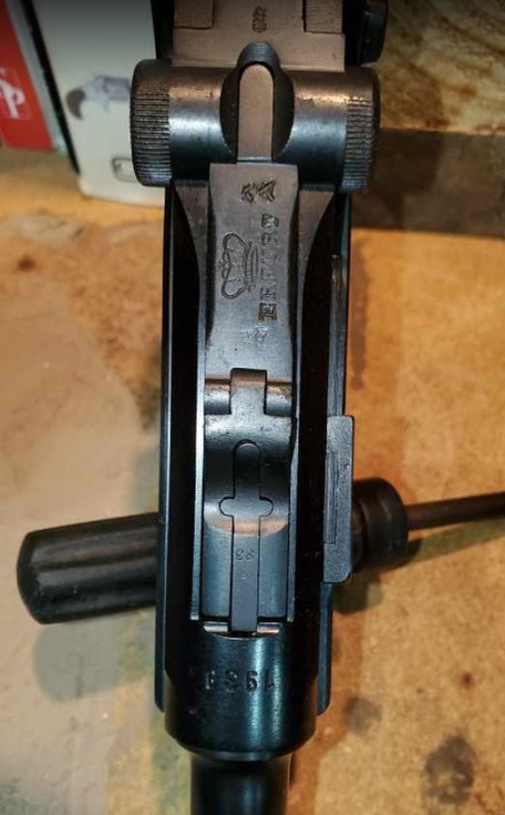

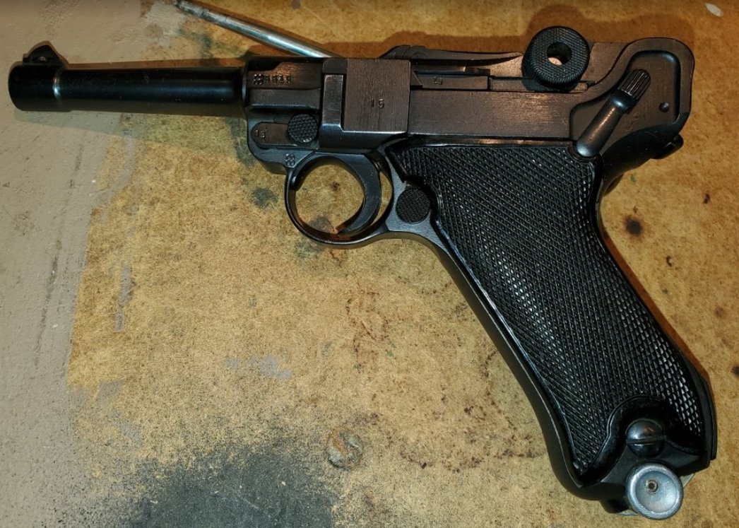

Hi,
Hope all is well. I've been a member of the forum for a while, but haven't been on in quite some time. Hoping now to avail myself of the expertise here.
I've come across a Luger that I'm having a hard time identifying because the parts seem to be a mishmash a bit. He is asking a little over $1000. I just wanted to get an opinion, on a number of things if possible. Yes, I will be inspecting it; he just lives 2 hours away so I wanted to have an idea before I go up and actually see it. He is confidant and is willing to let me shoot a mag or two before purchase.
Just so we're clear, I've tried iding it using "The Standard Catalog of Luger", by Aarron Price, 2006 edition (ISBN 13: 978-0-89689-411-2)
Seller says 1938 Erfurt Luger and that by all accounts, he is the 3rd owner (He is in his 70s, got it from a friend also in their 70s who got it in Germany from an older German gentlemen). The manual says Erfurt stopped making them in 1918 and was involved in the reworks [consider the double date Lugers], but there is no indication that it was necessarily reworked by Erfurt or anyone else.
Is there a reason that the bolt block/extractor would be replaced with one 20 years older?
Opinions on general appearance?

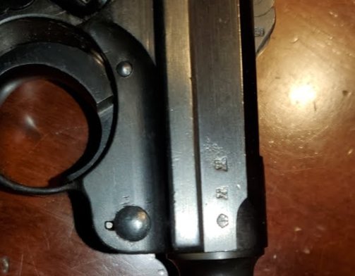

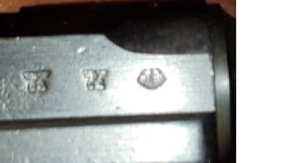

Next, I'm having trouble with the proof marks and I'm hoping that someone out there can ID them. Center looks like E/63, and right looks like the Nazi mid-acceptance mark (signifiying '37-'39 make) but I'm not experienced enough to say. Any suggestions? What would the one on the left be and is there a reason it would be a 2nd E/63?
Bakelite grips are indicative of a Black Widow, but the other markers for a BW don't seem to be there. Grip replacement?
The price may very well be fine, or it may be too high, so I'm open to input. My concern is just identifying this. I'm thinking a 1938 Mauser Police issue, but I'm too new to be that specific or confident.
Any suggestions from the experts?

It's a mismatched 1938 Mauser.

The double straight eagle/63 and mid era Nazi proofs marks are correct for a 1938 Luger.
The Erfurt toggle is an add on/repair and off a much older Luger.
The grips are not from this 1938 gun and may be from a BW, which this gun is not.
As long as it all works it could be a good shooter but make sure you check the bore and have a good look around for cracks anywhere on the gun before firing.

I was wondering about the toggle condition and left side panel. It has a sort of pitted / overly worn appearance. Would that concern you if you were looking for a shooter grade?
No ... it would not bother me and since its a shooter the pitting is easily fixed if it bothers you that much

I see a stamp adjacent to the canon serial number and on the frame below the takedown lever - looks like four touching circles forming a square. Are the grips "black widow" grips or are they VOPO grips? Could the stamp be an East German mark? Looks like the Erfurt toggle link has the serial number X'ed out. Could this be a VOPO Luger?

It's a Vopo, but the grips are not the typical East-German ones.
The side plate is East German new manufacture.
Check if the barrel is crown/N proofed at the bottom.
I never even checked to see if it was a VOPO. As far as the grips go, I'm not certain which grips they are. I'm going to check.
I texted back and forth a bit with him today...he said he has not one but two matching magazines. Serialed and they are a matched set. We'll see. They're period correct, with aluminum bases and he indicated they are stamped the same way.
I'm curious about how one knows that the side plate is new, East German manufacture?
I also noticed the little dots forming a square on the frame and upper receiver. I didn't see anything about that in my manual, so does anyone have any idea on that?

The little dots are peened out East-German markings. They were removed after import in order to disguise the fact the guns were imported from a prohibited source at the time.
Interarms imported several batches, paid for in US currency that was much needed by East-Germany at the time. The guns were basically smuggled across the iron curtain in the 1970s.
