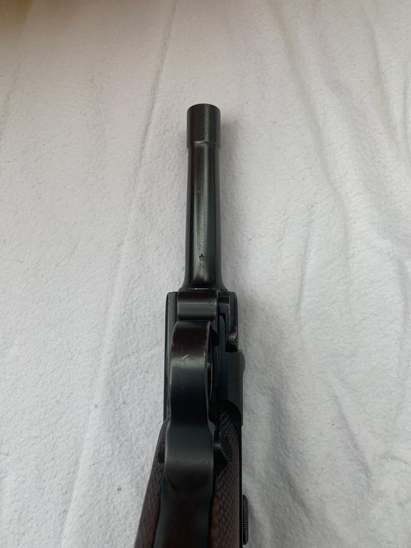

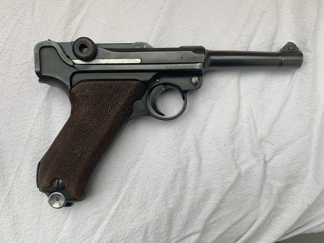

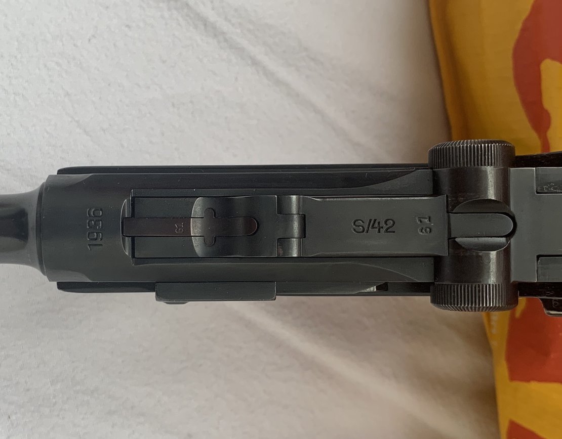

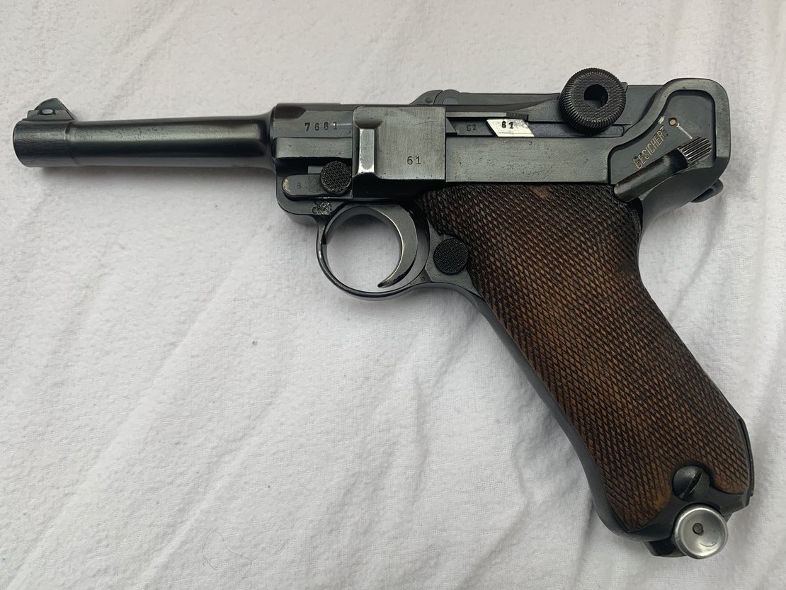

Hello to all
This is my first post regarding my Deactivated 1936 Mauser Luger
I guess my main question would be is it an authentic Luger ?, although I guess the fact that it is now incapable of being used does take away authenticity. But you know what I mean
I think the barrel has been replaced as in a certain light it looks slightly different to the receiver and there is a crown above an N
Which I think makes it a commercial barrel ? . I guess it could have gone back to have a repair / refurb and due to war time pressure it was fitted with what was at hand ?
Also the magazine is stamped with 2/1001 which I read somewhere might make it a East German post war refurb ?
To sum up :
Is it a nice example of a ww2 era Luger that may have seen action ?
Is it a later magazine that has had the serial number put on to match?
Also strange stamping below take down leaver ?
Finally , a lack of straw parts for a 1936 example?
Any and all opinions appreciated
Best Wishes
Martin 2

It was a DDR refurbishe VoPo before it was deactivated. Looks like someone switched the bakelite VoPo grips for wooden examples.
The crown/N proofed barrel is typical for a VoPo (DDR) rework.

Your magazine is also marked as being fabricated by the Thalmann organization in East Germany.

As pointed out, it made its way through the DDR and VOPO service or inventory post WWII.
