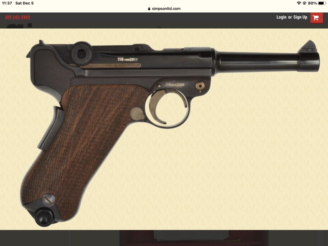

Hi. Forever a fan of the charismatic Luger pistols, finally got my gun license and one of the 1t guns I bought was a 1977 Mauser Commemoration Russian 1907 contract Luger. Practically brand new. If it had been ever shot, perhaps only test fired.
I'm ambivalent , but very much would like to shoot it. At least occasionally. I would prefer another beat up barrel/receiver for that purpose and maintain the original as is. I also have a postwar Erma .22lr kit which I had bought with an upper receiver/barrel, I would think some sort of p08 model.[1940 ] On a 1t attempt, this 'slide' doesn't seem to fit[too tight?] on the Russian Luger frame, I'm under impression from the web that this later Mauser Lugers were made on Swiss equipment and perhaps with their dimensions. Also. I believe it's a 1906 rather than 1908 design, correct? Too many questions, I will pause here, hope to hear a few insights from the elders. TY very much Last edited by STEINBVG; 01-07-2021 at 03:14 PM. |

Simple and short answer to your question: No, don't shoot it.
The Mauser Parabellum commemoratives are going up in price and you will ruin the investment value if you shoot it regularly. Only 250 of them were made. The Mauser Parabellum was not built on Swiss machines, but followed the design pattern of the Swiss model 06/29 with some tweaks to make it resemble the original P08-style. If you want to know more about the post-war Mauser Parabellum, find a copy of our book 'The Parabellum Is Back! 1945-2000'. My advice: get a decent shooter-grade P08 and use that for shooting instead. As a bonus, your 1940-dated upper will fit another P08 without much problems. |

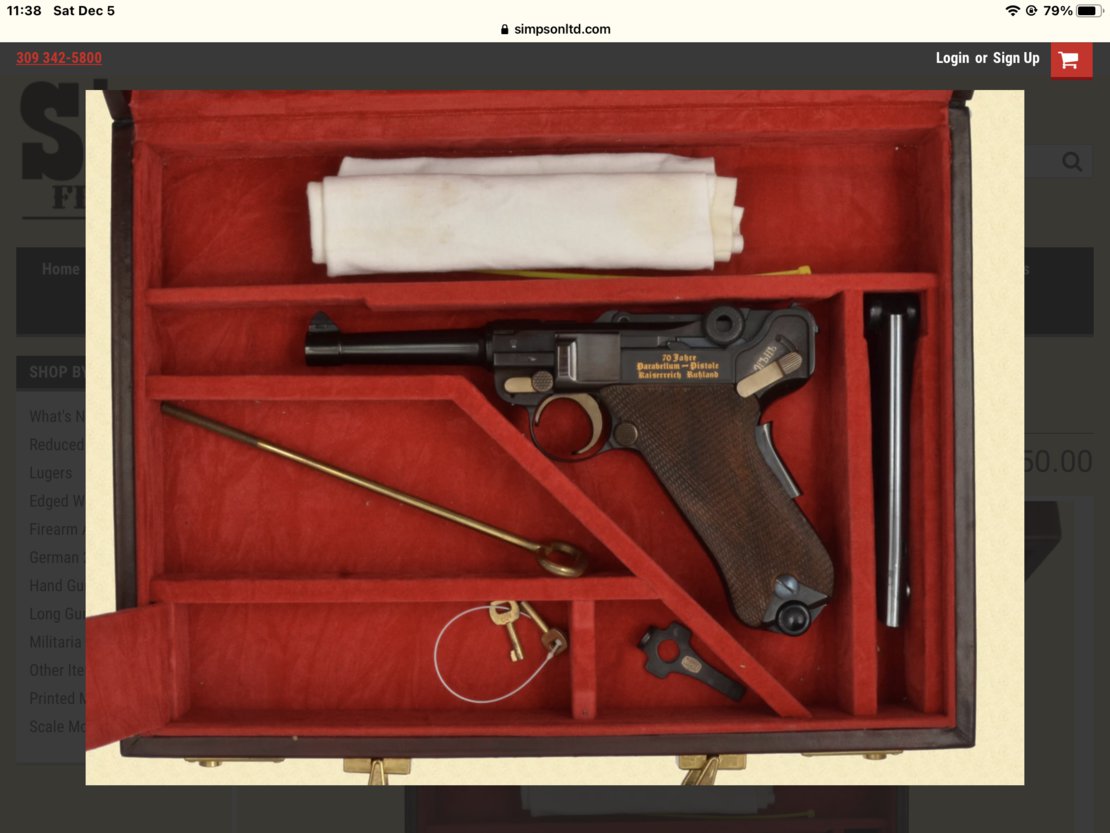

I agree with Vlim; don't shoot it. His comments about value are wise words.
Here is a link to one just like yours that recently sold for $3,750. Shoot it and the value will drop. Buy a shooter and enjoy the Luger experience with it. |

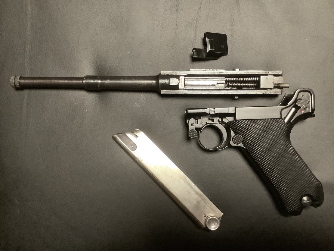

In the mean time, for educational purposes I experimented with my KWC airsoft and the p08 upper/ERMA .22 kit and the combo to my surprise worked decently w/o any modifications except a longer spring on the recoil plunger in the kit. Shows how accurate those toys are. And indeed , afterwards I reversed the airsoft back. Last edited by STEINBVG; 01-08-2021 at 01:53 PM. |

i think that you'll find the 1970's Mauser frame is not compatible with a wartime P.08 upper receiver and barrel / cannon assembly.
For one thing, the profile of the front edge of the frame's ears is different, Vlim can confirm that they are incompatible if this is accurate. Get a shooter Luger. Look for a wartime Mauser.

Your combination represents a firearm constructed from parts all rated as non-firearm. I'm not sure it's something you want to be caught with.
The SE-08 .22 conversion kit and the later SE-08/2 kit fit and work better in the 70s' Mauser guns, with which they were manufactured contemporaneously for Interarms. It's curious indeed how a real upper with a kit will function in an Airsoft frame.

22 ERMA functions decently in an airsoft frame, although with a bit sloppy rail fit. That may explain occasional FTF, extraction problems. But The kits seem to be finicky even in real Lugers. Capricious about choices of ammo. I don,t think I would dare to try 9mm upper on a zinc alloy airsoft frame though.. TY |

Interesting indeed that the Airsoft frame will function the upper; but not surprising that if it trips the sear that the upper fires, after all the upper by itself will fire a round!
Thanks for posting.

The size of the lower parts, side plate, the trigger , the lever seem a perfect match to the original +positioned correctly. The po8 plunger resets with an audible click when you let the trigger go...as I guess it should. I was just curious to see if it could be done while bored out of my mind during COVID isolation. I know for a fact that 22 upper for Glock 17 and 22 upper for 1911 work with airsoft frames also with a bit more work. I would not be surprised if some airsoft twins of the originals became outlawed. |
