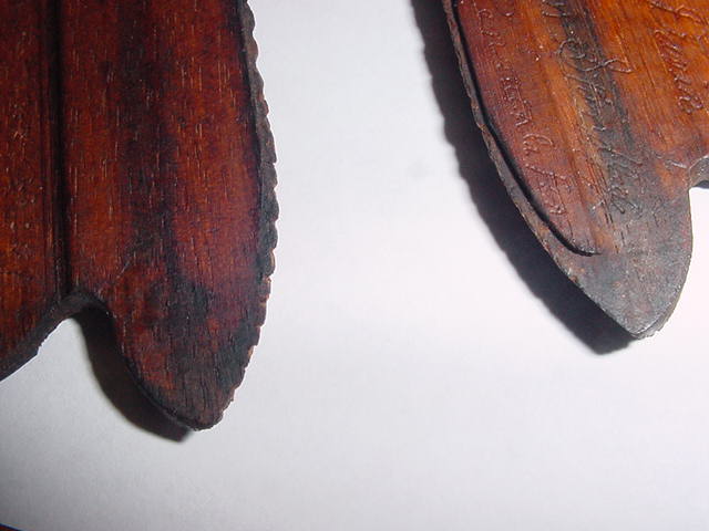

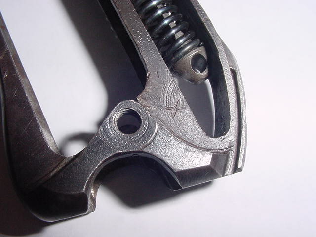

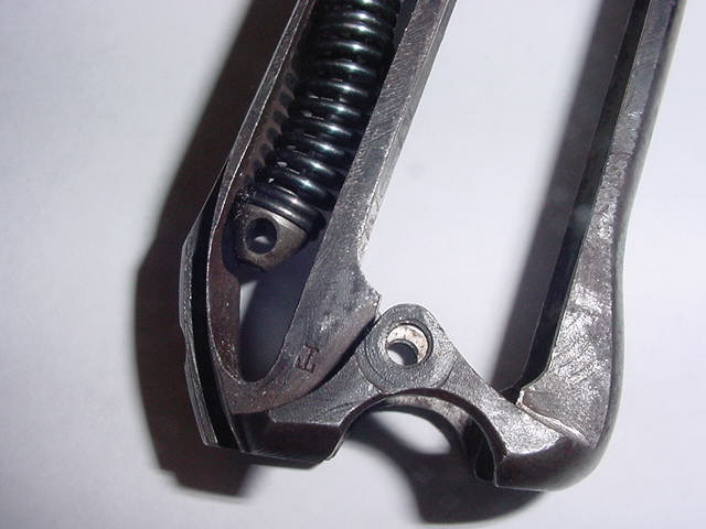

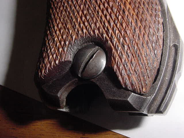

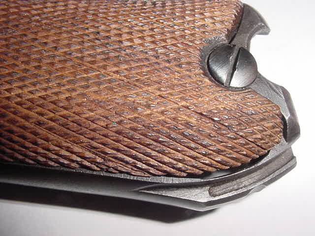

I have a 1916 Erfurt, all numbers match including the mag. Except the grips. The right has what looks like a v and the left has a 2. They have a gap at the lower back. See pictures. The frame is a lot thinner there than my other Luger's, although none are Erfurt but this one. Are all 1916 Erfurt's this thin? Have my grips shrunk? They seem to fit my BYF42 OK and the black grips off my BYF fit the Erfurt.

I have the feeling some Neanderthal filed some out on the inside to facilitate a spring change.
Grips may have been re-cut(checkered) exaggerating the metal removal.

Hi John,

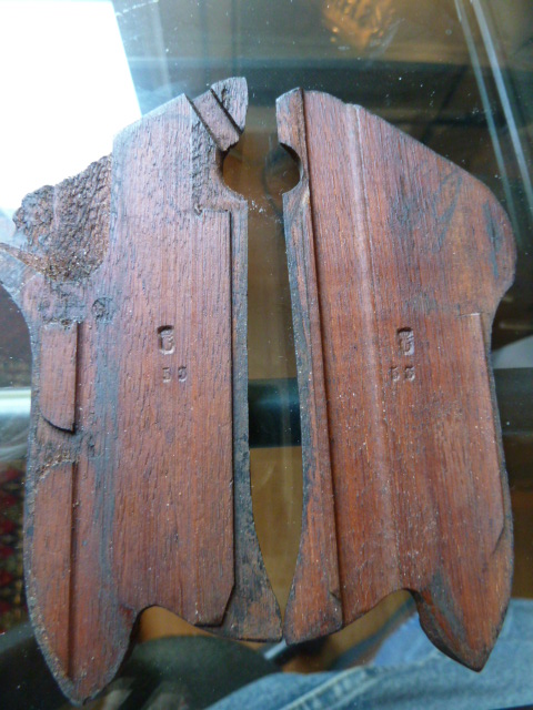

If your grips are not numbered to the gun, they are not original to the gun. ALL Erfurt grips were numbered and inspection marked. Like this pair.
Norm

Thanked 6 Times in 6 Posts
The grips are not numbered other than a 2 and a v. They would have a 38 to match the gun. The inscription reads that the gun was a gift from one person to another in 1963. There is no file or grind marks under magnification. I have a pair of Russian grips that fit fine, I'll just use them since the wood ones aren't numbered. I use it for a shooter anyway. Thanks for the info I wasn't sure if all Erfurt grips were numbered or not.

Jon, not only were the original factory grips serialized with the last 2 digits, but the Erfurt ones will also have a C/letter inspector's marking on the inside. I'd guess that your present grips are from a pre-1914 DWM for a frame without the stock lug. TH

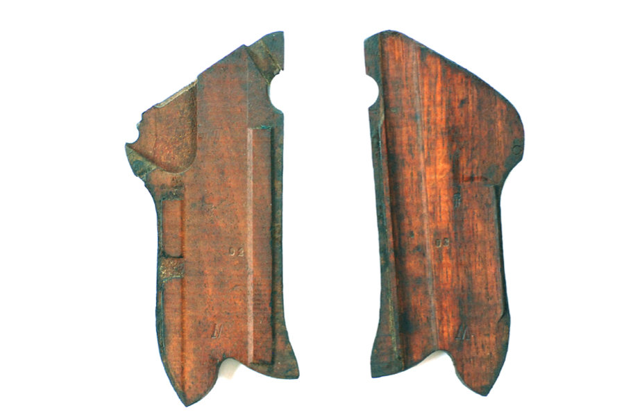

Joncon, here's a pair of Erfurt grips.

Unread 05-31-2020, 04:58 PM   #10
The pair I posted are available. If you squint your eyes they can temporarily match.

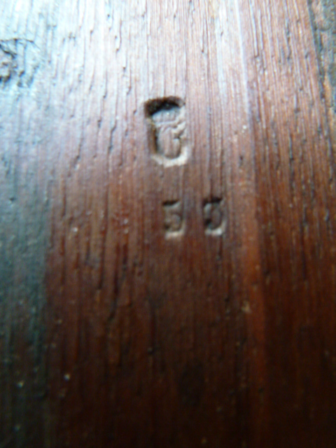

Are yours marked 55 or 53? Hard to tell from the photos. The grips off mine fit my 41 BYF fine, it had repo Black Widow grips on it, also import markings on the barrel, I think CIA or something like that (don't have the gun with me right now) they're almost the full length of the barrel, it's mostly a shooter due to them.

Unread 05-31-2020, 06:54 PM   #12

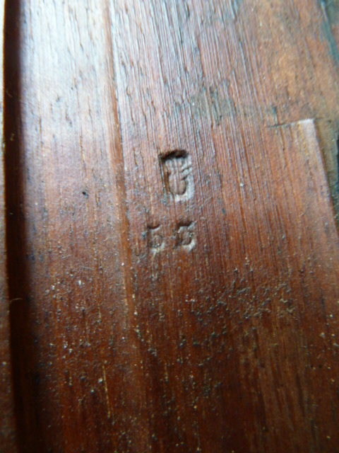

I think they are "53" but my eyesight is shot. With this covid farce I've been waiting two months for eye surgery.

Unread 06-01-2020, 09:52 AM   #14
Kiwi
Kiwi's Avatar
Join Date: Mar 2019
Posts: 335
Thanks: 235
Thanked 478 Times in 189 Posts
53 magnifying glass is your friend - look at the top left corner of the 5 and 3

Unread 11-01-2020, 07:33 PM   #15
spangy
spangy's Avatar
Join Date: Sep 2020
Location: Winnipeg, Canada
Posts: 632
Thanks: 3,206
Your grips are most definitely 53 George .
These grips are 51 off my #'s matching Erfurt 1914 Artillery Luger.

I can tell you definitively that the grips are numbered "53", as I now own them. And I have a very good, lighted, glass.

Unread 11-25-2020, 03:21 AM   #18
Geo99
Join Date: Apr 2012
Location: Whidbey Island WA
Posts: 400
Thanks: 102
Thanked 127 Times in 75 Posts
joncon -
I don't know why no one else mentioned this, but your grips most likely did not shrink - they have been recut/recheckered, and rather poorly. The edges should not be jagged. That said, we know that they are not original to your gun anyway.
