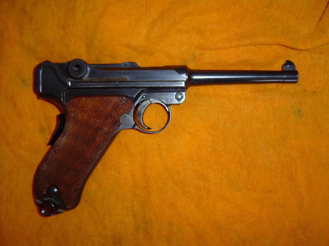

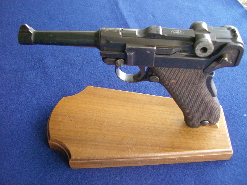

kurusu
Join Date: Sep 2007
Posts: 1,225
Thanks: 2,679
Yes, it has been scrubbed. Too bad, it is a nice looking gun.
It's a curious fact. Most if not all scrubbed M2s are in good condition. Mine is.
And I'm still to find out who did the scrubbing and why.

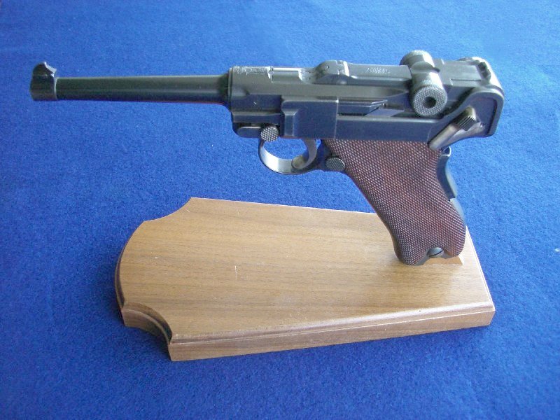

Doubs's Avatar
Location: Byron, Georgia
Posts: 1,745
Thanks: 828
Thanked 1,795 Times in 593 Posts
I've owned two Portuguese M2 Lugers, serial numbers 2088 & 3518. I gave the first one to my son. Both are in good - not great - condition but all matching and with correct magazines. One has a perfect bore while the other is a bit worn. Below is #3518.

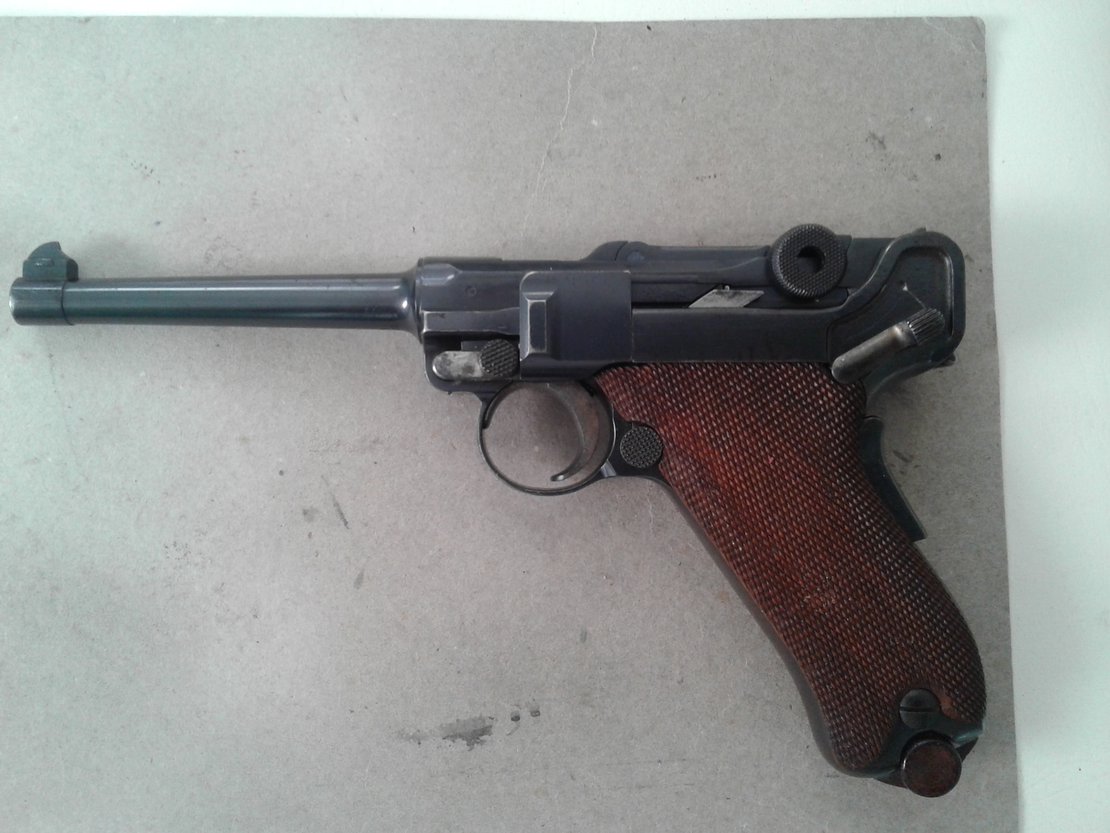

Unread 11-03-2020, 08:51 PM   #7
Here is the manual for the M2 Portuguese.

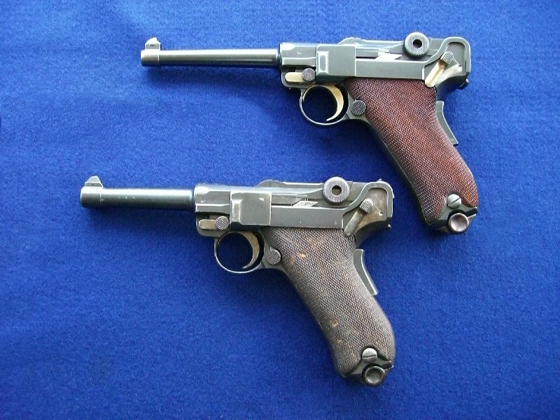

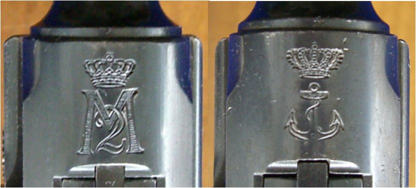

Originally Posted by Fla.Mallard View Post
I have an M2 rig in very good condition but would like to collect all variations of Portuguese Lugers (except scrubbed ones).
I know of the GNR ones and there is supposed to be a version only identified by the serial # but in general I am ignorant concerning Portuguese Lugers.
I used to have a mint GNR, a little later than my collecting emphasis therefore traded off for something else, but I still have two "Royal" Portuguese. The M2 isn't too hard to find but the Royal Navy is a real booger to track down.
