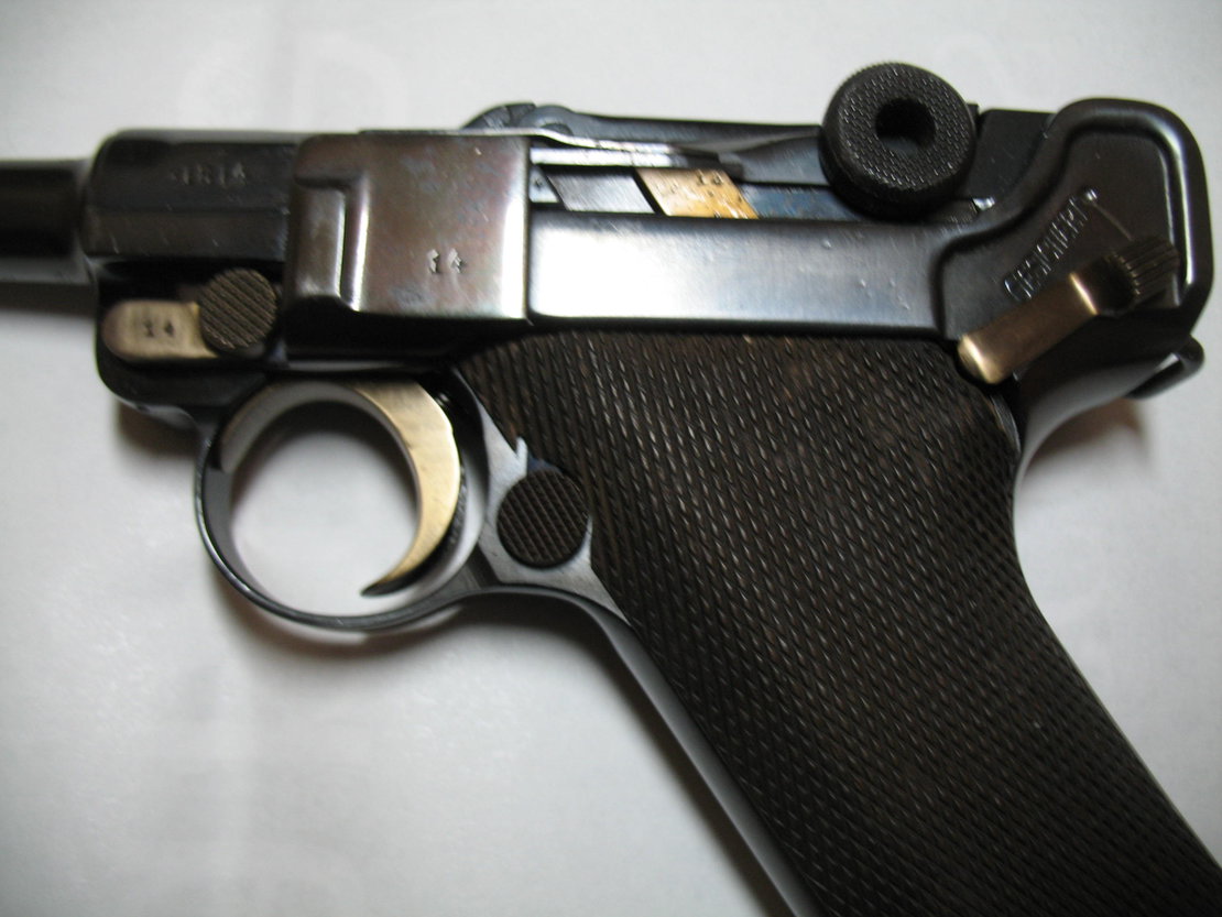

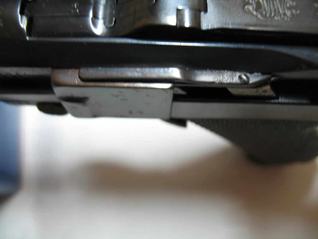

It seems to be a police rework because it has the sear safety and a matching number magazine with an aluminum rather than wood base. It has no magazine safety or police markings.

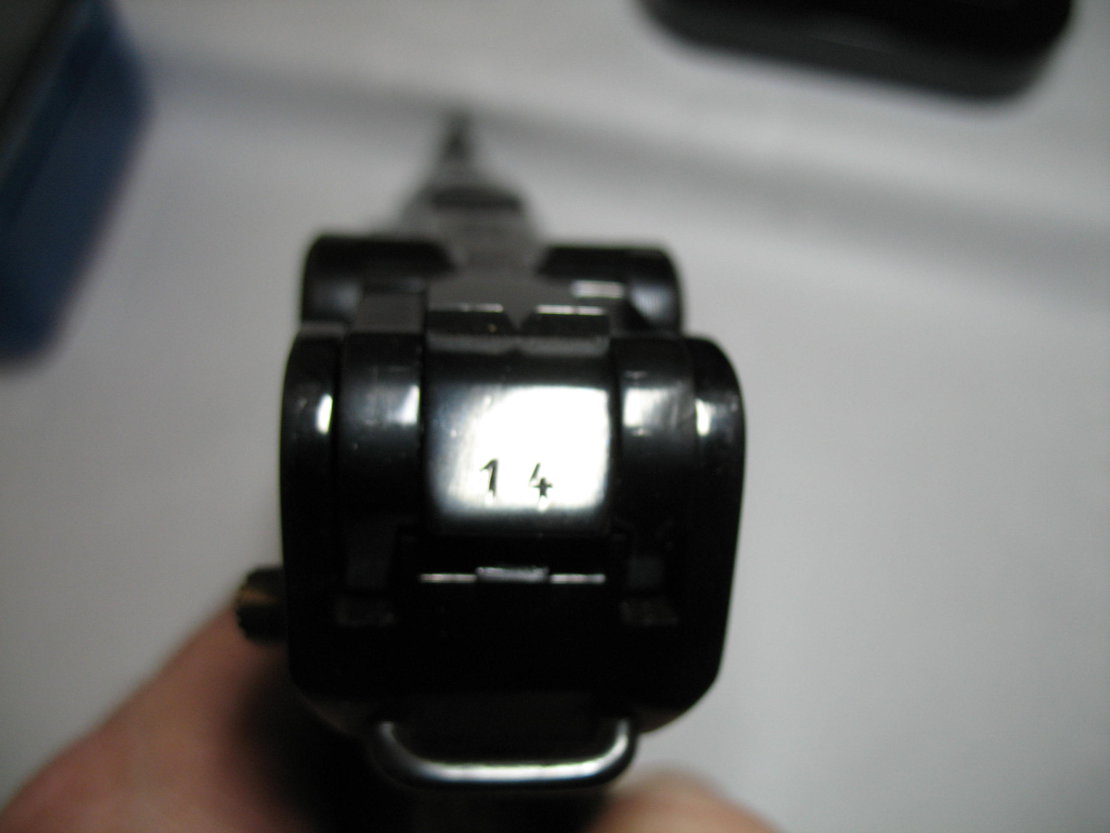

The receiver has a notch cut at the forward edge which I associate with artillery rather than regular military lugers. The barrel does not have the serial number on it, and it looks like the artillery barrel was removed and a regular barrel installed for police use. Further evidence that the Luger used to be an artillery model is that the number 14 on the part of the toggle with the rear sight is stamped with a different font than the number 14 on the rest of the components, suggesting that sightless rear toggle of the artillery was replaced with a regular piece during the rework and numbered then.

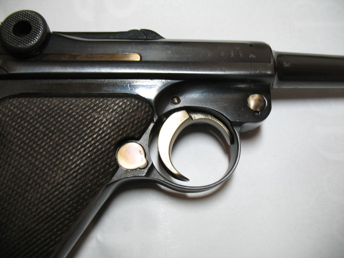

The barrel has several proof marks that may not be very visible in my photos. On the left side near the receiver is a sideways proof mark of an eagle shrugging its wings with a number 35 below. On the right side of the barrel is a proof mark of an eagle with four little lines on each side of its body to denote wings and another mark above the eagle of "FP" or "PP" with the letters close together.

A notched WW1 DWM receiver, regardless of year, will have left the factory as an Artillery Luger. Erfurt, OTOH, only made Artillery Lugers in 1914. All other Erfurt notched receivers from 1916 through 1918 will have left the factory with a short barrel.
The rework into a police pistol would have been post-WW1 but exactly when and by whom is impossible to determine. The stamp on the right side of the barrel would suggest between 1928 & 1934 IF I'm reading Gortz & Sturgess on page 515 correctly.

What companies installed the sear safety? Do the barrel proof marks not identify who replaced the barrel?

The police armorers installed the sear safties.

Don, in the second picture, the barrel appears to have an Eagle/33 stamp on the left side which G&S on page 516 explain would have been applied by a military inspector at the Simpson plant. It is normally found on replacement barrels that also have the PTV/Eagle stamp. I think that the right side barrel stamp was the PTV/Eagle but poorly struck and then the refinish removed even more of it.
I had to use a magnifying glass to see those stamps well enough to determine/guess what they are.

Edward —— The Luger is a 1916 DWM, and I believe the reason it needed a new barrel for police service was that it was an artillery model. It has the notch at the receiver/ barrel interface for clearance of the artillery sights, and it looks like the toggle piece with ordinary sights was added during the rework because the “matching” number is done in a different font than the rest of the numbers.
What I first thought was an eagle 35 barrel mark is indeed an eagle 33 as you suggested. Does that mark identify the maker of the barrel and the time frame of it manufacture?
