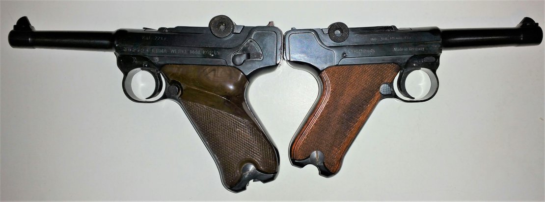

Two different size pistols grips wont interchange
69 on the left 68 on the right

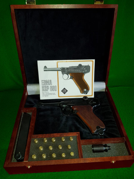

Someone just asked me this very question off the forum. Apparently the KGP 690 was never imported to the U.S., although I have seen exactly ONE offered at an auction on Proxibid in the past 9 years.
I've found that for the 8mm K ammo that the KGP 690 is chambered for, the K stands for "Knall" in German = "bang" auf English. There is an 8mm Kurz (short) rifle round, a bottleneck shell. The Erma uses a shorter, straight-walled case.
These blank pistols came with a gas diffuser that screws into the muzzle, and used when firing either CS gas or teargas cartridges--another handy feature.

The definitive work on Erma history and production, authored by Holger Schlemier, is available in its original German, and an English translation should be arriving any day now.

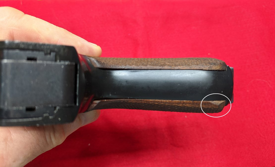

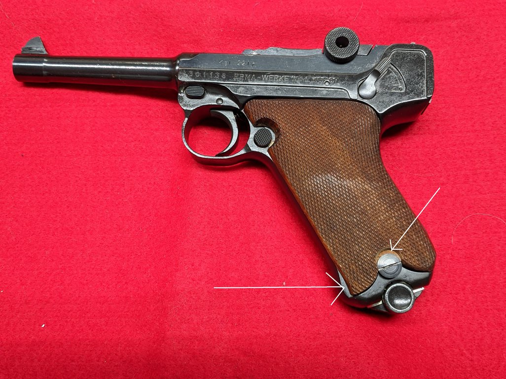

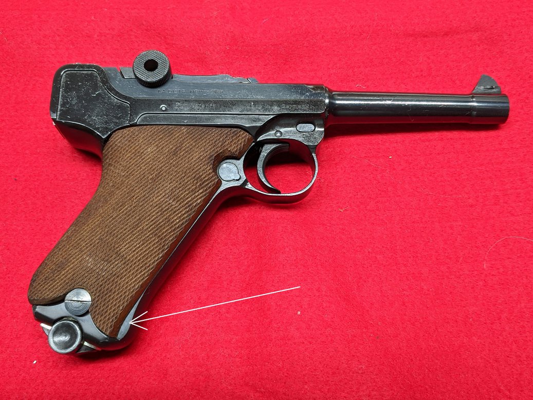

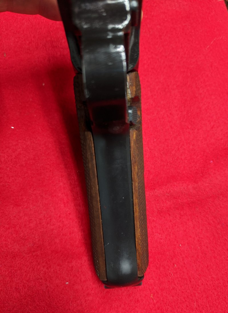

Default KGP 69 wood grips
My KGP-69 now has wood grips thanks to Ithaacartist.
Yes there was some fitting required and the result is not perfect. But feels much better when shooting
Right side - note the wood does not quite cover the grip.
Left side - same area not covered by wood and also I drilled the grip screw countersink too high. I plan to stain that so it is less visible.
Back - excess wood removal - thinking about how to make this blend a little better
Front - I love it.
I did ream the chamber - and ammo feeds fine.
Fun little gun
