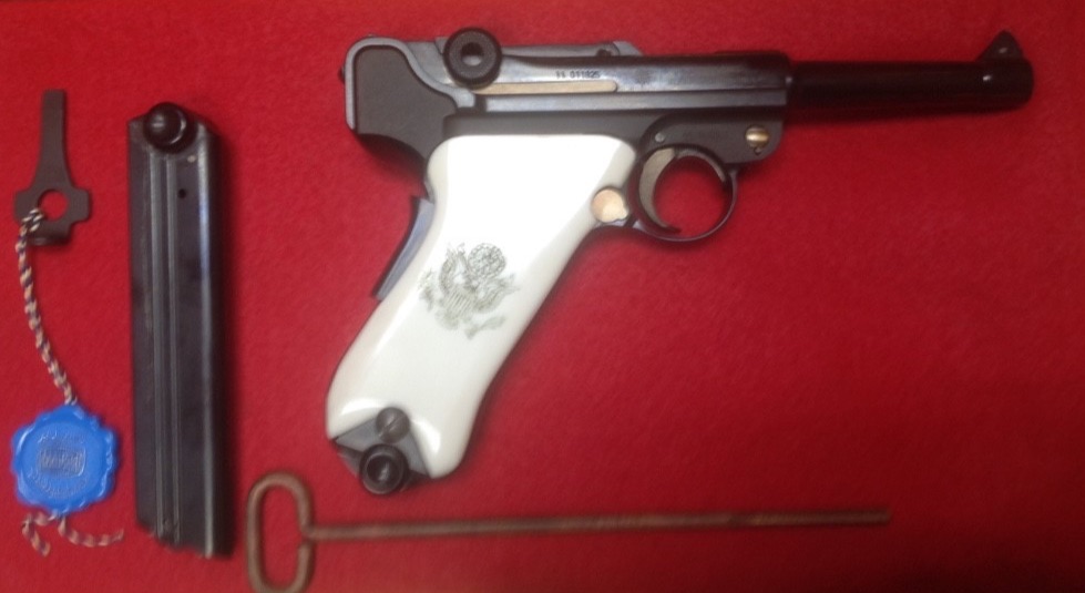

https://www.gunbroker.com/item/872750819
The price is pretty good, right now $706 with one bid . . .
Odd looking box end in the set of photos.
It has 45 ACP checked off ?

Nice gun. It has Ulm proofs, I like the grips.

Unread 07-02-2020, 09:23 AM   #5
Not "Swiss" style; has the "German" grip frame bump.
Unread 07-02-2020, 11:06 AM   #6
Mac Cat
Mac Cat's Avatar
Location: Austin, Texas
Posts: 770
Thanks: 2,194
Right! The white grips made it looks slimmer to me.
Unread 07-02-2020, 11:46 AM   #7
It does have the Swiss wrap around grip safety.
Unread 07-02-2020, 05:19 PM   #8
Does that make this a "new" variety of 1970's Mauser?
Vilm?
Unread 07-02-2020, 05:23 PM   #9
No, all of them have the Swiss wrap around style, only shortened a bit. Technically speaking, the Mauser Parabellum is an 06/29 with some cosmetic work done.

Unread 07-03-2020, 09:57 AM   #11
Interarms gun with different grips added?
Mauser made two different styles of grip frame in the 70s,
first with the "straight" "Swiss" profile; when this did no sell well(enough) they added the hump or "German" profile.
06/73 refers to the grip safety model and introduced in 1973,
I believe Vilm's 06/29 designation referred to the grip safety with German profile- I don't think Mauser called them that.
Vilm?
I'd have to re-read/research the book, but I believe all the Swiss grip styles had a grip safety; the German profile was offered without grip safety; and until I saw this one, I did not realize/remember there was a German grip profile with grip safety offered.
Clear as mud?

Other than the grips, it looks the same as my Mauser Parabellum model 06/73 as identified in the book "THE PARABELLUM IS BACK".
Unread 07-03-2020, 12:02 PM   #13
06/29 is the model designation of the last Swiss luger, on which the Mauser Parabellum is based.
The first Mauser Parabellum was called the 29/70, the P08 style the 06/73.
The P08 style commemoratives had their grip safeties modified so they were hidden under the left side grip and non-functional. But the remains are there.
The grip safety itself was needed to get the pistol through the import regulations in the US. The grip safety was shortened at the request of Interarms to give the pistol more of a 1906 look and less of a Swiss one.
Unread 07-03-2020, 12:09 PM   #14
Doubs
Doubs's Avatar
Location: Byron, Georgia
Posts: 1,744
Thanks: 828
Thanked 1,794 Times in 592 Posts
Don, I agree with your comments. The book calls what Vlim refers to as the 06/29, the 29/70.
There was an 06/72 Transitional model that used the 06/73 frame and 29/70 small parts including the early style front sight. About 2500 were made between October, 1972 and April, 1973; approximately 500 in .30 caliber and 2000 in 9mm.
The book calls the 06/73 the "compromise model" as it was what Interarms and Mauser finally agreed upon.
Unread 07-04-2020, 01:27 PM   #15
The 06/29 was the Swiss designation for their pistol. It was not a Mauser model designation.
Mauser started with the 29/70, which is not the 06/29, but Mauser's first attempt at recreating the pistol.
So: 06/29 = Swiss
29/70 = first Mauser Parabellum, straight grip
06/73 = second Mauser Parabellum, P08 style grip
Indeed, there is a period of overlap as Mauser used up 29/70 parts on P08 style frames.
Mauser even reworked 3 06/29 Swiss pistols to be used as demos in 1969. That also caused some confusion. Also some drawing verification models were made that shared more features with the Swiss than the Mauser production models
