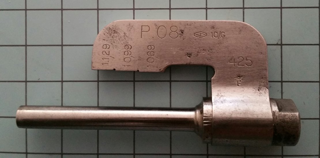

Default Some gauges at auction--what are they for?
https://www.proxibid.com/Firearms-Mi...98162#topoflot
Unread 05-28-2020, 10:47 PM   #2
I would say that they are all to do with front sights, their heights, profiles and widths

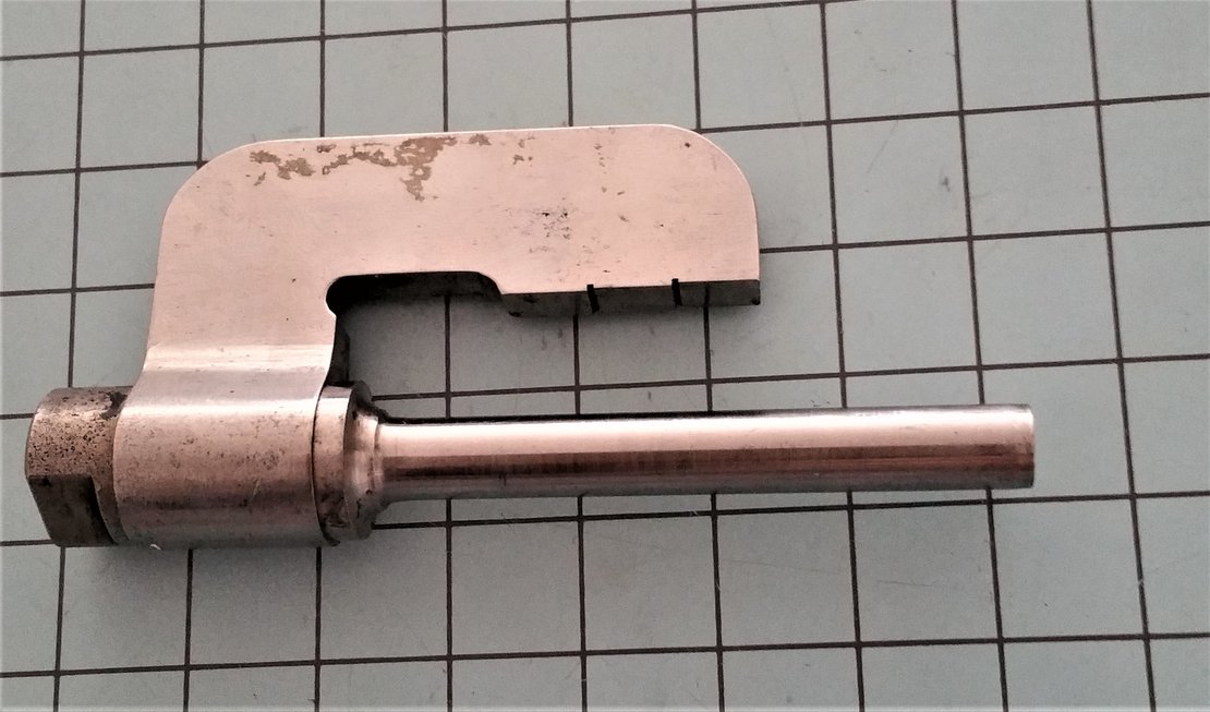

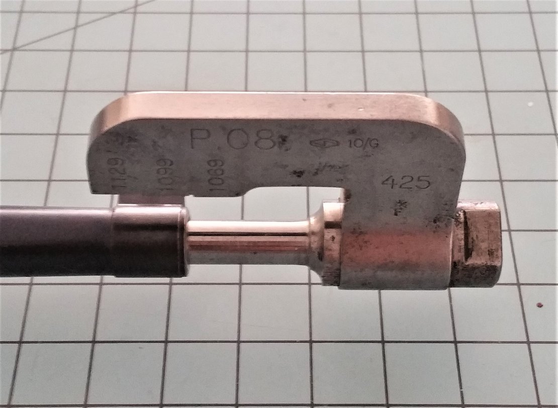

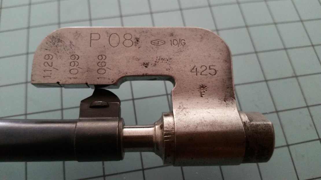

Default front sight gauge
Here is one up closer, used to measure height of the front sight with relation to the bore's axis without regard for different barrel profiles. This one is set up for the 7.65 barrel and can be changed for a 9mm one.
Can anyone tell me what the 10/G represents.?

Default Rear Sight
The short one gets inserted in the P.08 toggle hole of the rear axle pin and would be a measure of the rear sight, too high or too low.
