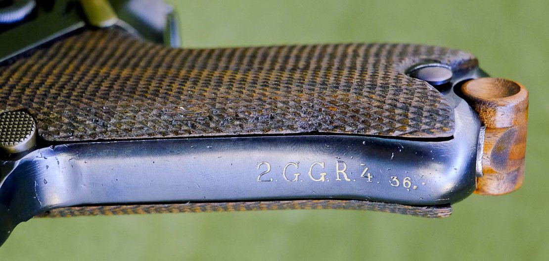

hey folks -
Picked up a blank chamber date DWM Model 1908 with unit markings on the front grip strap.
Appears to be "2.G.G.R. 4. 36" [ pls see attached image for detail].
1st time getting a P08 with the markings so any assist on the unit ID most appreciated.
BR
Commisar

Scott,
A rather scarce unit marking, 2nd Garde Grenadier Regiment, Kompagnie 4, Waffe Nr. 36. I am delighted to see another 1908 Luger with this unit designation. I have a 1908 DWM First Issue, SN 1022b, marked 2.G.G.5.6 - it is the same regiment but since these guns were marked at the unit level, the unit armorer for Company 5 didn't bother to add the "R" like the armorer for your Luger from Company 4. (Also note that they had a different idea about how to orient the markings )
Thanks for posting your early military Luger. If you wouldn't mind, it would be nice to know the serial number and see a photo of the acceptance marks on the left side of the receiver.

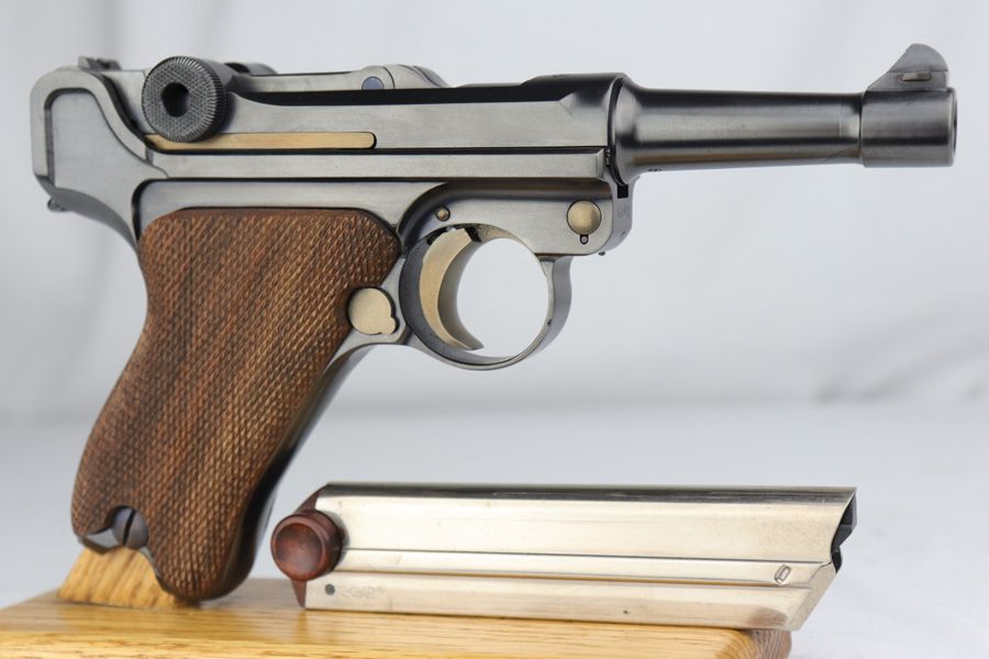

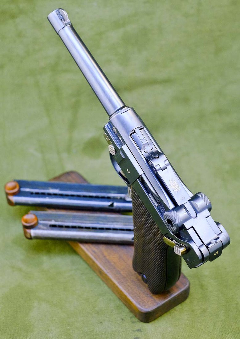

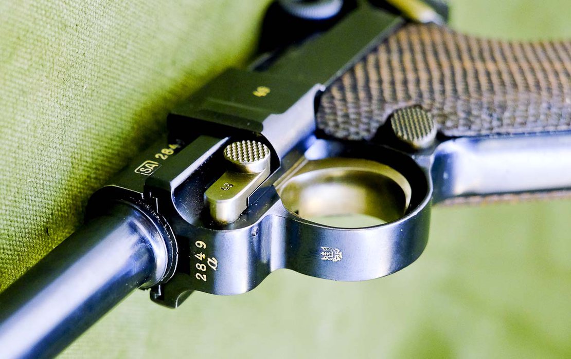

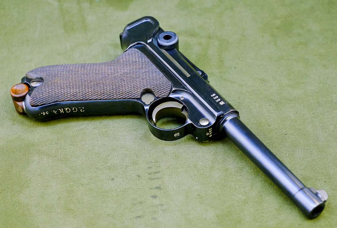

Thanked 20 Times in 3 Posts
Default SA P08 description/images
Hi Ron -
Thanks for the Guards Regiment ID..I couldn't find an online reference.
The serial number is 2849a and pls see attached images.
This P08 has had 4 lives. Here's the description text provided by the seller.
"DWM P08 SA Tikka Finland 9mm Luger
Luger P08 in 9mm Luger early variation
DWM made in Germany 1910 before WWI.
serial 2849a
Gun is all correct with two WWII era Finland-made magazines
and perfect Tikka Barrel that is 4.75 inch long
This gun had at least 4 lives:
It was originally issued to German troops evident by Unit markings
and served during WWI
After WWI it was reworked by DWM and reissued to police unit in Germany
as evident by a police magazine safety that was later deactivated and visible on the left side of the frame
It served during WWII in German Army (only way it ended up in Finland)
Captured by Finland Army during WWII and reworked and issued to Finland troops as evident by a new Tikka Barrel in perfect shape and an SA Finn Army mark on the left side of the slide.
Typical of the Finland rework, the sight picture is changed to a square cut which makes it very easy to use at the range
Very interesting conversation starter and a perfect working gun to be enjoyed at the range
Perfect bore and overall perfect shooter it has undergone detailed mechanical review, testing and historically accurate rust blue restoration to factory new condition
Tested and worked fine."
Typically I would avoid a rust blue restored P08 but I made an exception in this case as I know the restorer and his work. I purchased one of the baby Lugers from his shop [ pls see attached 1918 DWM conversion images ] and the detail and craftsmanship are Old-World quality.
regards,
Scott

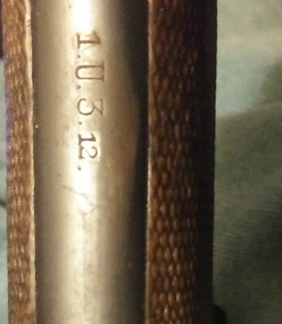

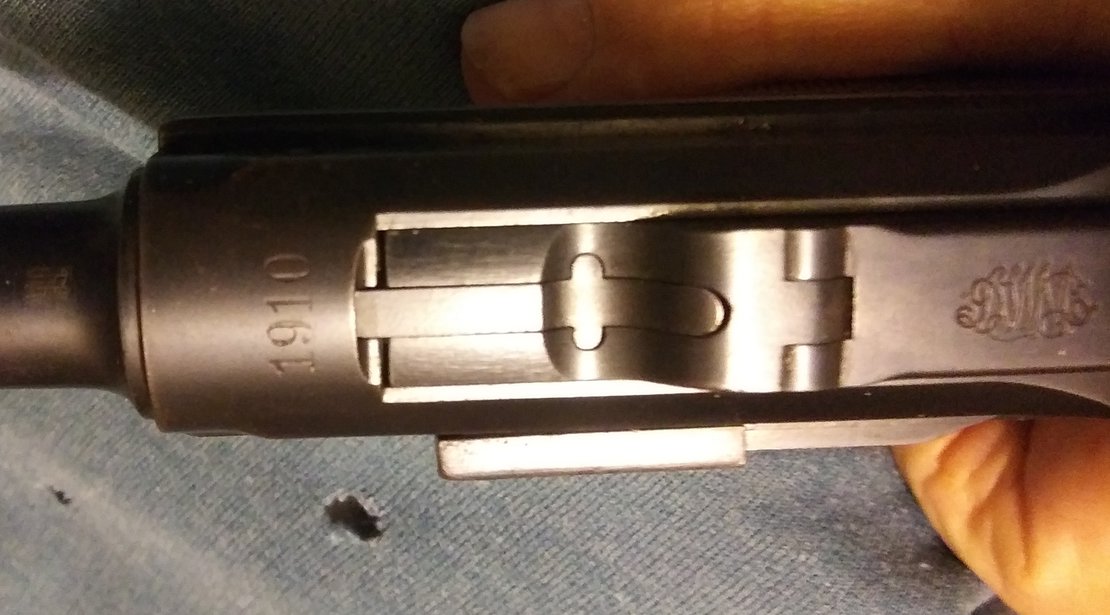

I have a 1910 with the grip marked 1 U. 3. 12.
Serial is 5582L
Thnere was something engraved on the side and someone ground it off.
I have had it over 50 years.

Can we have a picture about the nice "1 U. 3. 12" stamp
Got 4,5,6 U in my data but none 1,2,3.
Thanks

The best I can do right now.
