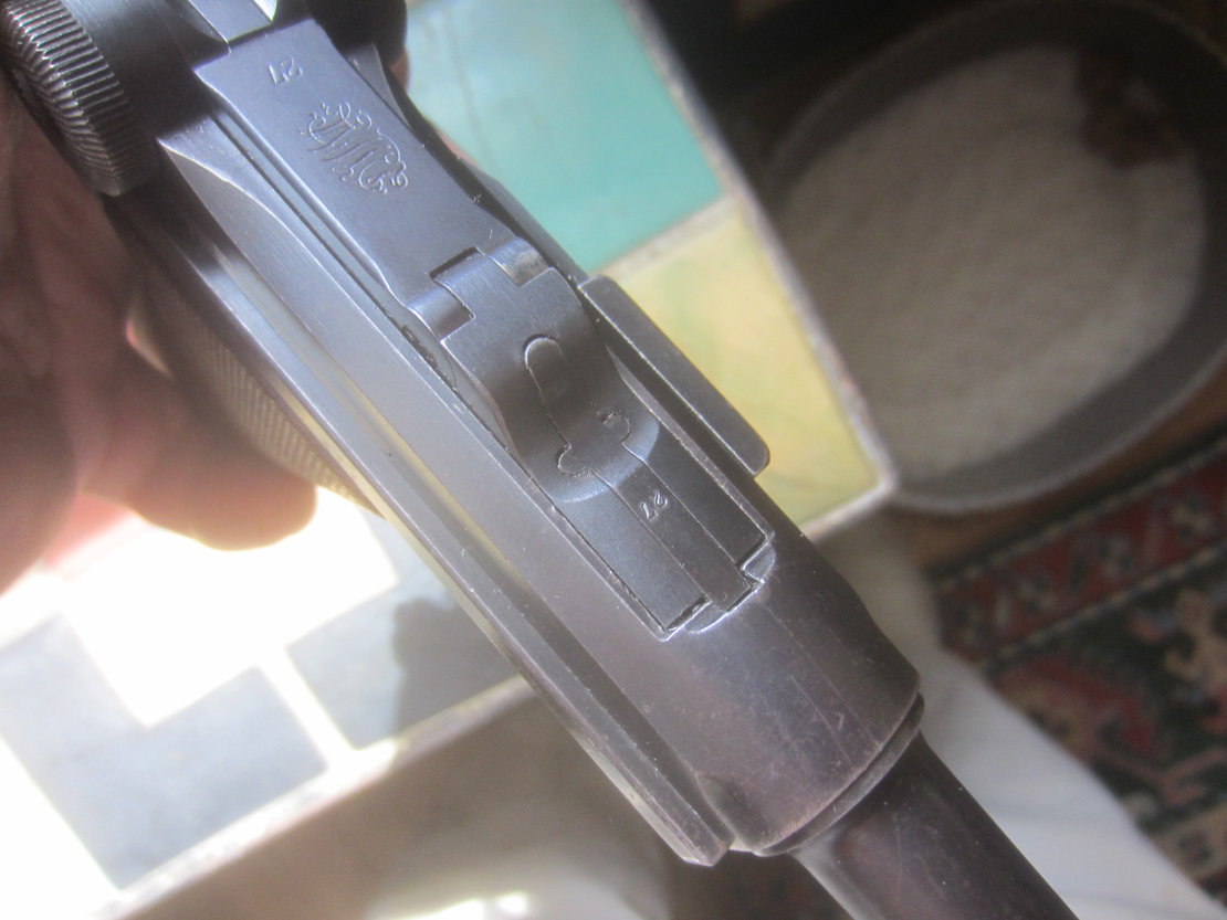

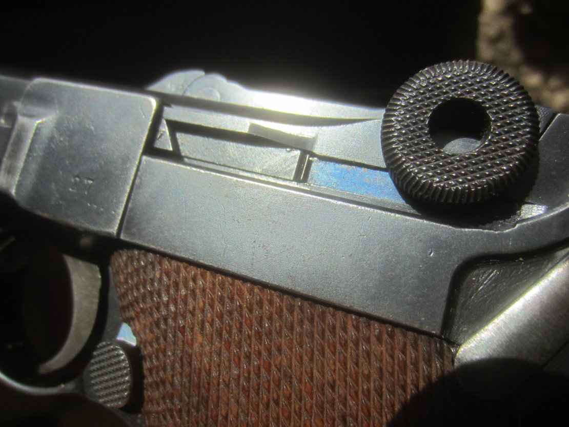

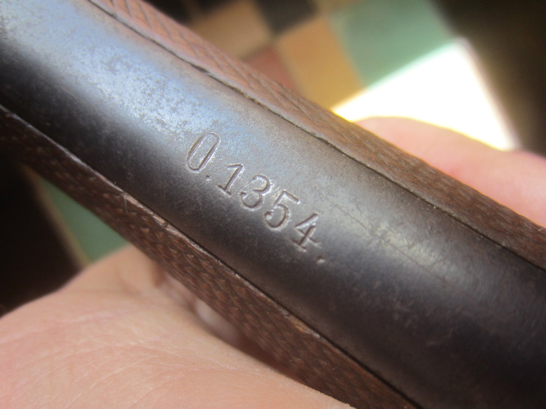

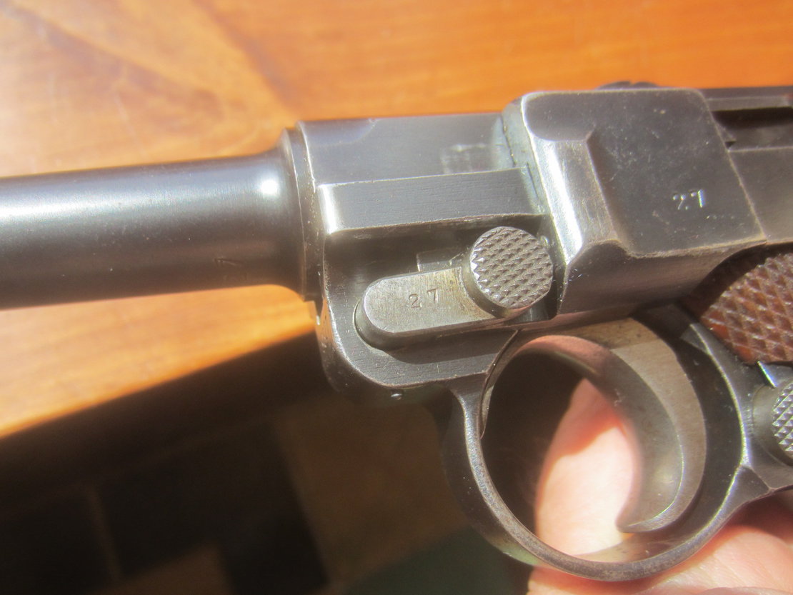

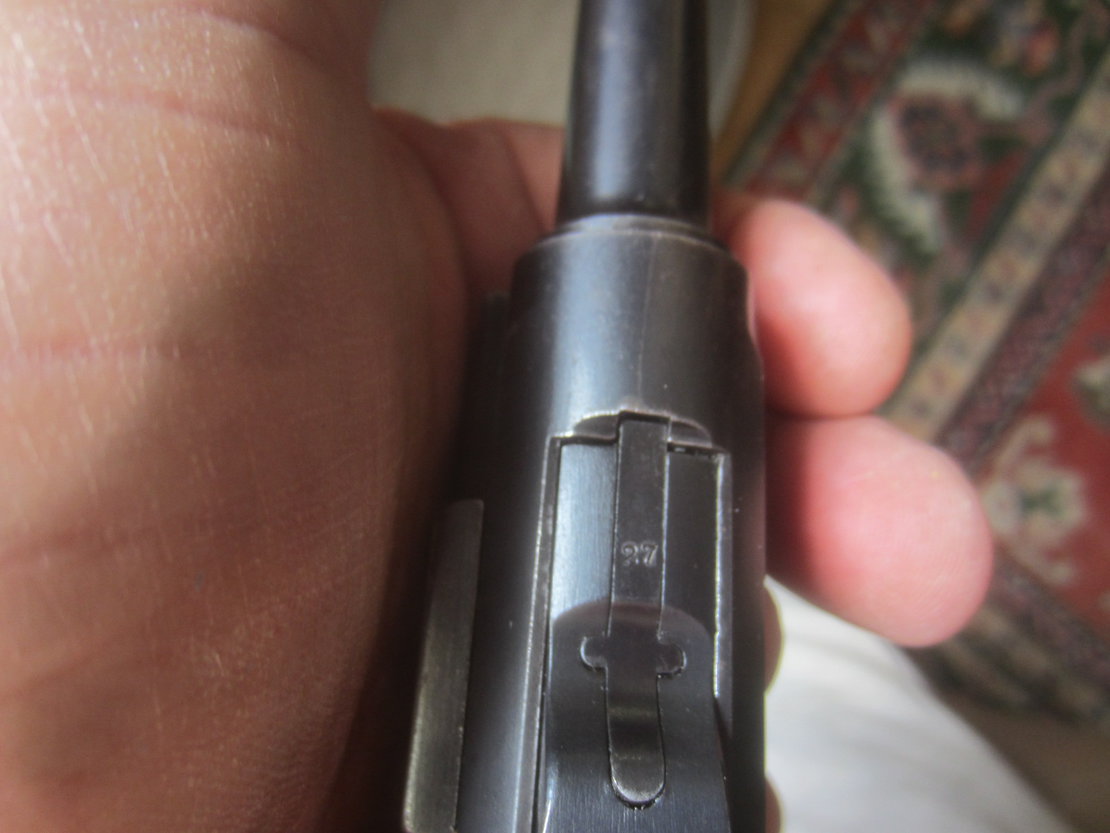

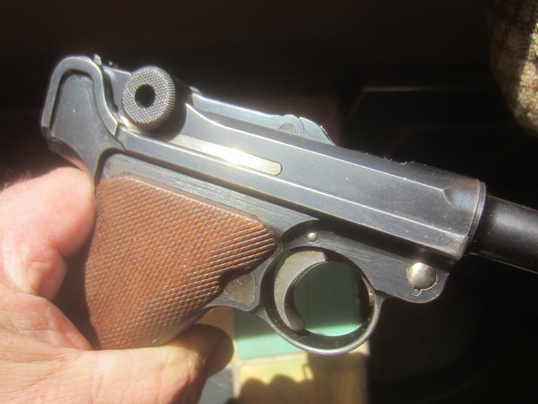

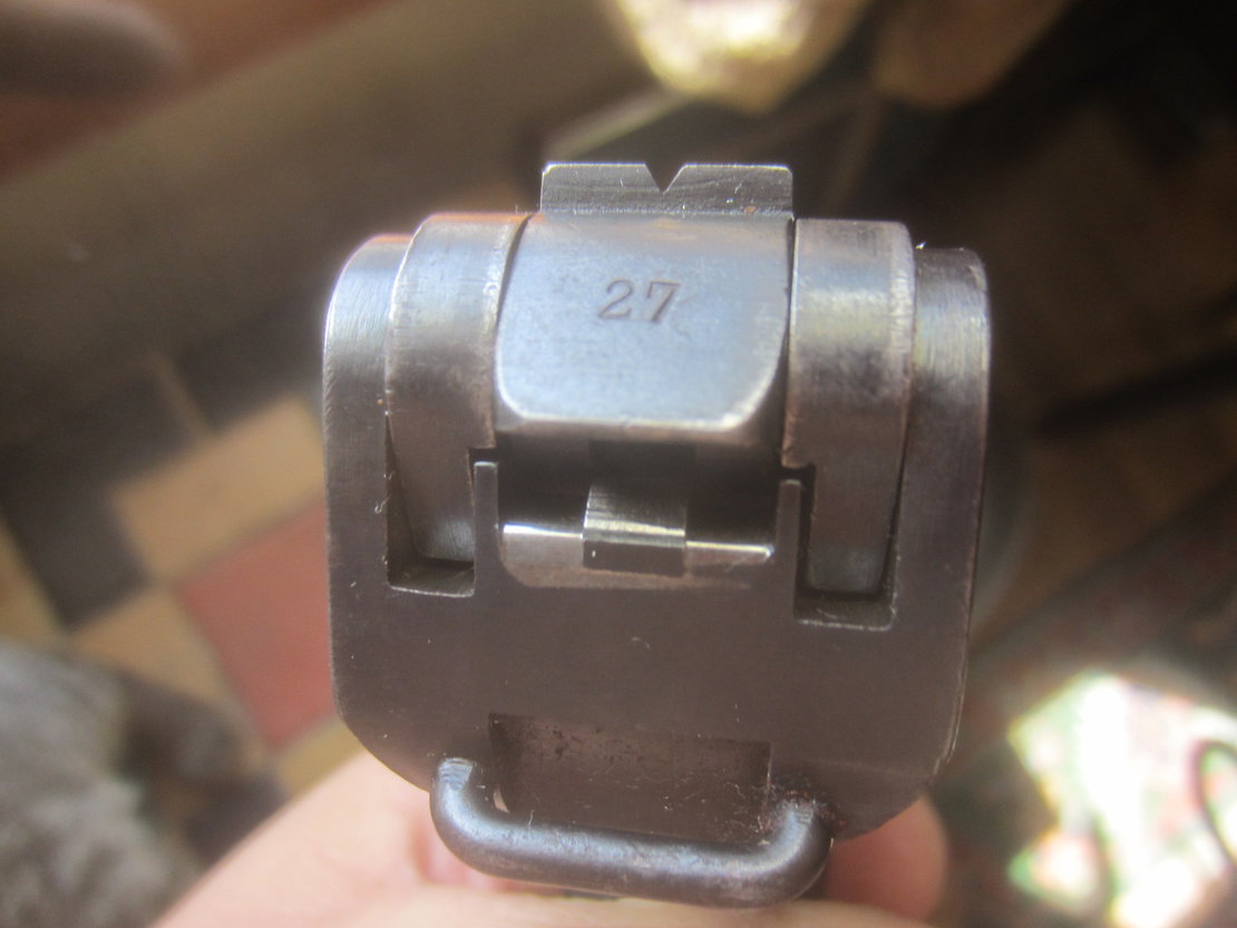

Howdy, it seems that I have entered the world of Luger identification! I have had this pistol for some time, and now that we are housebound, decided to take some time and figure it out. As you can see, it has no date, no proof marks and no # suffix. I understand the Ostsee mark ok. Any help would be greatly appreciated. If more photos are needed, please ask. Thanks! E.

welcome!
Just be willing to wait a day or so and others will chime in who know Navy Lugers.
Perhaps a clear close up of each side, straight on. I was expecting to see a commercial crown N on one side....

Thanks for responding. Ill add photos in am. The absence of that proof and others has me stumped. They do not appear to have been removed. I really look forward to some honest opinions. Best, E.

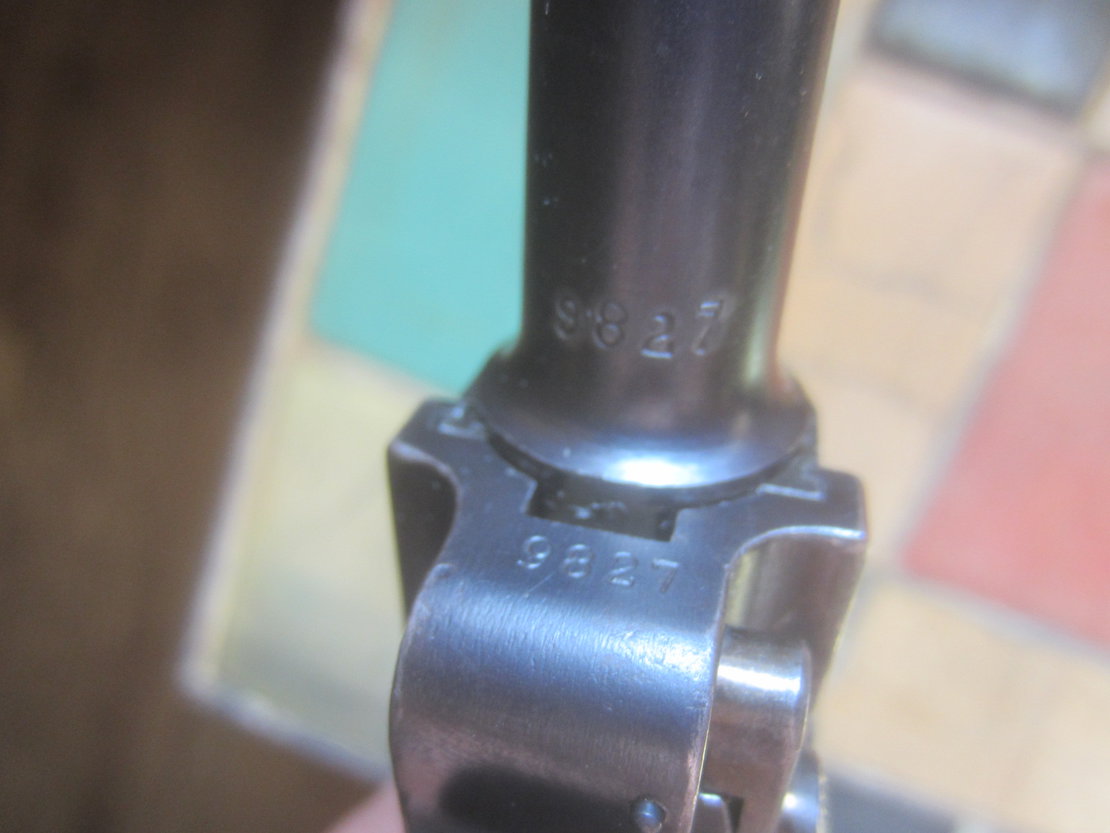

More pictures are needed as Ed suggested.
Right now, all I can say is that the numbers on the barrel are not original.

Ok, here are more photos of the pistol. Not sure about any numbers not being "original", but I can tell you that this was personally purchased right off the attic, so if they are not of a recent (last 80 years) addition, that I can assure you. Again, thanks for your input and expertise in helping me know exactly what to call this piece. Best, E.

My best guess is an imperial era luger that got reworked and scrubbed in the Weimar era, and somehow escaped proofing. It is an odd one for sure. Thanks for posting it. John

What are the caliber and the barrel length? A 9 mm and a 4-inch barrel may throw the easy"Weimar rework" explanation into question. Does the 80 years attic attribution mean it came over after WW1?

Yes, it is a 4" barrel and 9mm. Here are some photos of the holster it was in. there was no magazine. This was found in and amongst some other WW2 items packed away in an attic trunk. All I know is that they had all been there at least since returning from WW2.
That's about all I can honestly tell you.

It was probably an Imperial military that got scrubbed of war time proofs, reworked, rebarreled, and diverted to the Baltic Weimar Navy. Lack of barrel guage and proofing is the inigma.

Most reworks for Weimar police or military use the original barrels with the addition of Weimar property markings to distinguish them from new production. In the odd case of a new barrel, they have the original receiver, proofs and date marking. Many have the 1920 stamp. New production was regulated by the treaty of Versailles which mandated the short barrels and less than 9 mm. requirements.
Outside of the above two streams of Lugers, military reworks and civilian new production, we start to see a whole bunch of irregular Heimgemach (homemade) stuff. The barrel on this example seems to have been hand-stamped with a slightly out of size font. The receiver is unnumbered and unproofed but appears to have parts original to the frame.
I do not think any of the examples like this came out of government reworks, certainly not DWM, or Simpson, or Mauser. To me "Weimar rework" implies government sanctioned work.
Pieces like this example are just as likely to have been reworked in the US, where a number of rework mills existed, and are outside of the realm of mainstream Luger production history. With all the piles of Lugers in inventory, why would the Navy want this gun?
It looks like a nice shooter that needs to be checked out for safety.

My area of interest ends when W.W.1 ended, so Weimar Navy marked PO8's are outside my wheelhouse. That said, the Ostsee (Baltic Sea) marked frame is the only piece of this collection of parts that could possibly be described as "Navy".

EJINPA, I do not mean to sound like I am trashing you Luger. It is in fairly good shape and the Baltic Sea Navy stamp on the grip is interesting. However, it is more of a "shooter" than a collectible because it has been modified. Those modifications were by an unidentified party at an unidentified place and time. It is what it is and ain't what it ain't.
Because it has a non-original barrel and an unidentified receiver I would suggest you have a competent gunsmith take a look at it to make sure there are no problems. After that you should have a ball shooting it. The Luger is an extraordinary shooter.

Unlike Norm, I do "specialize" in Weimar lugers- though it is a very confused and confusing time and the lugers that were used are a challenge to understand and to explain!
I believe your pistol started life as a .30 caliber "commercial" luger, the barrel was replaced and numbered to the frame.
This could have been done in a navy workshop and the Ostsee marking applied then; or before in commercial trade only.
However, since the upper was not numbered to the lower when manufactured, it may have no original relation to the lower frame at all, and could have been assembled at a later date from a Navy marked lower frame and "an" upper of commercial origin. The Barrel was likely numbered when the barrel was changed or when the upper was mated to the O marked lower.
The Ostsee number of 1354 would have been added about 1934- at a time when the Reichsmarine(Weimar) Navy was building up and would soon become the Kreigsmarine(nazi) Navy.
So, either the pistol was in Navy hands before that date, and numbered to the Ostsee as a complete pistol, or was assembled later(postwar) from a collection of parts.
Long story, but the bottom line is that it is not possible to know when, where, or who assembled your luger in its current configuration.
Because of the unknown heritage, I would say it is an "interesting" shooter- due to the Ostee markings.
Value is whatever you or someone is willing to pay for an "interesting" luger. JMHO.
