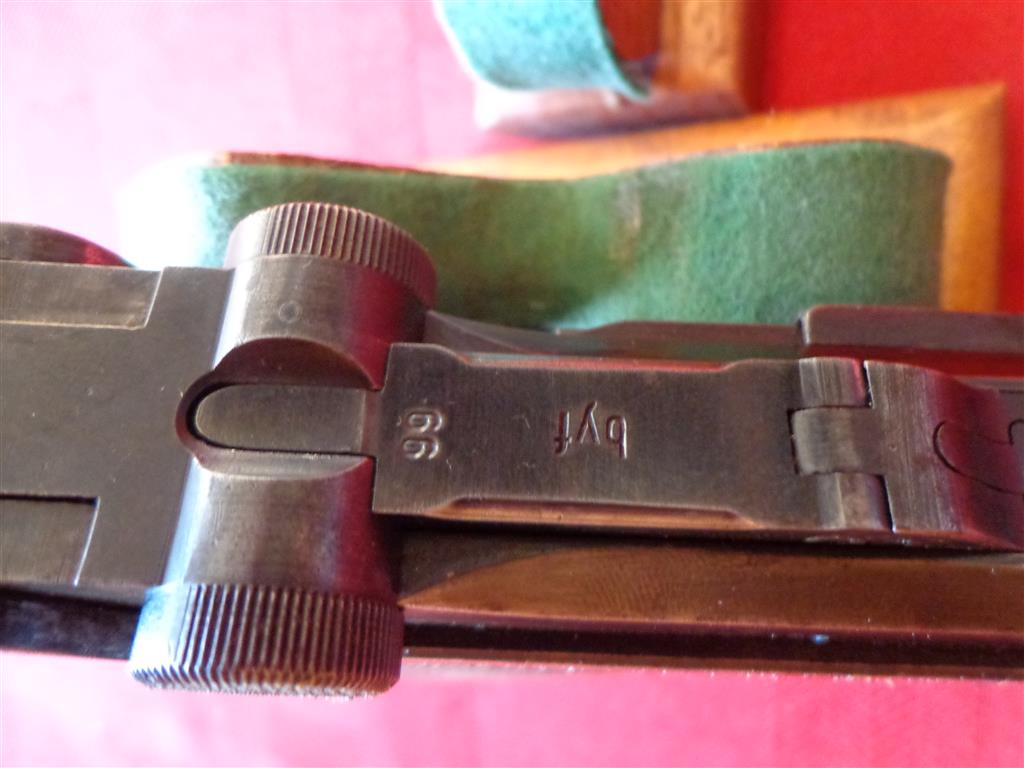

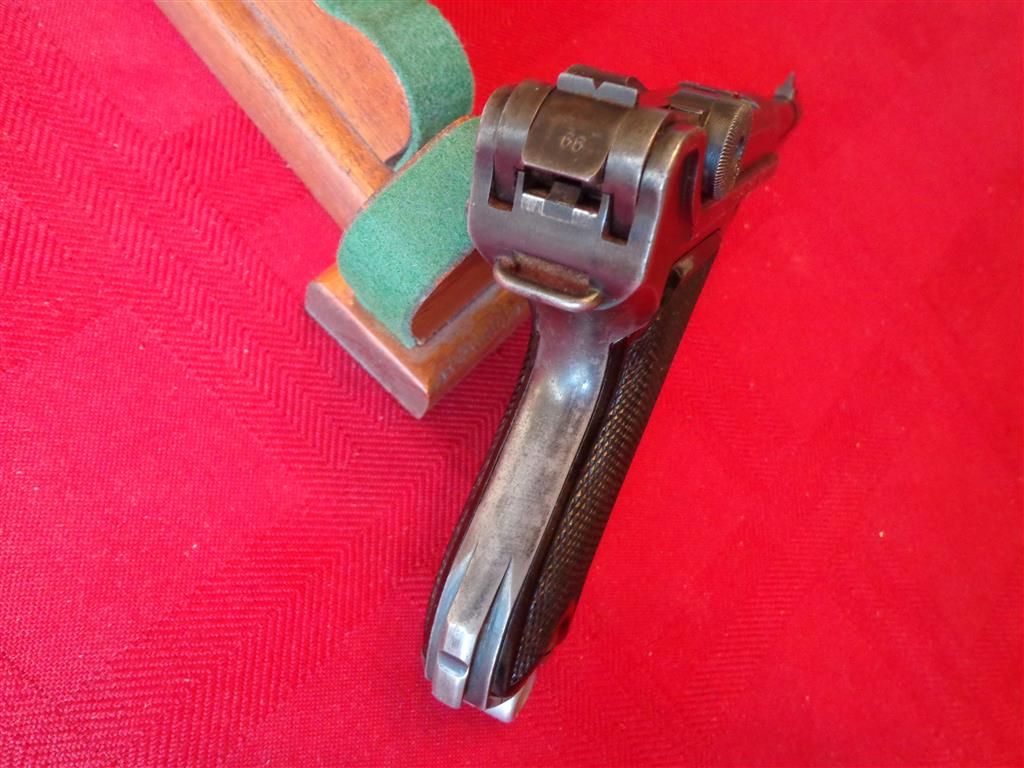

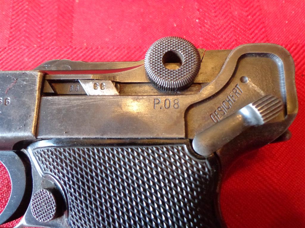

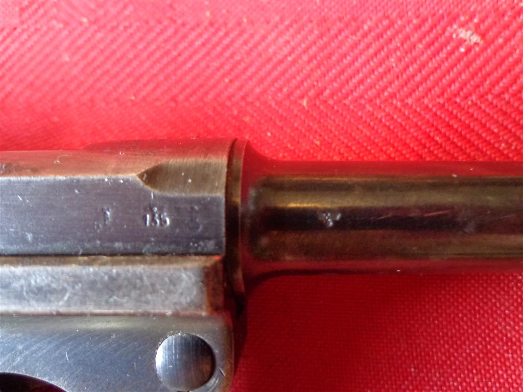

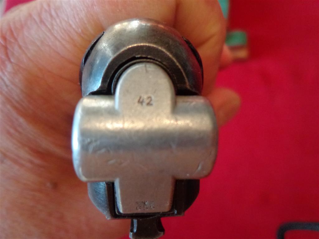

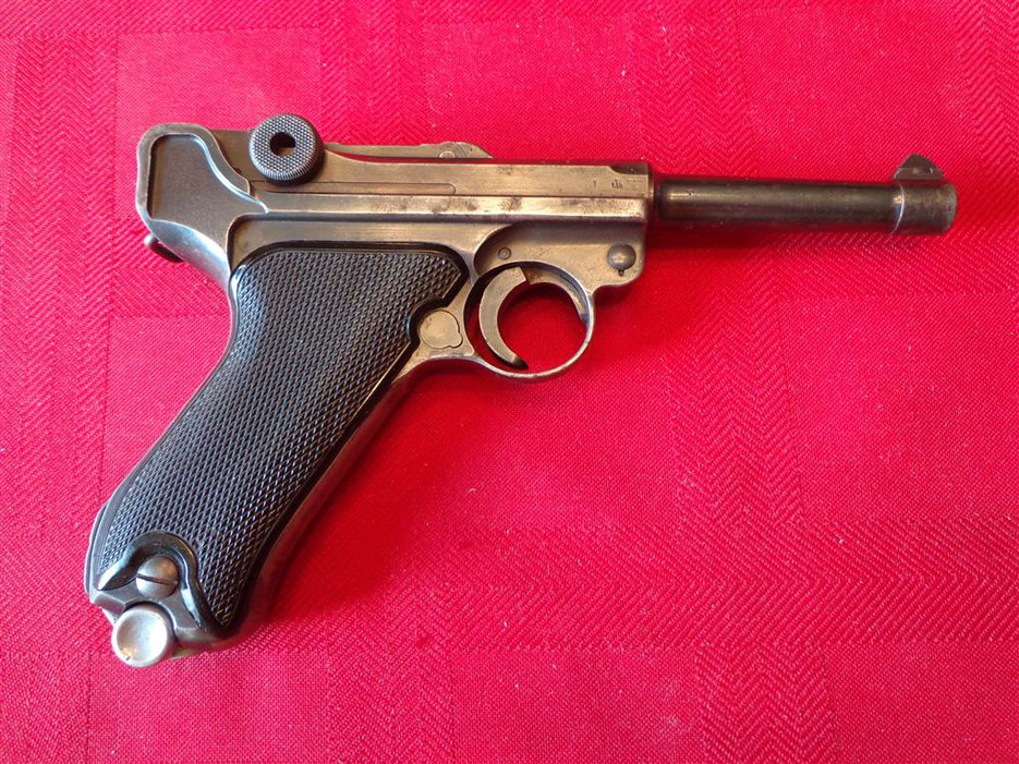

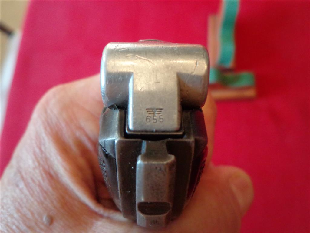

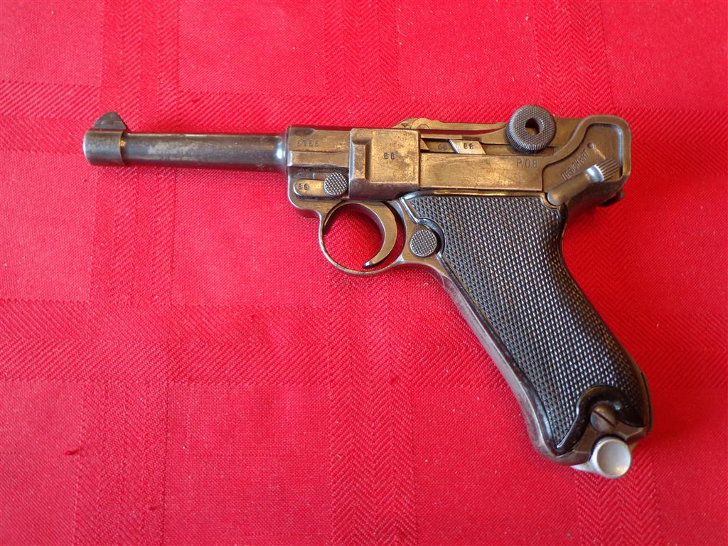

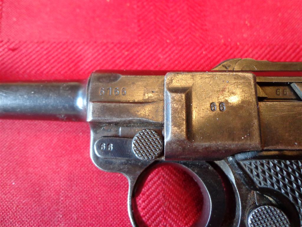

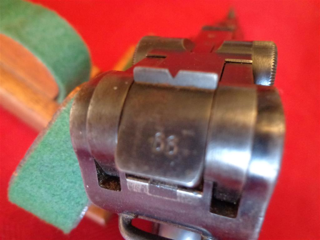

Hello all. New to this Forum. I'm a collector/shooter of earlier antique guns. So I'm more of a novice with Luger pistols. But I'm trying to help a friend who inherited this pistol. I'm attaching pics and description of what is known, and appears to be complete. But thought I would post it here on this Forum to see if any of you experts might be able to add any information not already shown in the description. Thanks for any help. Rick

An honest byf 41 Luger with an armorers replacement (42 marked) magazine. Lots of surface finish wear from your photos, but maybe with less flashback from your camera it looks better.

Thanks for your comments. You're right about the finish. I would say it retains about 50% of the original blueing which has turned into the typical dark blue-brown patina. Mechanically, it functions fine and the rifling still looks good. I guess you would say used but not abused. Thanks for the clip ID.
