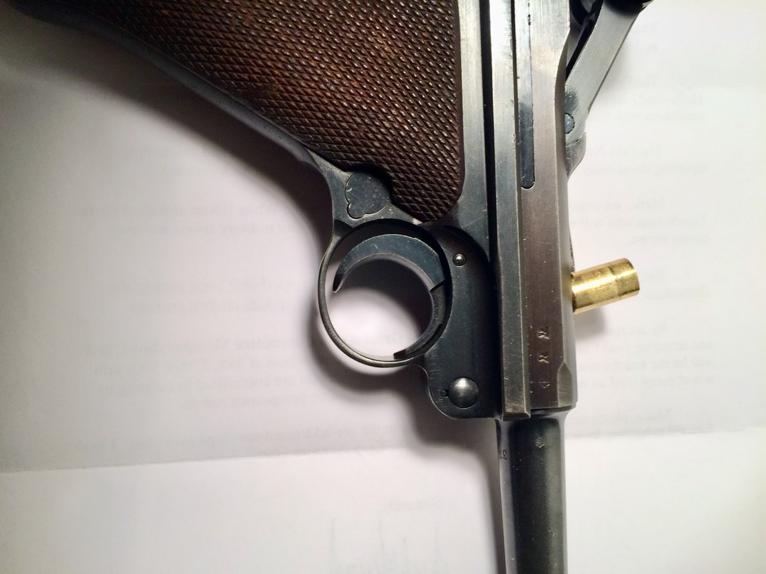

Today I took my P08 to the gun range to try it for the second time to see if it repeats the jam problem I had on my first visit. (stovepipe).
This time I only got off three rounds before it jammed. I'm showing an example of the stovepipe jam that happened on my first visit. I don't have a picture of the second jam but it happened as the next round chambered and was more pronounced than what is showing in this photo. The shell was leaning more to the left (~50 degrees) and really jammed.
Anybody have any idea why this is happening?

Ejector arm may be broken or the ammo is weak; plus a half dozen other things.
But look at these first.

A couple of ideas come to mind.
Weak ammo or too little recoil resistance (i.e., limp wristing).
If it's a bad or broken extractor hook, that's easily checked.

Hi Don and Doubs,
Thanks to both of you. The ammo I used in both visits was Remington's 115 gr. I heard others complain about Remington ammo but never explain what was wrong with it.
I'll double check the extractor and let you know what I find.

Unread 07-23-2019, 10:45 AM   #5
What's wrong with Remington ammo?
It doesn't work well in my lugers! Failures to feed and eject.
Try several brands of 115 or 124 gr ammo.
Check the Ejector blade that fits through the slot into the bolt, it may be chipped, missing, or short.
It is pretty clear the extractor works, it is holding the shell pretty well in the picture!
At this point, with knowing it is Remington ammo, I'm going to blame the ammo.

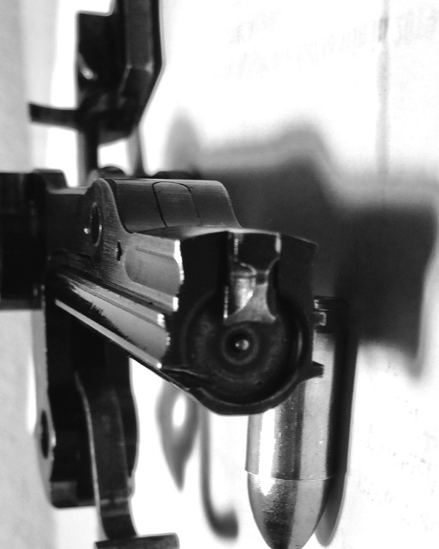

Don and Doubs,
Don -I believe you are right regarding the Remington ammo but I still wonder why, if that is the case, what's wrong with their ammo. I also checked the Ejector and can't find anything broken or excessively worn (see pic). However, I don't know what a perfect Ejector would look like. Doubs - The recoil on this P08 is strong so I don't think that's the problem.
Again, I really appreciate your inputs.

Your extractor looks to be perfect.
By "limp wristing", I mean that the shooter "gives" a little which doesn't allow the action to fully use the force of the recoil. I have a 1927 Argentine .45ACP - a clone of the 1911A1 - and the only time it has EVER jammed on me was once when I shot weak hand and limp wristed it. Lesson learned.
Below is a picture of a Luger receiver with the ejector circled. The ejector rides in a slot on the right side of the breech block and actually makes contact with the breech block due to the tension of the spring. You can actually see the ejector flex as the breech block goes forward into battery. Your ejector should look like the one in the picture below.
Many 9mm Lugers will leave a very distinctive mark on the mouth of a fired case that looks like a small triangle. No other gun will leave a mark like it.
