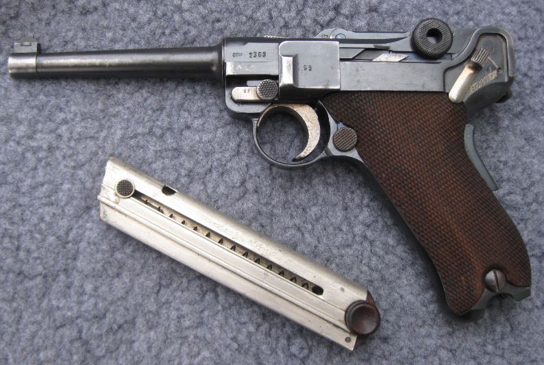

The blank bottom mag could be for a Mauser Banner Portugese GNR. I happen to be looking for one of those. If so, it would be proper for the Luger pictured below.
