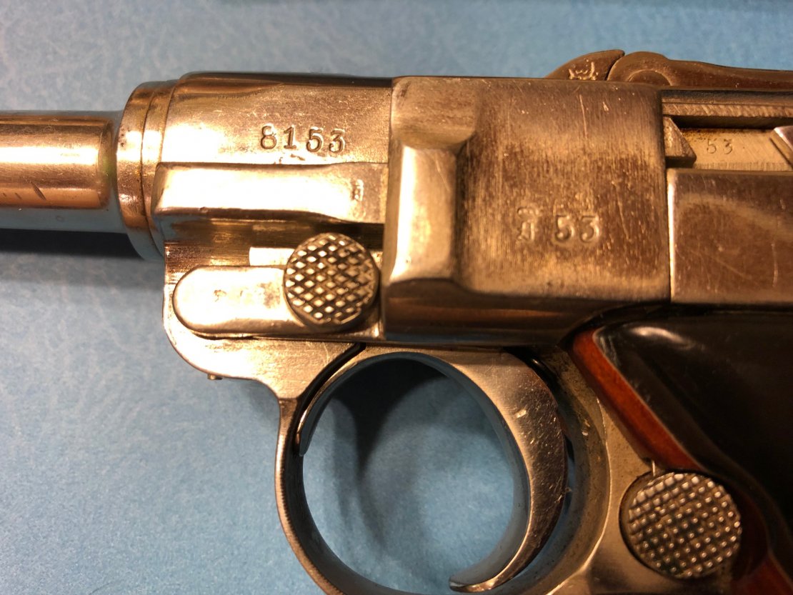

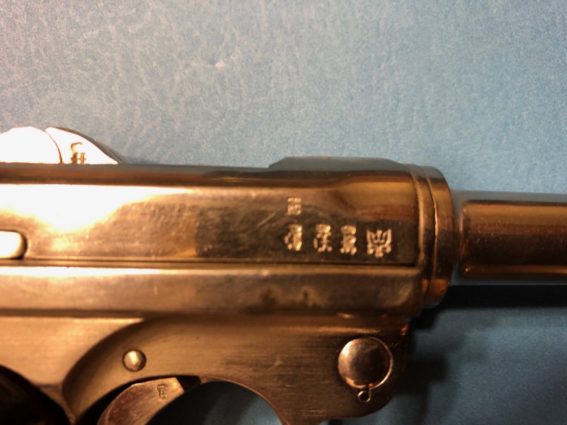

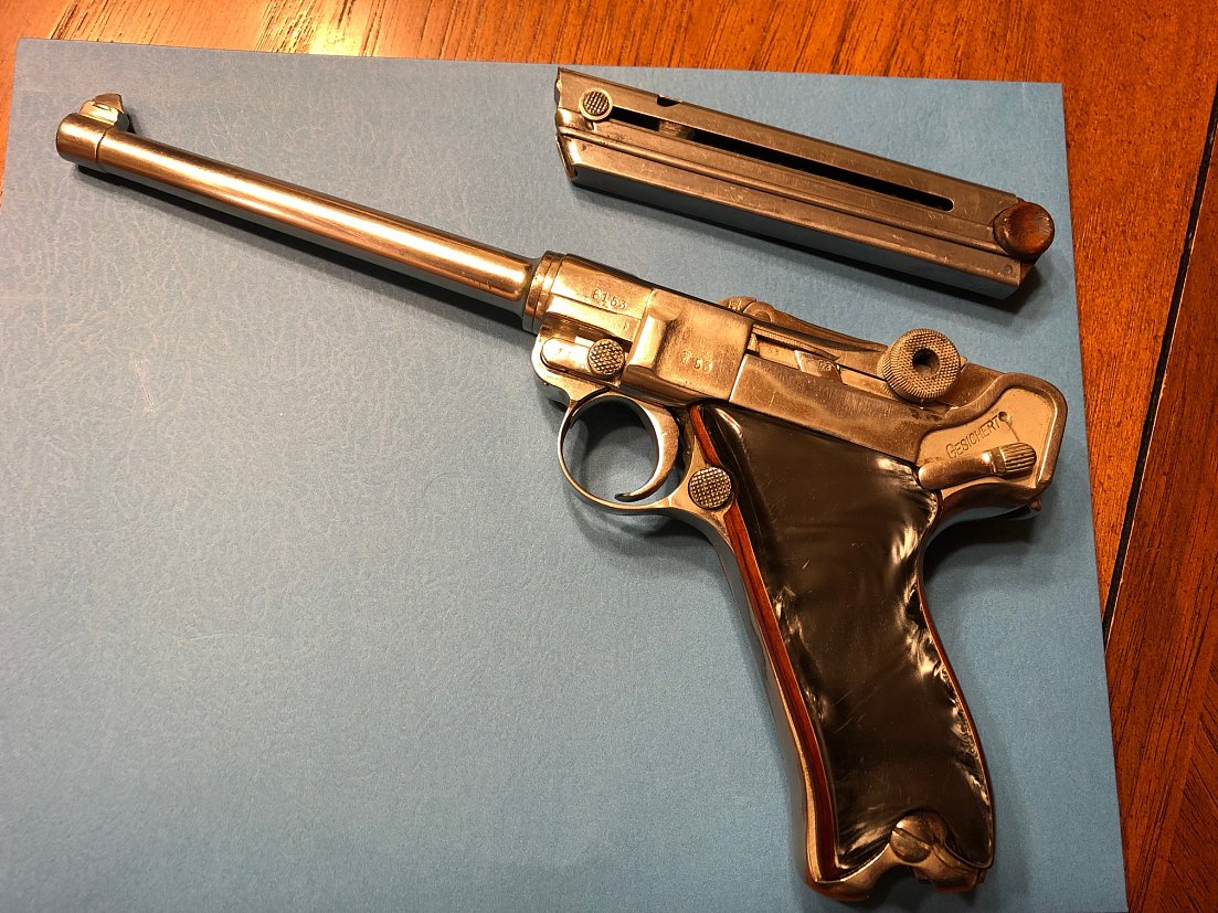

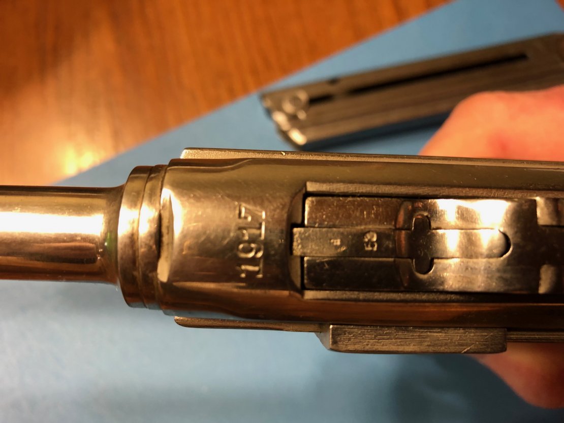

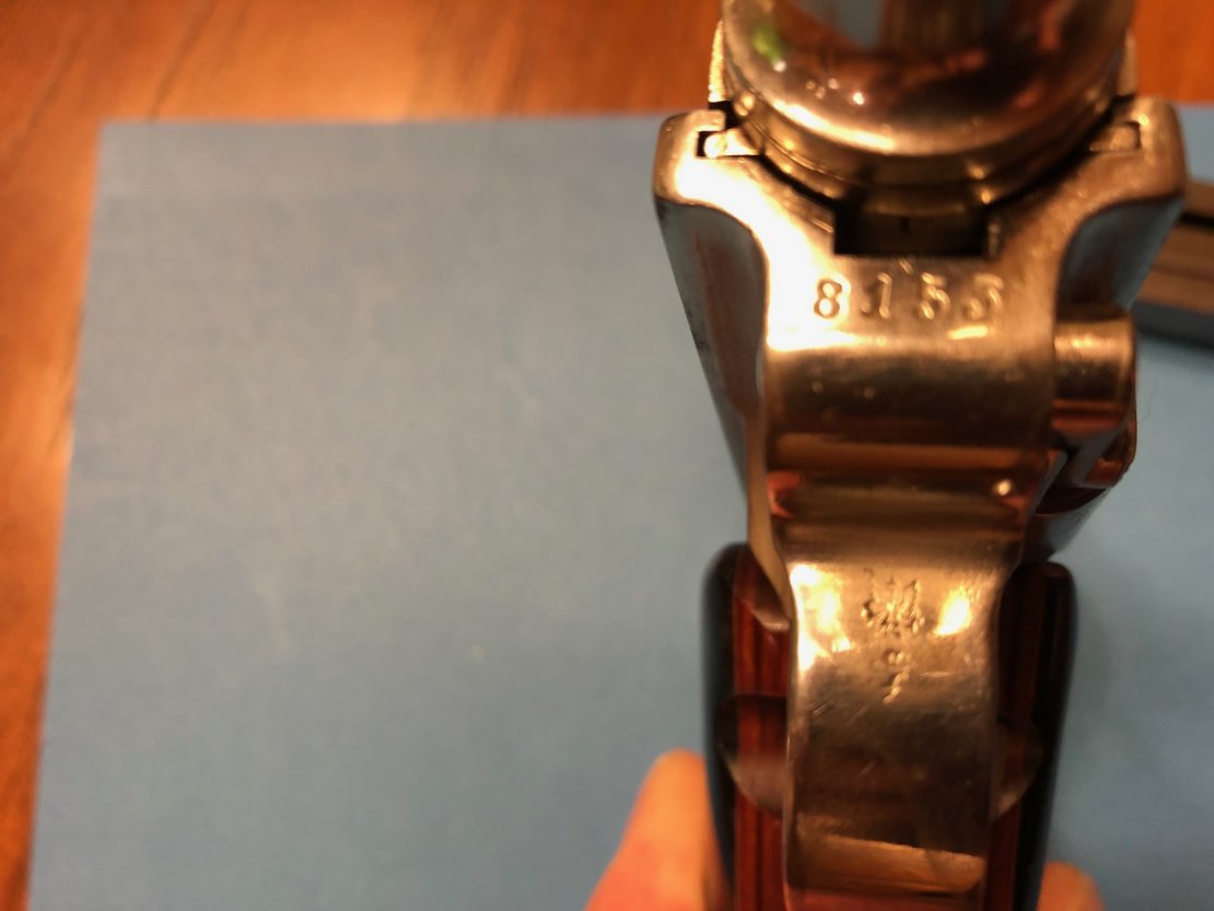

I picked up a new to me 7.65 Erfurt a few months back. I have been trying to research this one and can not quite figure it out. I can not seem to find an Erfurt with a long barrel that is 7.65. Could it have been changed to 7.65 for some reason? I am guessing a 1914 Military in 7.65? Any info would be greatly appreciated.

No Erfurt was produced in 7.65. The gun was re-barreled; probably in the 1920's.

I'll go out on a limb here and say you have a long-shank barrel (but not military spec) fitted to a short-receiver. I can see the adapter ring between the barrel flange and the receiver.
The barrel profile does not meet the military blueprint specifications/dimensions, or if so, it has been 'massaged'.
Most likely an aftermarket barrel fitted to a military [Erfurt] receiver. Barrels wear out, and get replaced.
Looks heavily buffed. Probably barrel replaced at the same time.
It's also a Revisions Commission Erfurt.

Appears that the stock lug has been removed too. Can you describe the finish, is it plated or blued?
Regardless, it should get lots of oooo's and aaaahhhh's at the range.

It is plated and a lot of fun to shoot. The grips are some my dad had laying around from a luger he had at one time. would this be considered a 1914 or 1917?

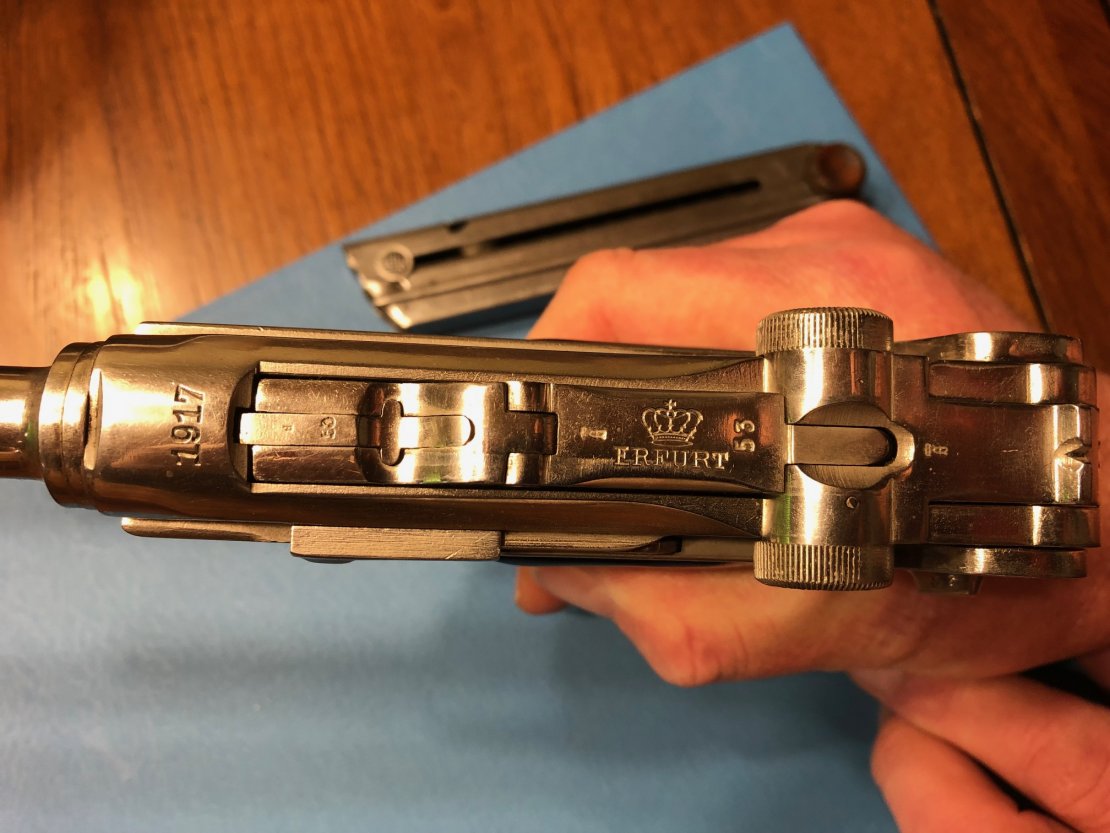

I'm not seeing anything suggesting 1914. Why do you ask?
Unread 02-20-2019, 12:53 AM   #7
It is a Model 1914 dated 1917.

It also appears that it was an artillery model in the beginning.
A functioning shooter, for $750, that you don't have to worry about decreasing collector's value? Sounds like a deal to me.

In 1917 all Erfurts had the "artillery cut".
Most did, but not all.
I have one of each; others have been reported also.

All original Erfurt Artillery models are dated 1914...True
All post 1914 Erfurt PO8s have "artillery cuts"...Not True
most have cuts but some 1916 and 1917 uppers have been observed without the cut.
I own one dated 1917 without the cut undoubtedly original.

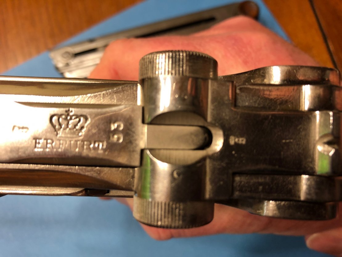

What are "artillery cuts" mentioned above?

If you look down on the gun, just forward of the date you will see a flat surface, which was milled away so that the original artillery rear sight could lie flat instead of slightly raised.
Your photos 6 & 7.
