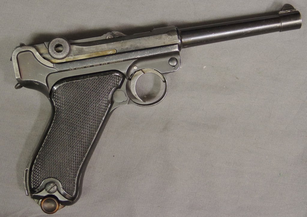

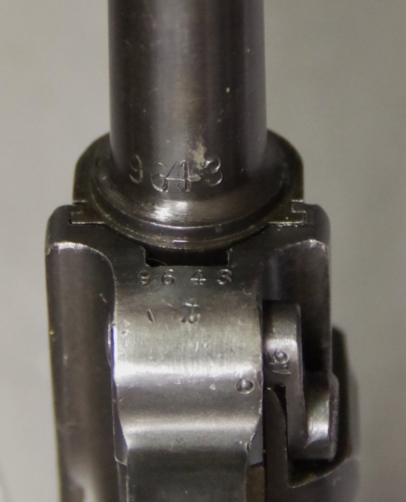

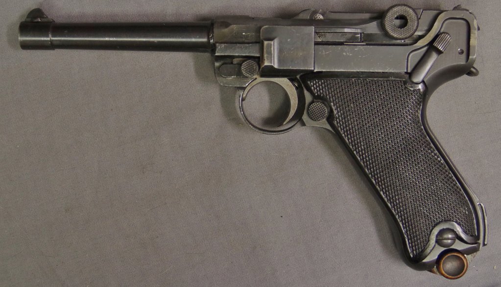

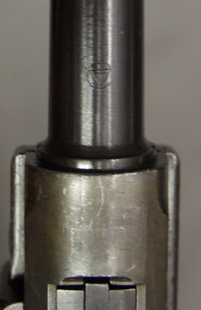

Here is my "new" Finn rig, complete with 120mm 9mm Tikka barrel(see marking on top of barrel), holster with stock straps, Finn marked originally German artillery stock, cleaning rod, and loading tool.

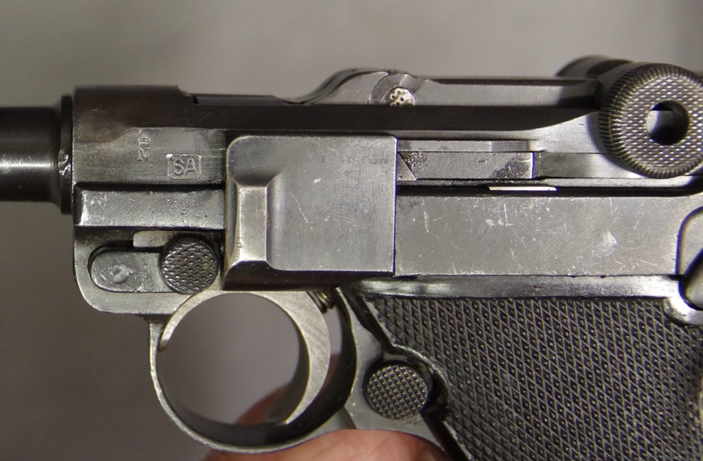

Pistol is relatively "new" after re-work, barrel and frame match by number, Side plate, take down lever, and trigger are not numbered; other small parts are not matching. Barrel is a higher polish blue, and was blued before installation(IMO), rest is a duller oxide hot blue/black. Bore is new.

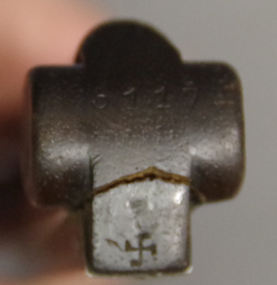

Seen here on the base of the magazine with crack(already on its way to GT for repair!).

First purchases were commercial lugers , with upright crown N
-with 98mm 7,65mm barrel
These were later rebarreled by the Finns with three different barrel types:
-100mm 9mm
-120mm 7,65mm
-120mm 9mm

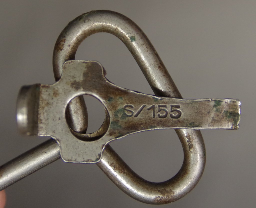

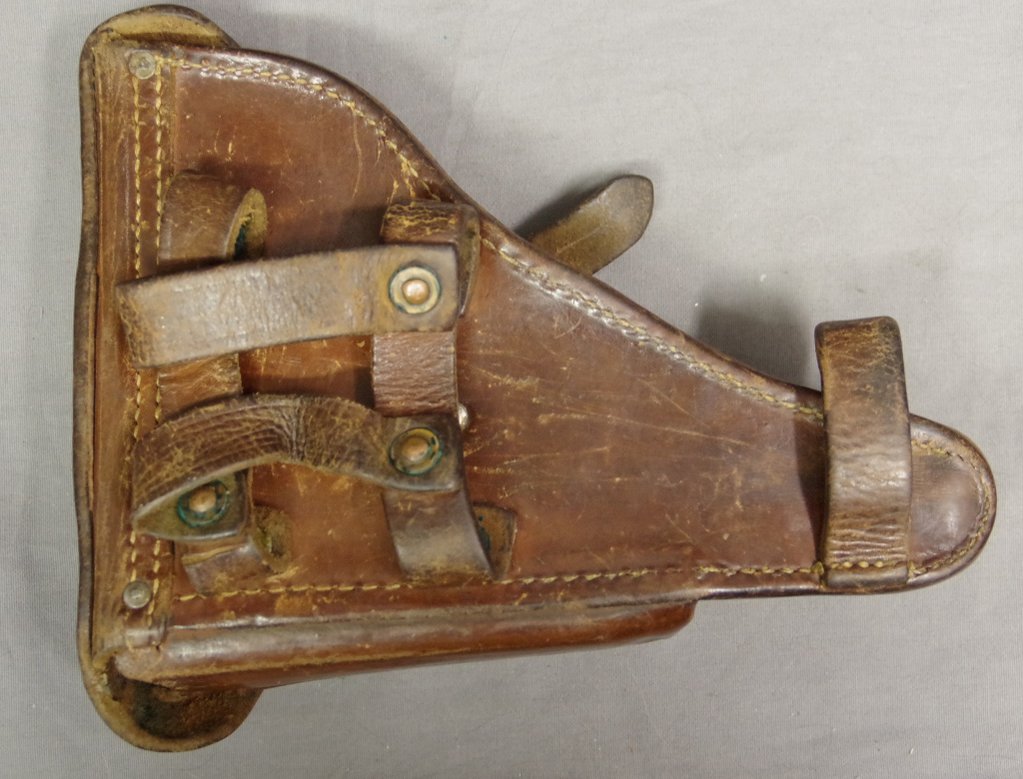

Additional pictures of Finn luger rig and tools.

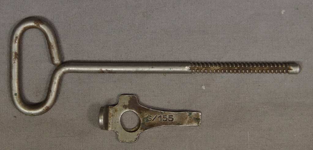

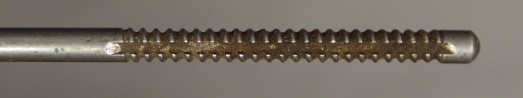

Cleaning rod is steel and unmarked, Tool marked S/155.

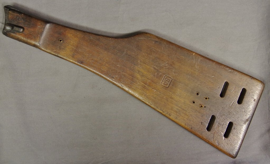

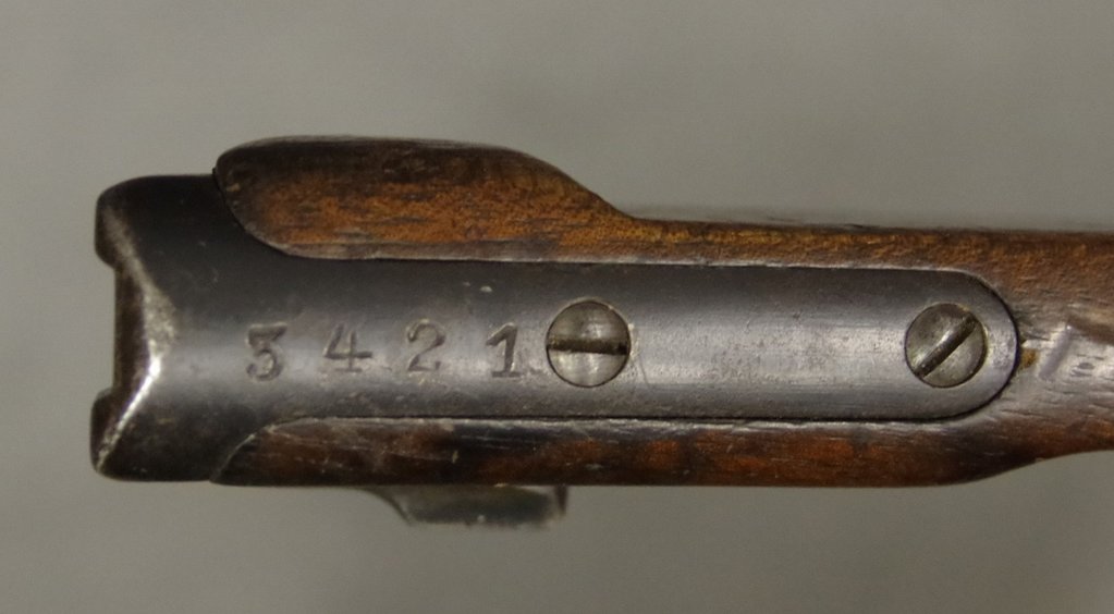

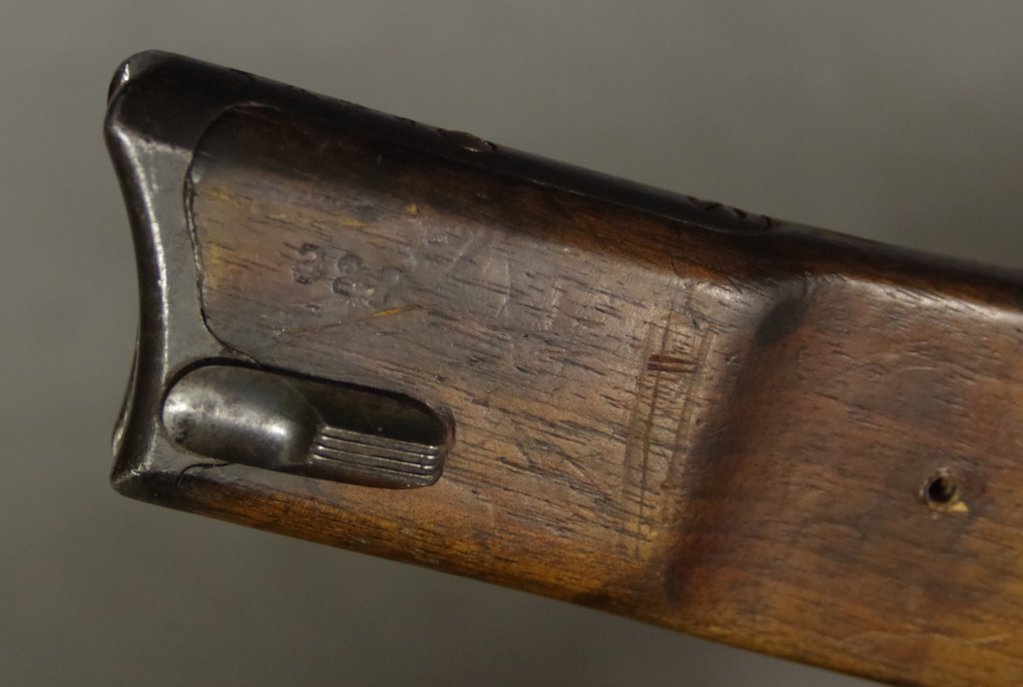

Stock iron is numbered 3421 along the long axis as opposed to smaller numbers crosswise as seen on German numbered stocks.

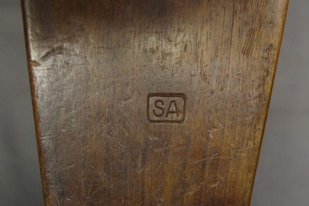

The SA in box is seen stamped into the wood. An additional smaller number "327" is stamped on the neck near the iron.

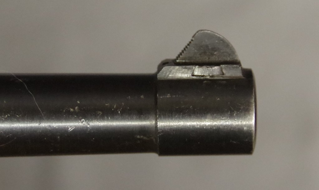

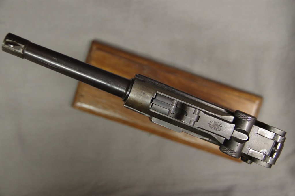

The front sight base is lower, and the sight blade taller than those found on a DWM barrel.

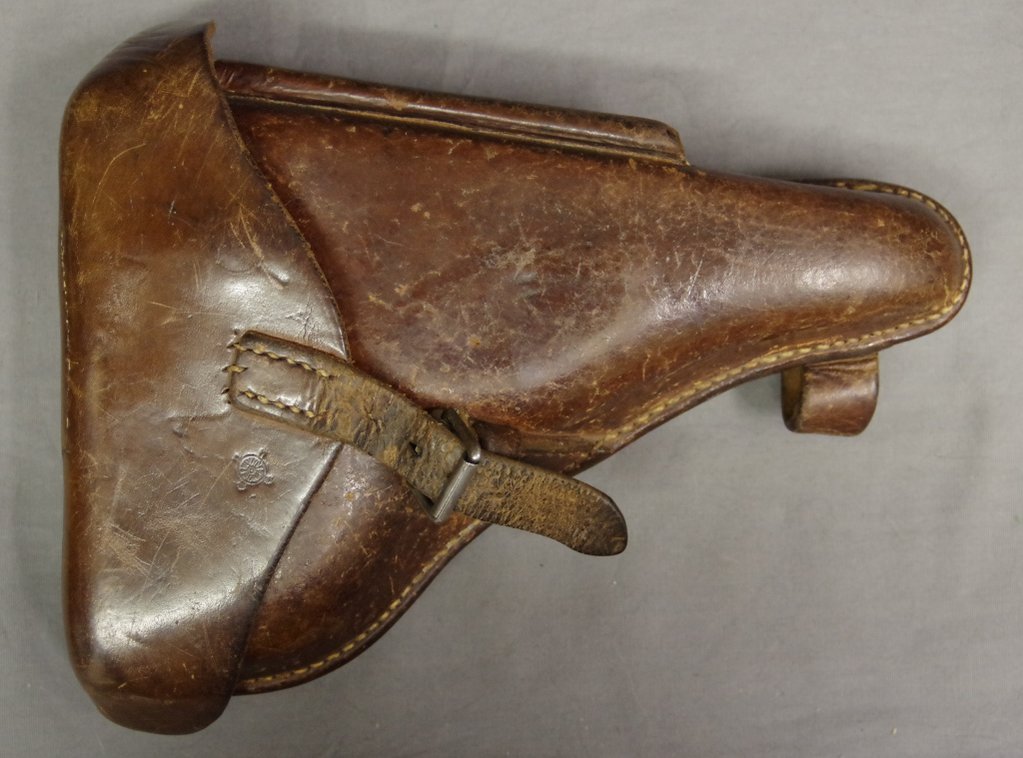

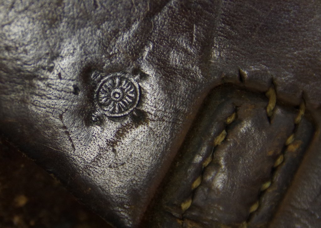

The holster has the mark stamped shown above- I am not sure what it represents. Any info welcome.

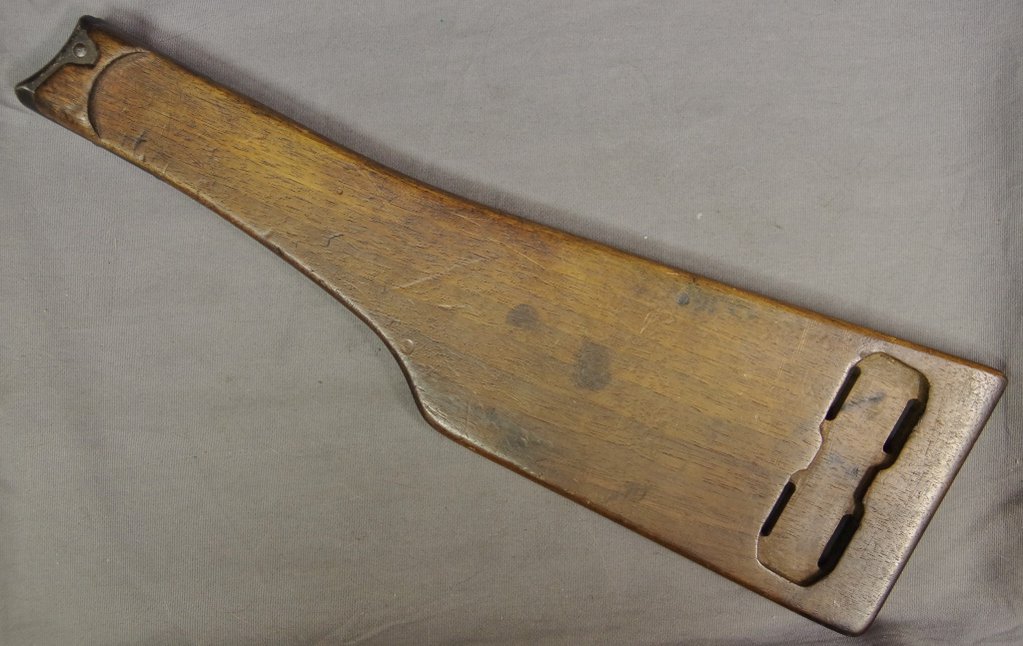

Congratulations on your new acquisition and thanks for posting those interesting photos. This is the first time I've seen the leather attached to the stock, is that the way it's supposed to go?

Thanks Norm.
Yes,
I tried it the other way 'round and it does not fit the straps as well; plus there were wear marks from the attaching latch in the leather.
The stock is removable from the holster while the holster is on the belt; and used separately from the holster- not like the German navy or artillery rig.
Unfortunately, neither number on the stock matches the pistol.
