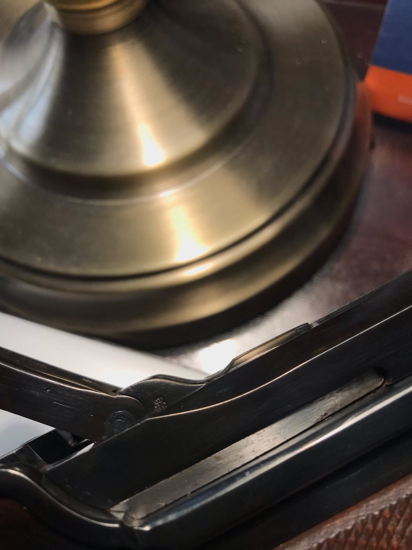

Good Morning!
I purchased this Luger for a very reasonable price and wanted to inquire with you, the Luger experts, about its markings/story behind it.
WHAT I KNOW: It is a 1918 WWI Luger, Navy, serial number 4793, from Erfurt, and has various other stamp markings which I attempted to find the meaning of with no success.
Thank you in advance for helping me out and am happy to be a part of this wonderful Luger forum.

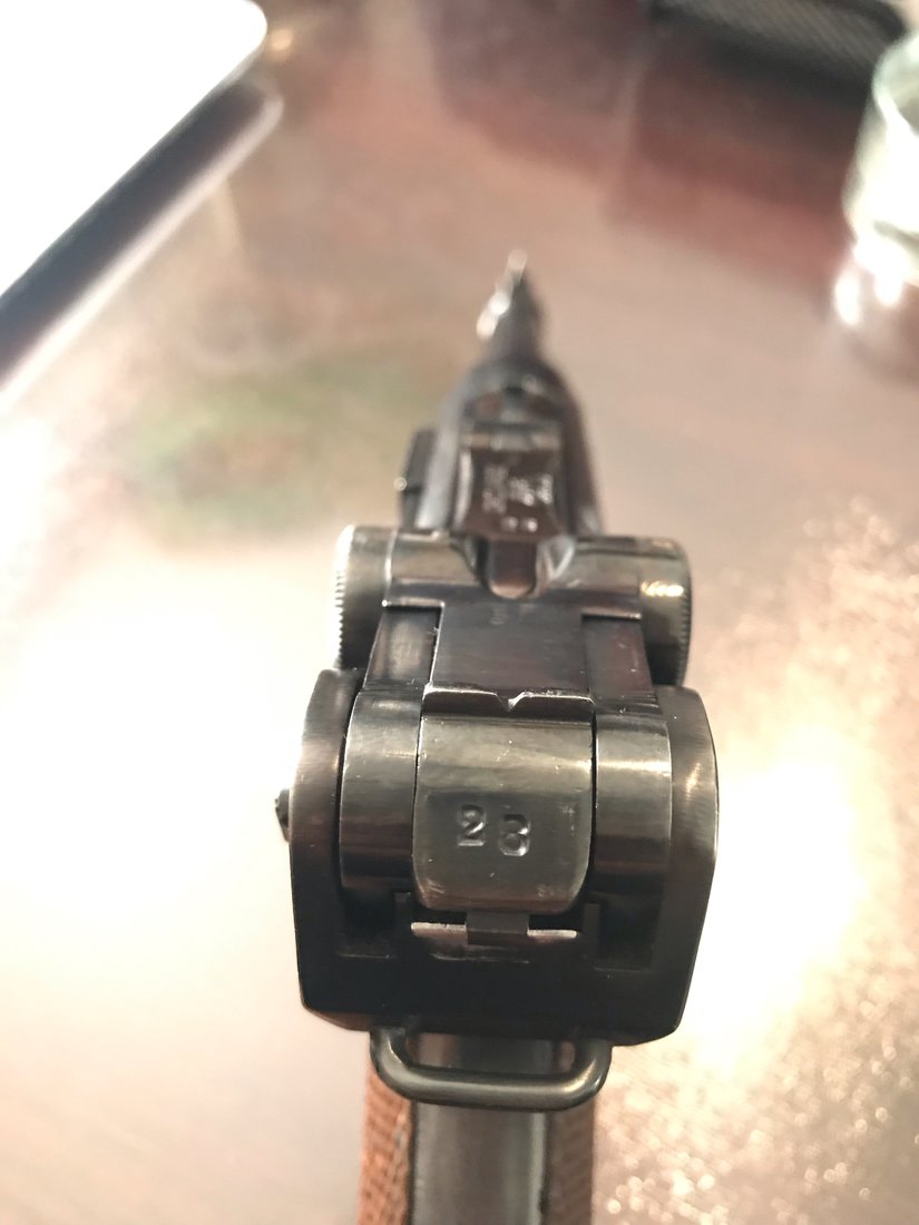

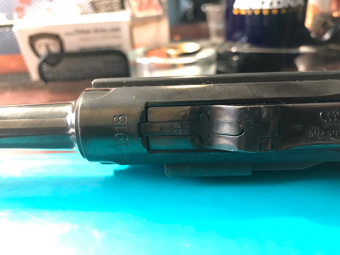

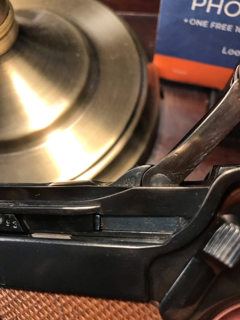

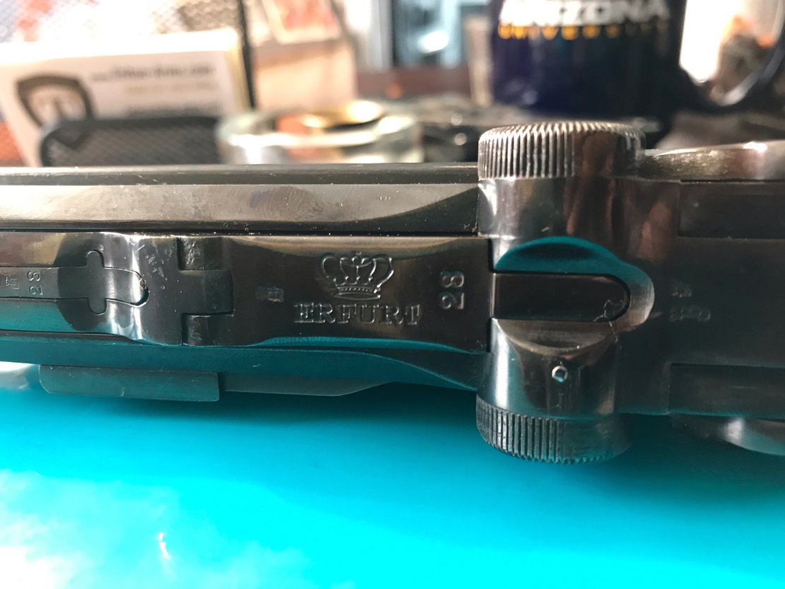

Hi Kolt,
Welcome to the forum! You have a relatively common 1918 Erfurt that appears to have been reblued in the past. What makes you think it's a Navy issued gun?

And the toggle train appears to be mismatched.

Only the toggle train is Erfurt. The pistol is a DWM.

Definitely reblued and mismatched, it appears that the entire front surface has been ground and re-numbered.

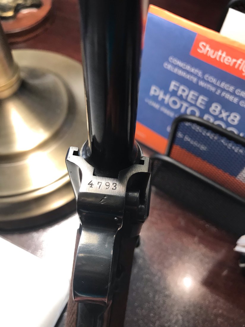

One more thing to add is that the cursive, lower case "i"is part of the serial number of the pistol -- called the letter suffix. So, the complete serial number is 4793i.

That is very interesting about the cursive 'i' being part of the serial number. That means my FFL didn't jot it down in the paperwork correctly, ithacaartist. :-/ LOL
