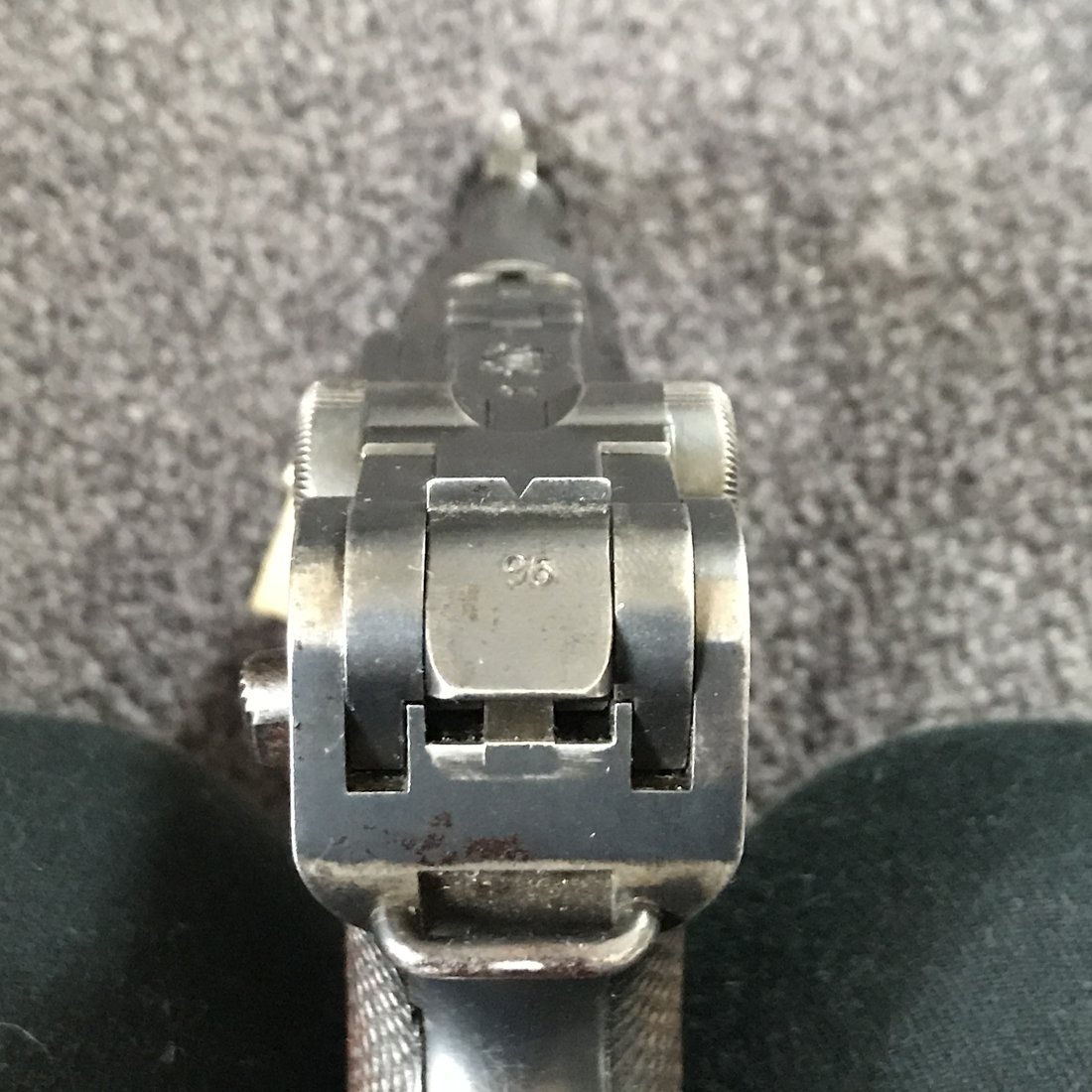

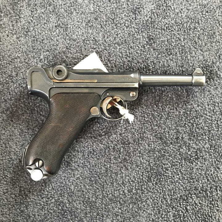

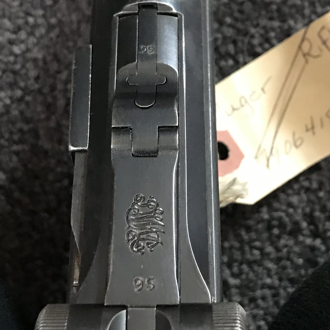

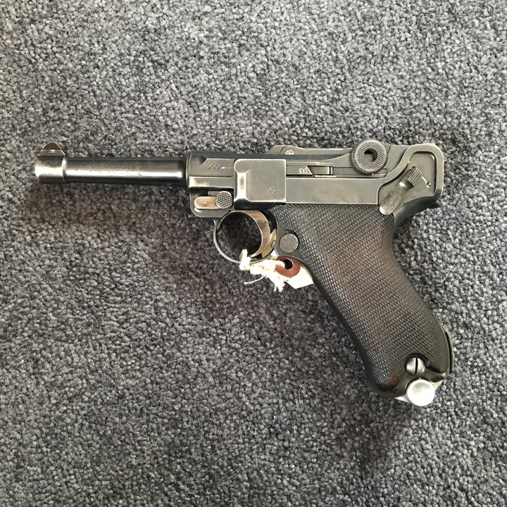

Hi everyone, I inherited several Lugers from my Dad and I'm trying to figure out what I've got here. I think this one is a 1914, and I took photos and made notes of everything I could figure out. For the rest of the information you'll need, I don't even know what I don't know yet, so please be patient with me. I can take more photos if needed.
This gun was in Canada until recently. I assume the "Germany" mark was put there when it came into Canada from Germany. It should also have a mark indicating that it came into the USA from Canada, but I haven't found that yet.
I'll post photos from my phone--give me a few minutes.
Thanks in advance for your expertise!

Default Photos
Here are some photos.

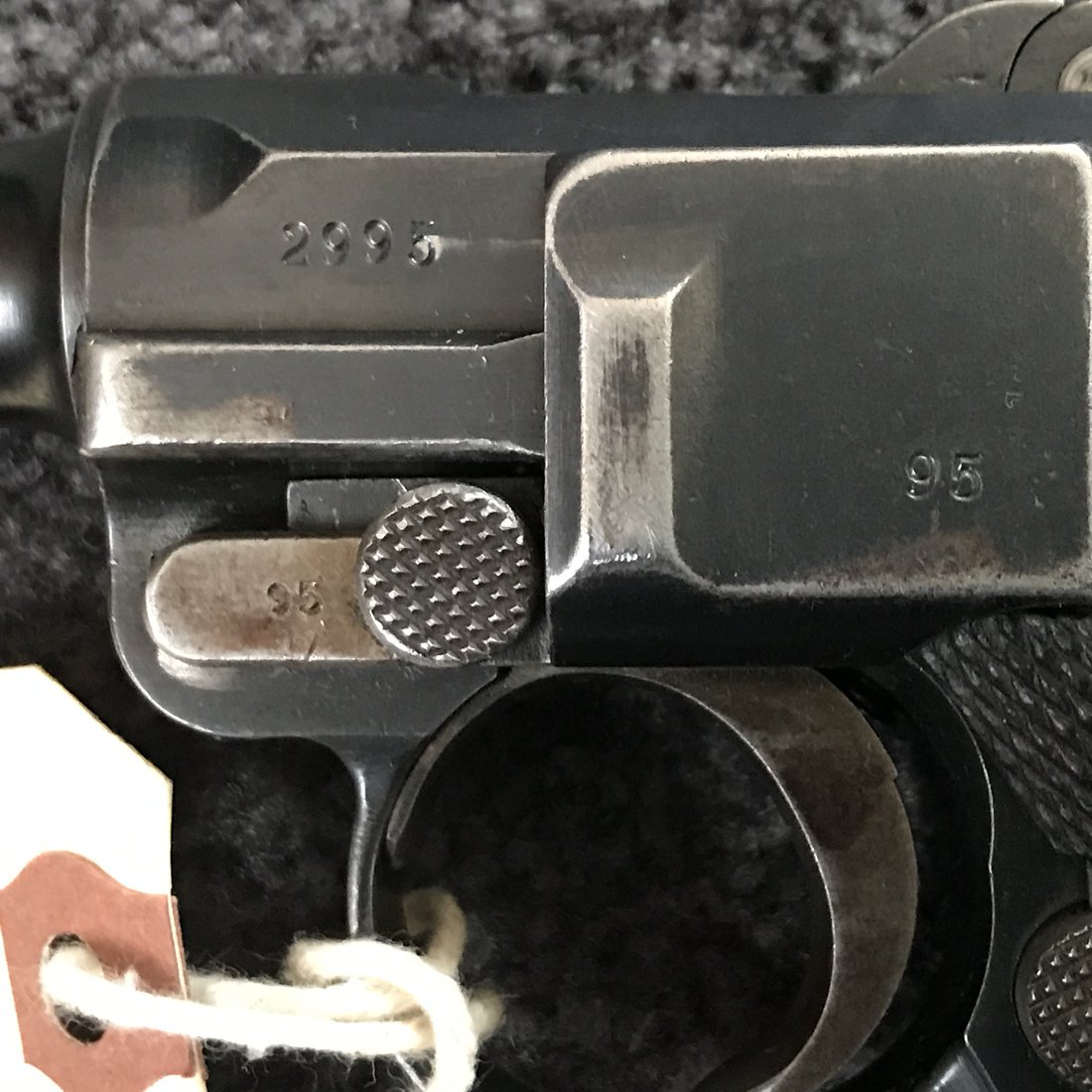

Oh--also, I should point out that as far as I can tell, all the serial numbers match except for the magazine. I need to look at my other ones and make sure they didn't get mixed up.

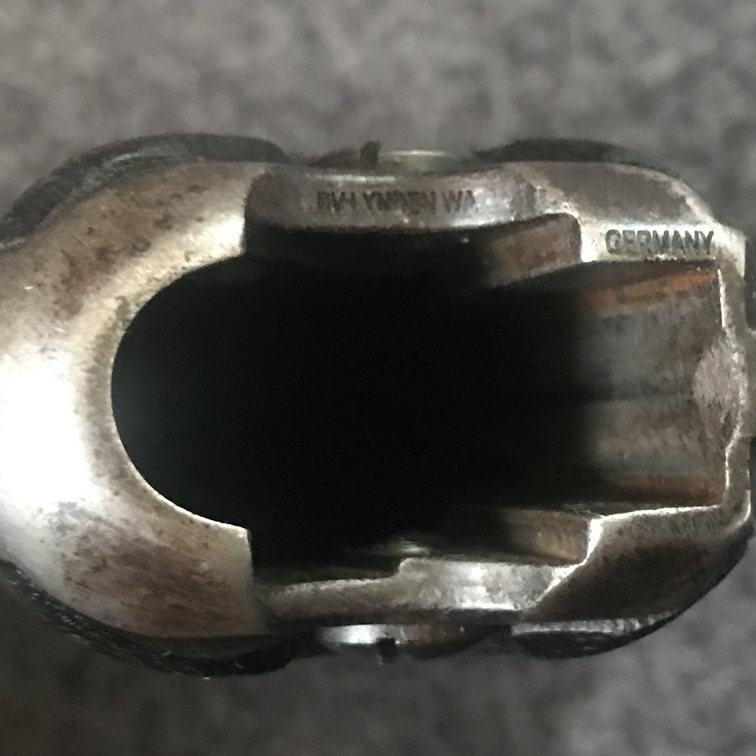

Edward Tinker, thanks. In fact, the BV in the mark is the initials of the company that did the shipping from Canada to the USA. I should have figured that out....
So--we are thinking that the "Germany" stamp is from years ago and was placed there when the gun was brought in from Germany, and the BV stamp is recent? (Just clarifying.)

An update--the importer is required to put their mark on the gun, plus information about the gun if it's not on the weapon. So it's possible that Borderview did all the marking. They might have had to put the country of manufacture and the type/caliber on there too.
If Borderview put the stamp on, I guess it's possible that this gun was not shipped commercially to Canada, that it might indeed have come in a veteran's duffel bag.
I'll check with Borderview.

Mom, From the looks of the marks I believe you are correct. The import in the curve of the mag well and Germany are bound to have been done at the same time. In all the Germany marked Luger's I have ever seen I have never seen one this small or in this area.

I just talked with Borderview and they are checking for sure but it's near-certain that all the information in the mag well (a new term for me) was put there by Borderview in 2018 when they did the export/import.

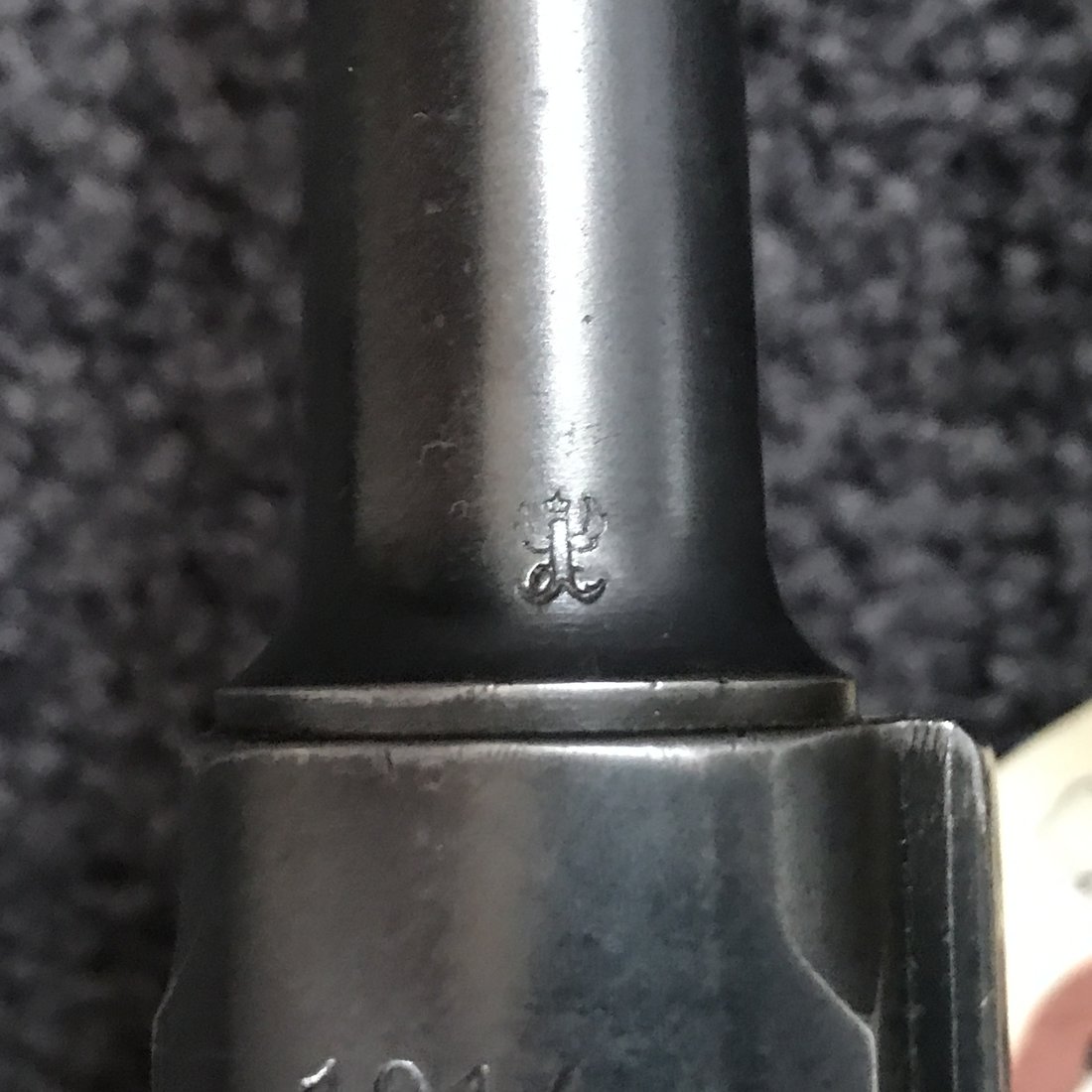

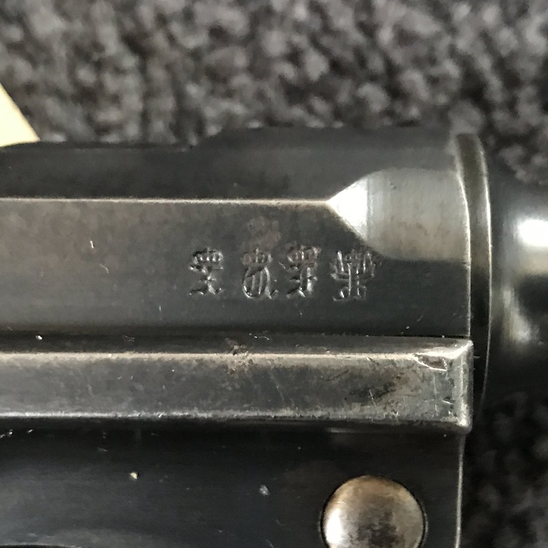

The scroll on top of the toggle is the manufacturer, Deutsch Waffen und Munitionfabriken (DWM), the smaller “inscriptions” that you see on the right side of the pistol and the one on the underside of the barrel are proof/acceptance marks from the German military.
Side note, is there a full serial number on the underside of your barrel?

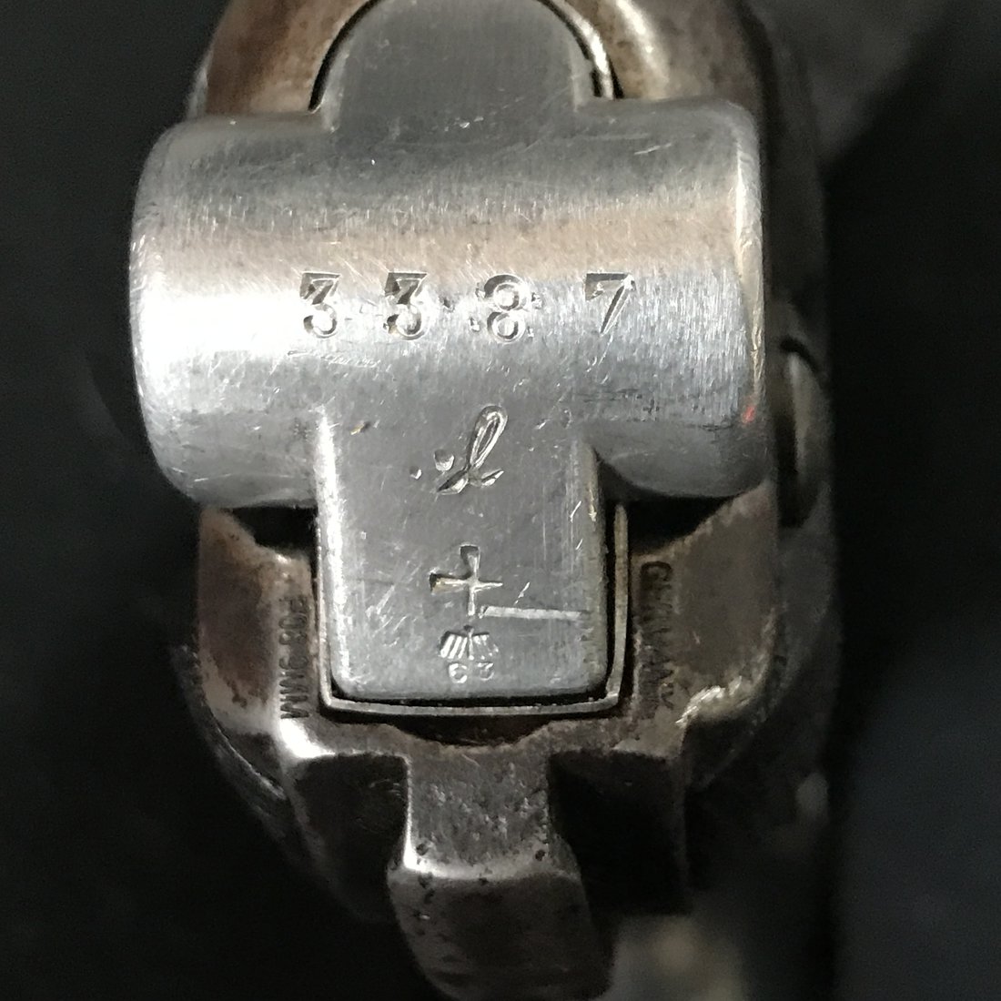

The acceptance stamp on the bottom of the magazine is a Weimar Eagle (droop eagle) over 63. It was made by / for Mauser.
I'd estimate your Luger's value with the magazine at $1600 if the Luger's numbers are, in fact, matching. There are internally numbered parts that would need to be checked, along with the inside of the grips .

It is the original barrel, or an original replacement; one can see the original DWM(Spandau) firing proof on the rear of the barrel in two of the pictures.

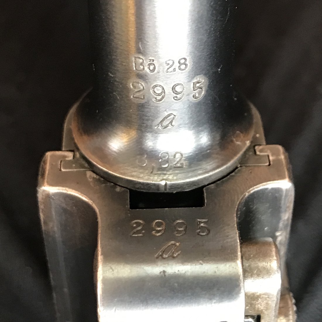

Default One more picture
Hey Pistol, I think I got the information in just one photo! Please let me know if it’s not right.
I didn’t even know there was lettering under the barrel/on the frame, so I’m excited to see what it means.

Bȍ is Bȍhler, a manufacturer of barrels. The 28 is the batch number of the steel.
2995 a is the serial number. 8,82 is the land diameter of the bore.
Very nice example.

Lugers often have a long service life. Your Luger was originally acquired by the German military during the Imperial era. As you suggest in post #7, it was most likely brought into Canada by a returning veteran of either WW-I or WW-II. Since the magazine is later, it's more likely a capture from WW-II, but don't forget that replacement magazines could come from any source at any time.
"2995a" is your Luger's legal serial number. It should have been imported with that number, and any documentation referring to it in the USA should use that number.
The use of Boehler steel barrels on DWM Lugers was discussed here several years ago:
https://luger.gunboards.com/showthre...-STEEL-BARRELS Your Luger would fall toward the end of the 1914 list reported to Jan.
One of our European based researchers ("Vlim") confirms in this thread that a close relationship existed between Boehler and DWM prior to 1928. This would imply that Loewe's DWM would be a Boehler customer for a number of supplies.
In Sturgess extensive study of the Luger on page 1055 (red edition) he indicates that DWM acquired it's barrel steel from Boehler in Vienna, and that this was used (both unmarked and around 1913 marked by batch) by DWM when they were manufacturing Lugers. I'm not sure of Sturgess' source for this detail, but since it includes process information through 1942, it was probably August Weiss.

A Bohler barrel on a DWM indicates a replacement barrel.
On the contrary, Boehler barrels are original to some 1913 and 1914 DWM P08s. They were not used as replacements.
