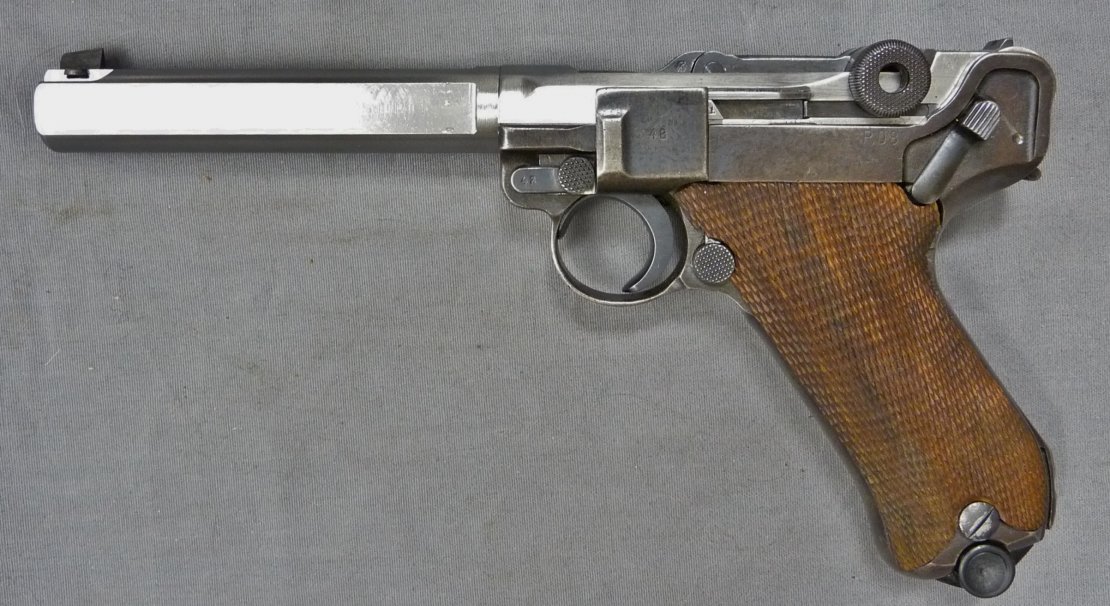

GT's sights are the same profile as the original.
Your gun, modify as much as you want!
I know about seeing those sights, ain't easy. I have a couple shooters with entirely different sights and sight pictures. Helps some but nothing will give back my vision of 50 years ago.

HI Sharp dressed! My replacement sights are as Don described them, and made as close as possible to a P.08 profile, regardless of height. The tops though, are square, or better term, flat, not rounded like the originals.. My sights are more for target then for combat?... All sizes available thru Lugerdoc… Good luck, let us know how you turn out... best to all, til….lat'r…...GT
