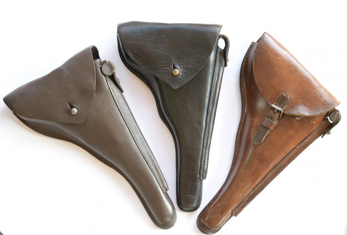

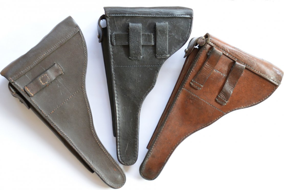

Yes, I have one. The holster on the left in the photos is a 1916 Adolph Schwartz & Co. pebble grain in it's original brown color.
I think it's standard practice in all the world's navies that when the men have nothing else to do, have them paint the ship (or dye their holsters). By 1916 they had something else to do.
Norm

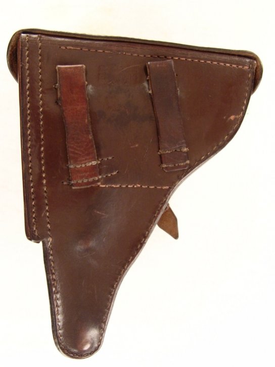

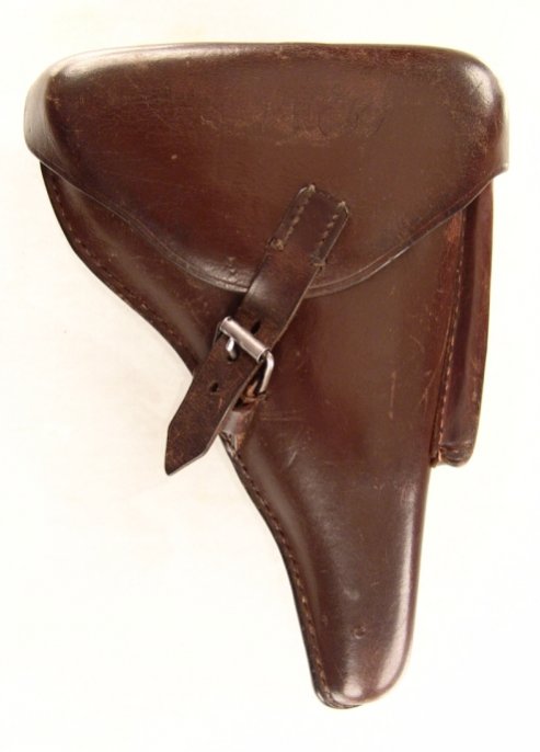

Norm,
Thanks, but I respectfully disagree with your exception.
See photos below.
Matt

Ed,
Not to disagree, but WaA18 can be found on holsters made by A. Fischer (undated), C. Pose (dated 1926), as well as Gustav Reinehardt (dated 1922).
Matt
