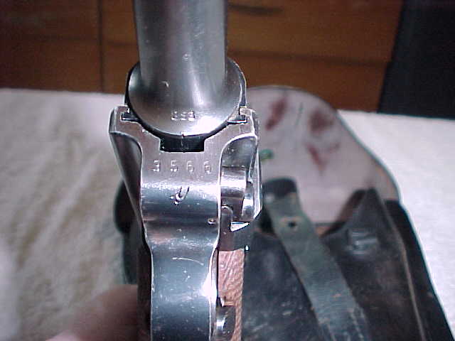

Can you post pictures? 1942 Police Banners would most likely have a "y" suffix. Is there a "y" on the front of the frame and the magazine bottoms?

Yes to y on frame, not on the mags however. Pic of frame attached.

Originally Posted by markthenav View Post
Thanks. Gun doesn't appear to be restored or refinished. The only other thing I could think of was the lower was swapped at the unit level after issue. The numbers are sequential (i.e. 1095/1096). I can think of no other explanation...
The upper and lower were "assembled" together sometime in the last 76 years, almost certainly not by any official German service organization. The liklihood of any "unit" having two consecutively numbered 42 police Lugers to confuse together is vanishingly small.
No wishful explanation will ever make this anything other than a mis-matched pistol. Manage your expectations and pay accordingly.

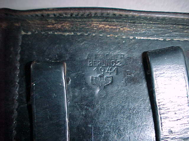

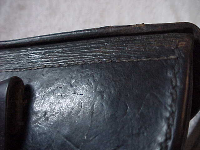

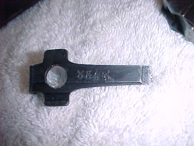

That would be unusual for a "42"; when you can please post pictures of the holster, its markings, and the tool.

Here you go. Interested in your thoughts.
Best,
Mark
