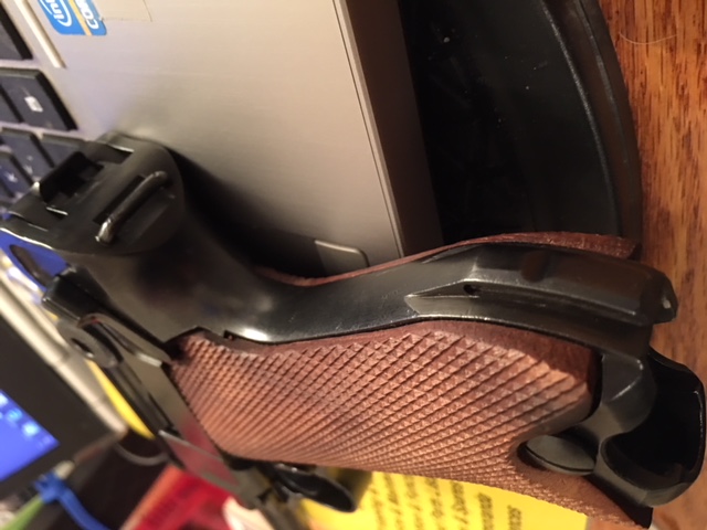

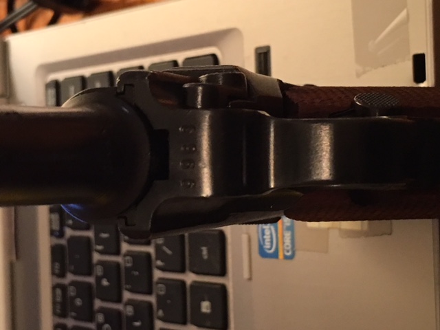

Bob, it sounds like you may have a Russian Capture or VoPo Luger. Pictures will help us help you identify it. Take pictures in sharp focus under indirect (shaded) natural sunlight without using a flash.
Those were arsenal re-fitted by workers who knew how to work with the Luger action. Of course, it might also have been "worked on" after that by parties unknown. The RC or VoPo guns have also often been dip refinished, a reduced labor process for putting on a new finish as part of the rework.
Unread 01-26-2018, 05:51 PM   #10

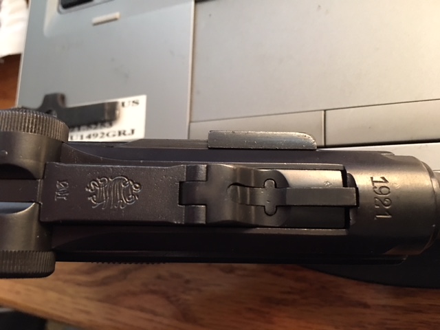

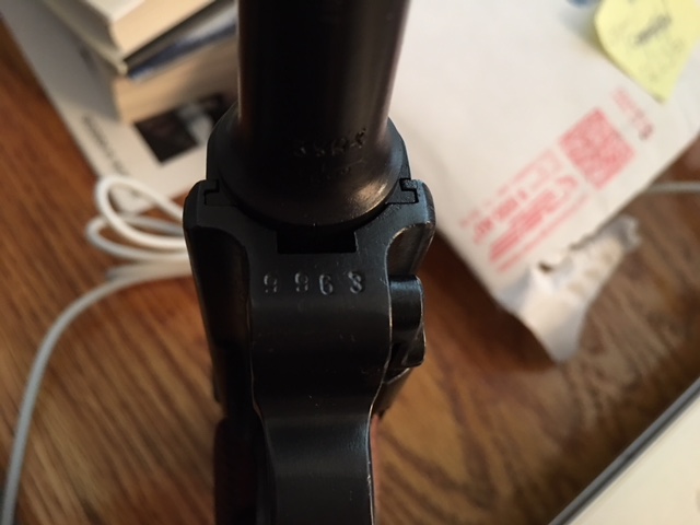

Photos attached.

The "X" is evidence that it is a Russian Capture. I can't see enough of the side plate, but I think it's a replacement.
You already have one of the best running magazines available. A "fxo" or 2/1001 marked Haenel Schmeisser milled magazine.
I can't see the frame ears profile clearly, but they may have the Hump. It could also just be the angle and background... Pix straight on please?
Start by cleaning up the sear plunger... Marc

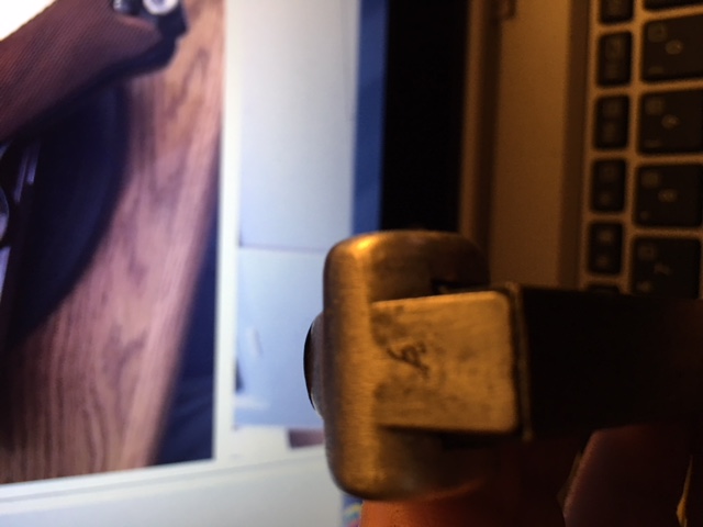

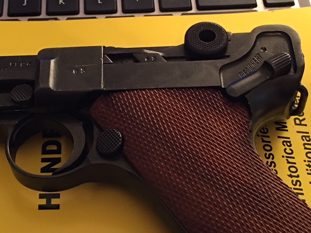

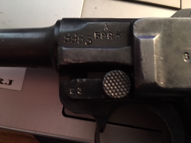

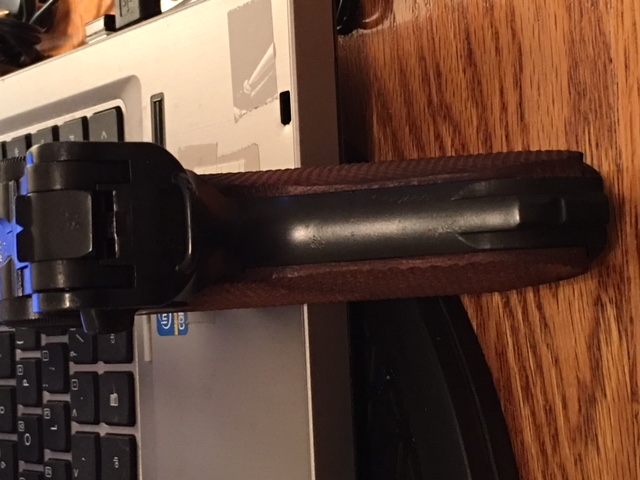

Finally. Marc, is this what you meant?

Hi Bob, these pictures unfortunately still are out of focus and the lighting doesn't help make details visible.
It looks like your frame has the Mauser hump in two of these photos. The finish also looks dip refinished.
The grips are probably post war reproduction grips from the rear profile appearance and checkering. These grips did not come from a VoPo rework, and were most likely added later.
The original serial number was scrubbed off the base of the magazine.
Any progress on the disconnector and trigger reset?
