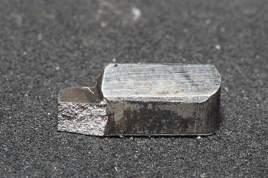

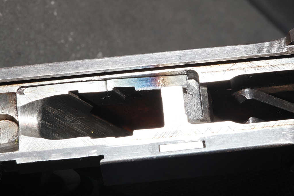

My 1918 DWM Hold Open broke today. After only 5 shots the toggle opened as usual, put some rounds on the magazine but it never went to the front again.
Dismounting the pistol found the Hold Open Latch broken in two parts...

Wow...You have a camera that takes .PDF pics???
That's the first pic of a broken hold-open that I've seen here...Crystalline fracture...Odd...

Unread 06-06-2017, 10:00 PM   #4
Rich,
why is a crystalline fracture odd?
Just what I would expect from a hardened part.
But for sure he needs a new one.
Unread 06-06-2017, 10:25 PM   #5
Rich,
You're right. I forgot that it would be hardened...CRS strikes again...

Hi Miguel and welcome to the forum. I hope that we can be of some help with resolving the problem.
Your photography is outstanding. In fact, it's some of the finest I've seen.
I expect that you came up against our file size limitation when uploading them, which is why you chose PDF format, which allows larger files. This is not necessary, and uses quite a bit of space (about 3 3/4 MB).
I've attached your photos to this post. To upload them, I resized them to 1024 pixels horizontal and applied 50% Jpeg compression. The total size is about 400Kb.
On Ammo suggestions, we always recommend standard velocity 115gn ball (full metal jacket) ammunition. Your GECO ammo might have been "NATO" power, which is loaded for machine guns and is too high a velocity.
It's possible that your recoil spring needs replacement. Check to see how hard the receiver is hitting the back of the frame by putting some masking tape there and looking for compression marks. There are several levels of coil count and thickness of the spring which yield different levels of resistance. Look at our FAQ document for details.
As Gerben mentioned, you can shoot the gun without the hold open. Just be sure to remove the broken part and it's spring before loading and firing the gun. Of course, it will close after the last cartridge is fired.
The replacement hold-open part and spring will probably require some hand fitting.
Can anyone with a metallurgy background comment on this part failure? It looks from the photos like the heat treating may have been uneven (note the fire blue color which fades before the right angle that failed).
Thanks Marc, I used a Macro lens and a 21 Mpix camera, as a photo enthusiast it's my duty to make detailed photos
I used the Geco 124 gr because they are the available on the market, now I see that they are used for IPSC and maybe they are too strong for my old P08. Now I am seraching for the Winchester 115ge, 363 m/s velocity.
Anyway, I don't understand how a strong ammo can break the hold open, because if the ammo is strong and the recoil spring is old and weak, the velocity of the breech going to the front, to hit the hold open couldn't be bigger than with a weak ammo and /or a strong recoil spring, don't you think?
If my logic is correct, the break has no relation with the ammo nor the weak spring but maybe weak or defective HO
In some 20 odd years I've seen some 4 holdopen fail. So they do break. I've used Geco ammo and I don't think they are too stong. At least not compared to our old INDEP ammo.
I genereally remove the holdopen when shooting matches, just to be on the safe side.

Wow! 4 in 20 years; that is one every five years and in a real shooting environment.
I probably lose one every five years; seems I lose or "misplace" a part every day-though sometimes I find it later in the strangest places.
Seriously, every thing breaks sooner or later; however, I don't see the "power" of the round having any real effect on the hold open.
Mind that none of them were mine. It happened to different people throughout those years.
And yes, nothing lasts forever if it's being used. Don't believe the holdopen breakage is ammo related. It simply gets slammed every time the magazine is empty. That's 14 times in one single match.
