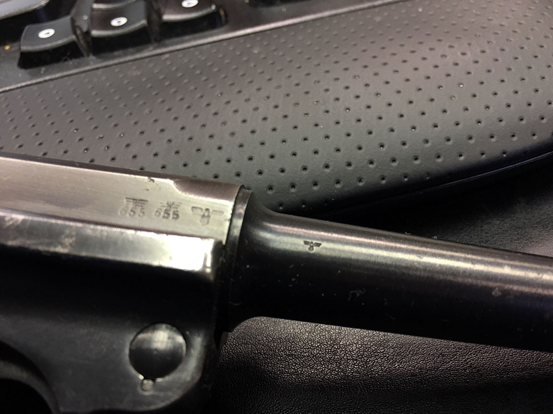

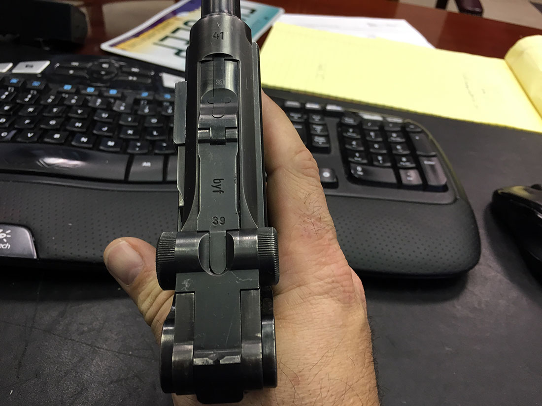

ok so it happened again. I got the opportunity to pickup this little gem from a man who's owned it a lot longer than I've been alive but Im having trouble with this one as it's marked a 41 and not the traditional 42's that I come across very often.
Any help with anything about it would be very helpful to me.
all numbers matching with mismatched steel mag Serial 7339 M
Marked 41
P 08
BYF
No unit marking I can find

Your Luger looks all correct to me. The byf code started in early 1941 and continued into 1942. The suffix happens to be a "u". There were no 41 byf's with a "m" suffix.

That's because they switched to BYF code in 1941, so yours is a 1941 BYF (mauser) luger.

I agree. From what I can see, it looks like a good byf 41. As long as it's all matching, and If price is right, I'd buy it.
