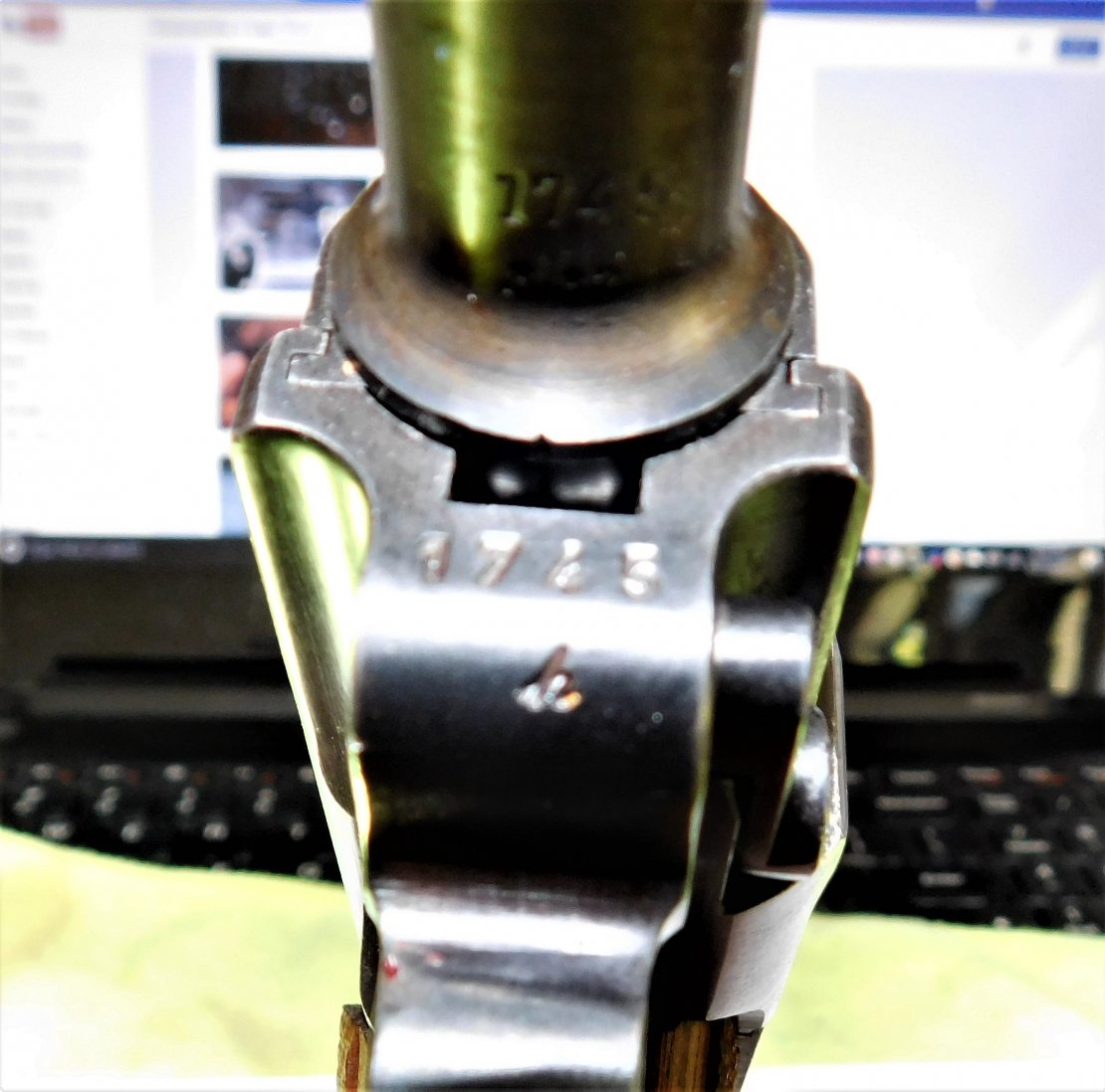

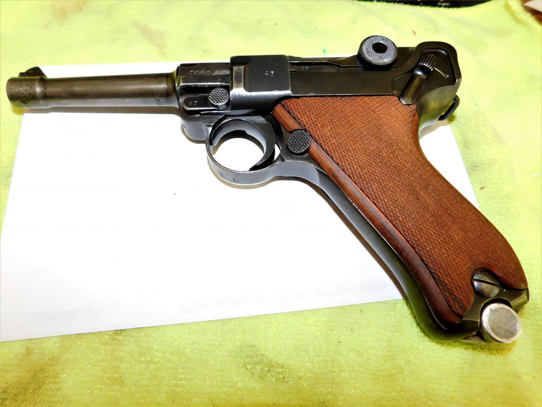

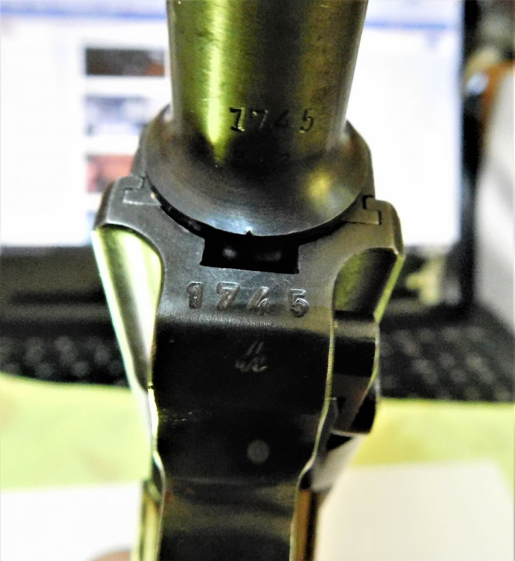

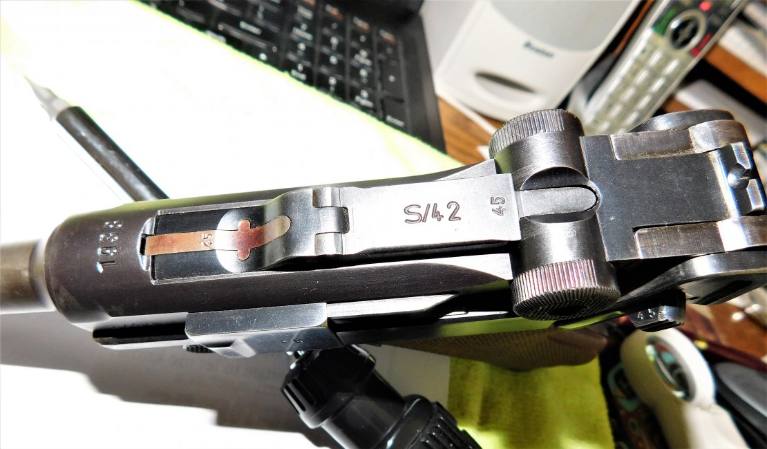

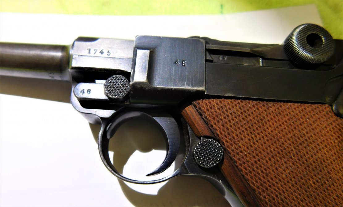

So today my package same, the FedEx guy got my signature and I got my Luger! My first.
Here are the details:
Purchased from Simpsons.
S/42 Marked 1938 on the slide.
Serial # is 1745 and on the front of the frame it's marked
1745
h (in script)
All parts match (I've had it apart)
Bore is good.
Mag is not original (need another mag)
Bluing is about 80%
A bit of light marking/pitting on the left side of the sight "band"
A loose safety....it's a bit too easy to manipulate
And I cannot find an import mark....so should I assume it came into the country before 1968?
Haven't had it to the range yet but hope to get there Sunday.
Here's some pictures.
All comments, information, whatever would be greatly appreciated. I paid around $1200 for it...was that a fair price?

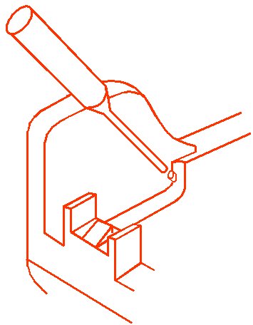

Before you start bending the safety lever, take it out and clean/scrub the underside of it (you'll have to take it out if you decide to bend it anyway). You'll need to drive out the pin from inside the frame, after disassembling it. I use a brass brush and I found that a glob of gunk was lifting the safety up slightly, just enough so the the nub wouldn't seat in the depression. After reassembly, mine worked fine - no bending required (a chancy procedure IMO).
Unread 05-27-2017, 07:31 PM   #4
...You'll need to drive out the pin from inside the frame...
From the top not the bottom!!
Unread 05-27-2017, 09:20 PM   #5
Wow! That's pretty! You been practicing???
Unread 05-28-2017, 12:33 AM   #6
Posts: 2,674
Thanks: 3,245
The grips are not original. They appear to be Swiss. What do the grip straps look like? Can't tell from the pictures. Should make a great shooter. Glad you got one. Enjoy. Bill
Unread 05-28-2017, 12:47 AM   #7
A number of years ago I was contacted by an individual that was trying to remove the safety lever. I attempted to explain in writing how to remove the pin. He couldn't grasp what I was talking about and proceeded to grind away on the frame at the top so that he could drive the pin out from the bottom. I repeated the instructions. He told me he ground some more and still couldn't get it out! I then drew that picture for him...never heard from him again. I have been hanging on to that illustration ever since then and have posted it a couple of times when the topic came up.
