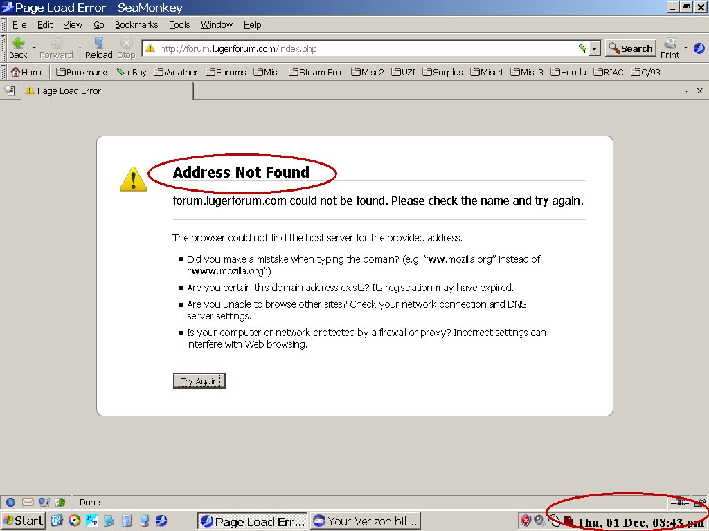

Default 'Address Not Found' Problem
John, I have noticed this past week that Lugerforum has been 'unavailable' several times per day. I mentioned this to an administrator who said he had not noticed any 'unavailable' outages.

Originally Posted by John D. View Post
Anyway - I was thinking....
I might actually move this forum to a different server (one that is running under a different OS and SSDs - and see what happens??
Well...Can it get worse???
Unread 12-01-2016, 09:52 PM   #10
John D.
Administrator
& Site Owner
Posts: 2,651
Thanks: 478
Of course it could be worse.....
Looking on the bright side - you were able to find it to post this "Not Found" image...???
Let's see what happens after this weekend, as I'll be resetting a number of things - including all the routers, circuits and such...
After that - let's see what happens, OK? I find it strange that, on my end - I see absolutely no outages on anything? I'm just wondering if something isn't pointing to your old DNS with your new ISP? Anyway - we'll get it figured out, OK?
It seems if I wait a minute or two and try again, sometimes 3 or 4 times, I finally get through...
Anything is possible...But this is not a new occurrence; I've mentioned it before...and posted that Not Found error msg...

Unread 12-01-2016, 10:04 PM   #13
Rich,
That looks like a DNS name resolution problem.
A likely cause is difficulty getting through to the domain name server that translates the canonical name "forum.luger.com" into the numeric IP address.
On home systems, the access to DNS varies quite a bit. Dialup depends on DNS servers back at the ISP. Most ISPs provide a DNS that is at an address nearby on their network. This IP address is sent to your Cable Modem or DSL Gateway so that devices inside your home can make DNS requests closeby on the network. Some gateway routers cache prior DNS requests, and try and run their own internal DNS server for your home, only referring to the ISP's server when they have to.
Things can go missing on the network, and things can get out of sync.
There is room to configure more than one DNS on your workstation. It's done in the network definitions either on a workstation by workstation basis, or within the configuration of your gateway router itself. If you want to add an alternative that is not on your ISP's network, try "8.8.8.8' which is a Dns server provided by Google.

John D.
Administrator
& Site Owner
Posts: 2,651
Thanks: 478
Thanks Marc,
It most probably is the DNS settings which is why I asked him to try it off his cell network - but - it could also be a few other issues as well...
Actually Google truncates the SOA TTL and tries to pull a refresh on the FQDNS (which I host both, btw ) before TTLs, which can create their own issues. A much better option is OpenDNS (208.67.222.222 and 208.67.220.220), FWIW...

Unread 12-01-2016, 10:29 PM   #17
John D.
Administrator
& Site Owner
Posts: 2,651
Thanks: 478
OK - here is where I am... I looked at the connection logs from my servers to your connection...
Marc is right on - you have a bad config either in your home router or your Windows config (sorry - I don't know which, as you have a firewall in place in your circuit).
So - what's happening - is when you "Open" the site - one of your programmed DNS servers doesn't reply - so it tries to go look for the other... Before THAT can reply, your browser times out - throwing up that error "Not Found". I can't figure out if your ISP has Round-Robin configured correctly, but - there is no hand-off..?
Anyway - you can fix it - but, seeing your Avatar I'm not sure how far you want Marc and I to walk you through it??
John D.
Unread 12-01-2016, 11:07 PM   #18
Marc is right on - you have a bad config either in your home router or your Windows config...
Then it must be my Windows config...The ISP & modem only came into play last Wednesday...
And did this site open without an issue from this IP/connection?
John D.
Yes.
How to fix? (New avatar coming up!)...
BTW: My Windows firewall is OFF, part of the instructions from the new ISP for the DSL modem...
