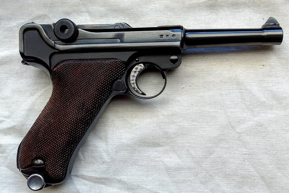

Hey all, finally can say I've joined the Luger club! I was out on a work trip and found a Luger at a local shop, and just couldn't pass it up so it followed me home. I've been wanting a P08 shooter for more years than I can count, and this one seemed in very good mechanical condition, and the price was not too bad. kind of a mixed bag of parts but I want one to shoot, not collect, so that works perfectly fine for me. The barrel/upper rails seem to go together, but the grip frame is a different number, as is the toggle section.

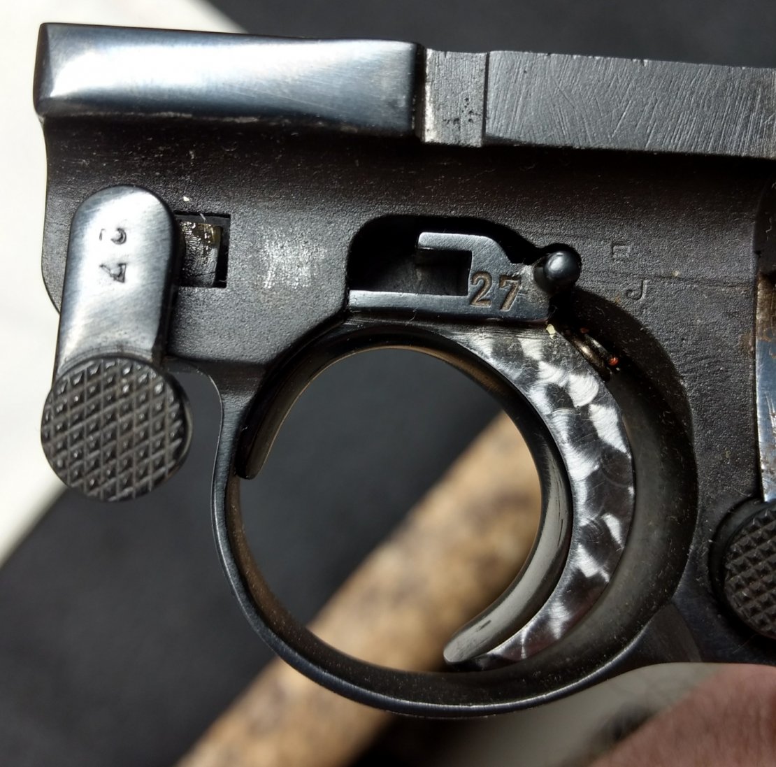

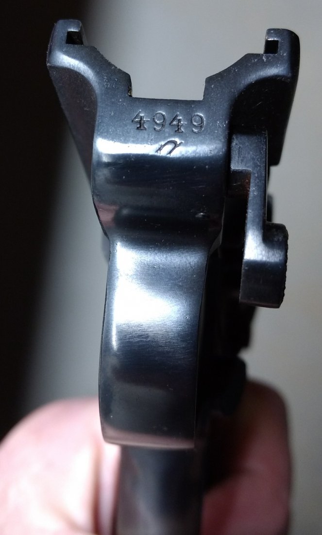

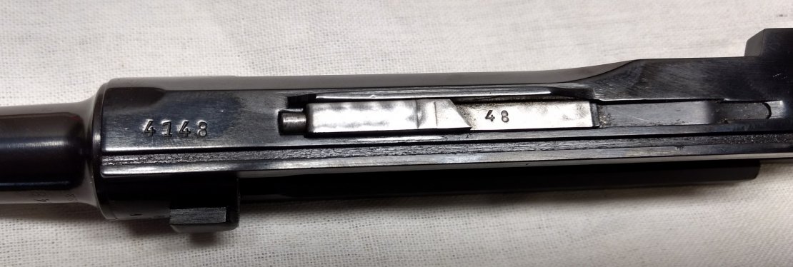

Hopefully the pro's here can tell me a little about this one. The bore is in great shape, I would think it was rebarreled when it was refinished, but the barrel numbers match the upper receiver. There's an F and J stamped on the bottom of the upper receiver, as well as on the grip frame under the side plate. Any idea what those represent? I also found an E stamped inside the back of the grip frame. Lots of old grease in there, took a good cleaning but it's in pretty good shape.
Took it to the range and shot about 180 rounds. It had a few FTL and FTE, all with Sig 115gr ammo. A couple FThold open with the original mag, I had two MecGar's that worked perfectly. Ran great on Win white box and American Eagle ammo. Overall functioned acceptably well. It shoots dead on to sights, but I think I need better prescription glasses to even see these sights!
Two questions though. First, is without the toggles locked back, I cannot load a full mag. It will not push up far enough to lock in place, and seriously drags the action to the point it won't cycle. Is this normal? 7 rounds or less it goes in perfectly every time, only with 8 is it an issue.
Second is that a couple times after I've reassembled the gun, when trying to cycle the action the breach block will retract about 1/4" and then stop, like it's mechanical binding. I can't tell at all what it's catching on, or what I'm doing differently when I reassemble it and it works. Odd, need some investigation.
Very cool and fun pistol, and probably the one I've looked forward to owning the most and for the longest time!

Welcome to the Club. The initials you refer to are inspectors initials put there during manufacture. The barrel appears to be original. The gun has been buffed and reblued. But for a shooter fine. The witness marks appear to be a little off. The barrel was probably removed during the rehab. You might want to have the headspace checked. I am not sure what your problem is on Assembly. Are you getting the lever on the rear toggle correctly placed on the spring each time? I do not use Eagle ammo. My experience with it is awful. I do like the Win. white box. Anyway Welcome and enjoy. Just remember it is habit forming and you will be getting another. Bill

I see a Mauser (code 42) made in 1938
It's possible I didn't get the hook in right, but I did think I made sure to pay close attention to that when reassembling the gun. I'll try it a few more times and see if it happens again.
So since this gun has the same inspector initials on the upper and grip frame, even though they both have different serial numbers, is it feasible that this could be the upper and grip frame that was originally put together? Would this be one of the guns factory assembled from the parts bins? There's plenty of other numbers in there, but it would be nice to know at least the grip frame, upper and barrel went through life together.

The inspectors initials have nothing to do with just one luger. These inspectors looked at thousands of lugers. So no connection just because they are the same. It was never mismatched at the factory. Bill

JMO it looks like a very nice shooter grade LUGER.
As usual in these cases I add to avoid heavy loads.
Enjoy yourself, go to the range and crank it out!

That's just what I thought when I found it. There's virtually no wear on the parts, great barrel condition, not a collector's piece so no worry's about shooting it out. It does seem a little odd for a gun that old to have somewhat fresh blueing and really look fairly new, but it does look good in person. Cost me $750, which I think is not too bad for the condition it's in, and I didn't have to spend any time hunting one down. It found me!
