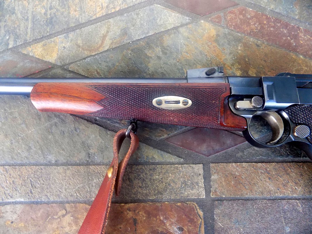

Default Carbine Repair~
Last year while pushing in the attachment clip, the grip broke in 3 sharp pieces~ My hero returned it to perfect!!

Unread 08-13-2017, 03:29 PM   #15
G.T.
Location: Chandler Arizona
Posts: 3,541
Thanks: 1,342
Default Hi Eric!
I don't believe I'm responsible for that repair?... I think you might have me confused for Jim Solomon (sp.?) or Don Voigt? Orrrr, maybe even Hugh?.... Orrrr, Olle??? Orrrrr, Rich or Rick! Orrrr Mike? Orrrr ?
This forum is truly blessed with talent! I make up for that with stubbornness!!!
If most of you were to see my shop, you'd bust out laughing! ... best to all, til....lat'r....GT

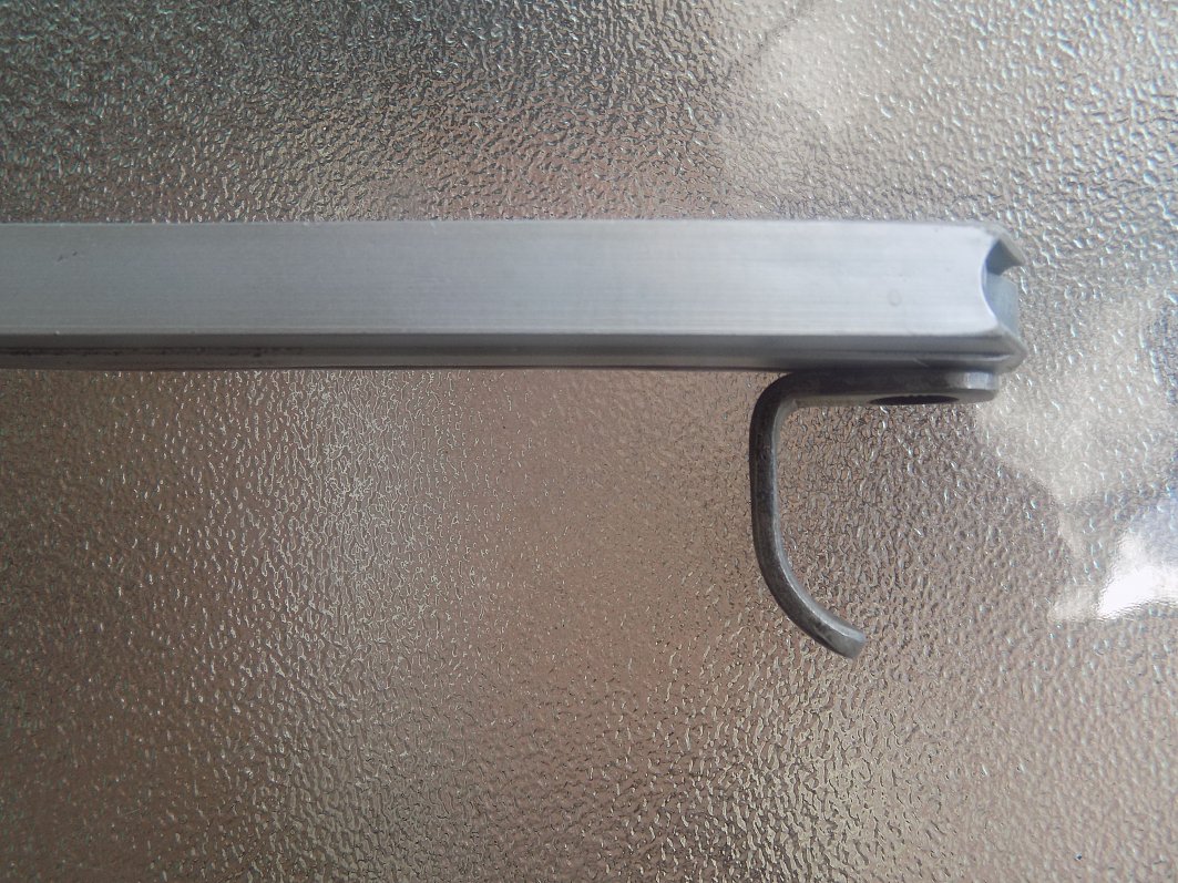

While we are on the subject a luger Family made this hand loader that because of my disability works like a perfect and easy charm. It hooks on like a take down button and uses your thumb for all the compression! It should be sold commercially. Please help me track his down as he is sitting on a goldmine!! Eric
