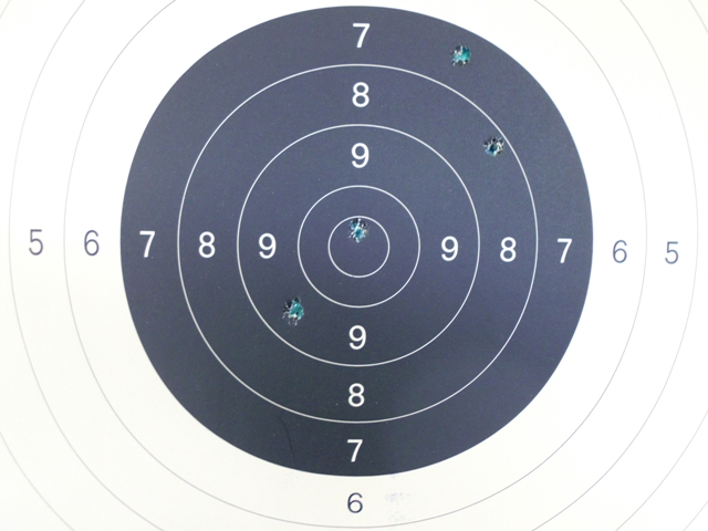

Passing to accuracy performance , lets have just a few results, from the total shooting made handhelded at 25 meters.
5.0 grains BA9

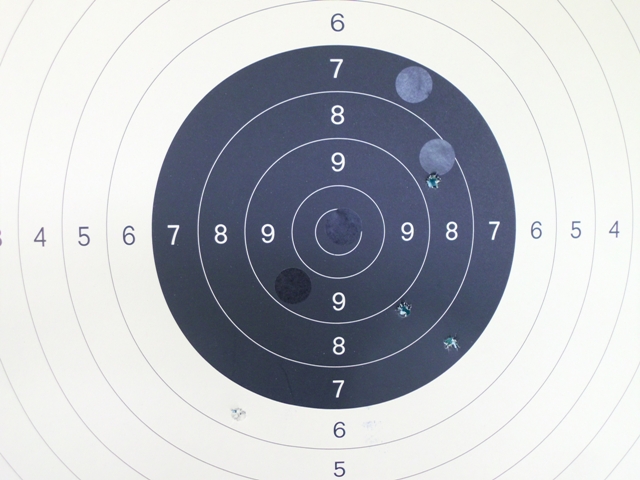

5.5 grains BA9

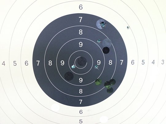

4,6 grains BA9
As I noticed that higher charge would spread the shots, decided come down and teste lower charges and got the last target image.
For the moment i´m gona stay at this mild charge and watch how is it gonna do in futur shooting.

You might just want to consider using a bench rest, or sandbags when shooting for load accuracy. That will remove a good portion of the "human factor". Just a thought. Always glad to see different loads and how they perform.
