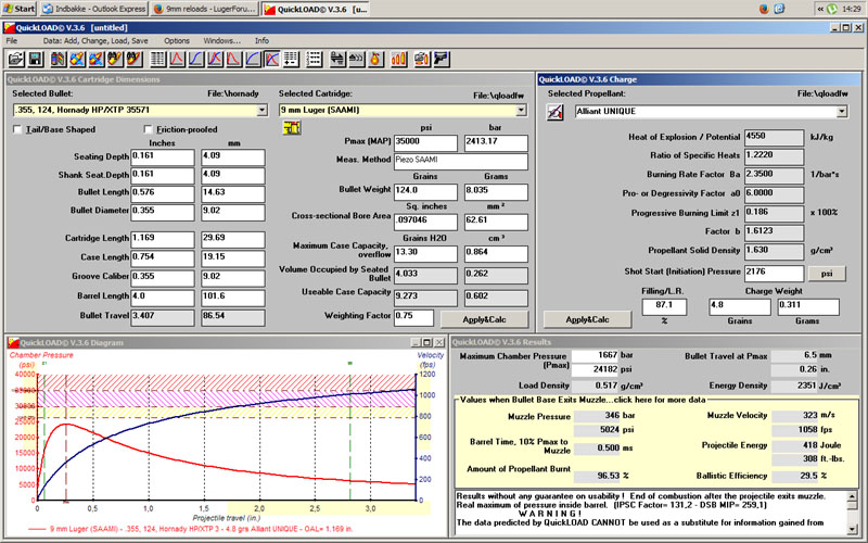

What is your OAL?
Quickload says 87% filling at max. (1.169") so you should be good.
Even if you seat to 1.13" there should be a little air.
