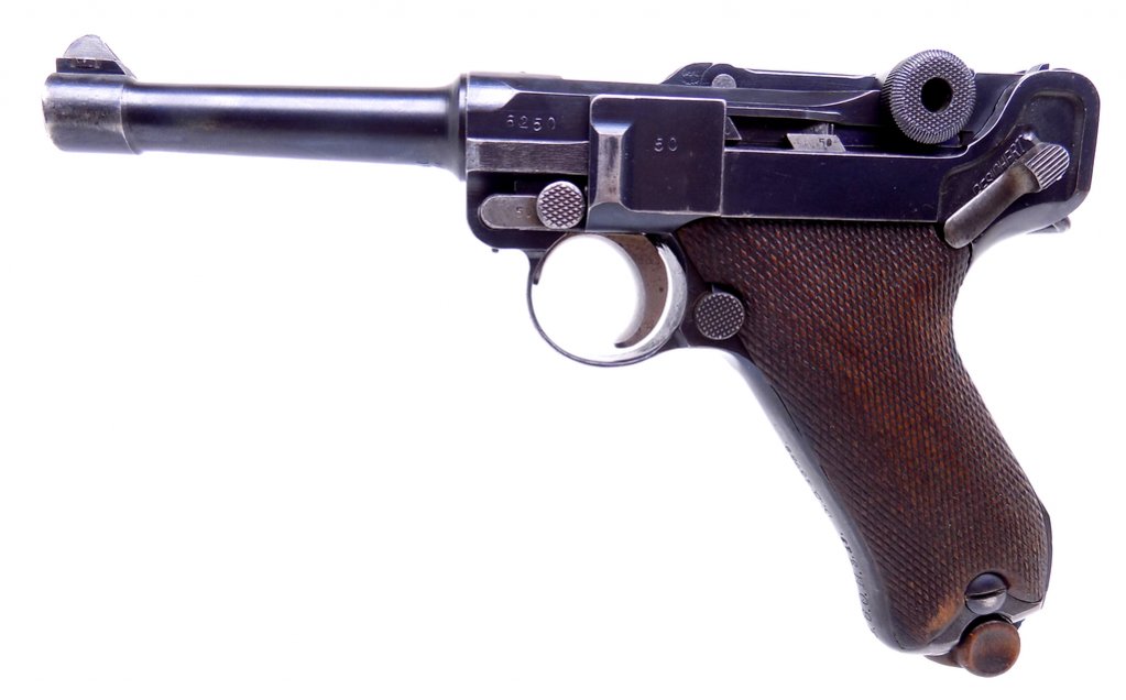

I have wanted a Luger pistol for a long time and now have the chance to purchase this pistol. This would be my first Luger. It is a DWM and I think it was a Police gun from the markings on the front strap and think it was made sometime around 1920. All numbers match. What do you Guys think would be a fair price and if I fired a couple of rounds would that hurt the value? Thanks in advance.
| The following 3 members says Thank You to JBBOOKS for your post: |
#2 |
LugerForum Life Patron Join Date: Dec 2009

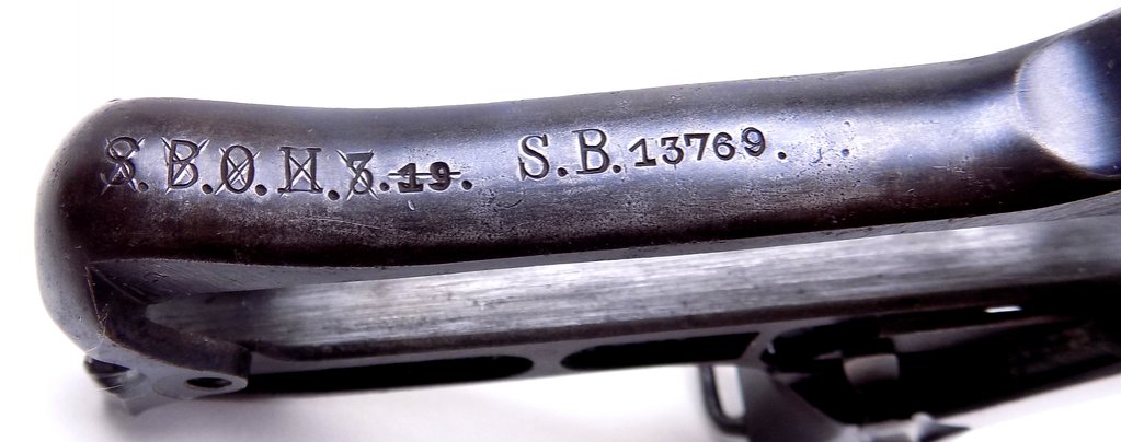

Looks like a Luger that was used in police service in Berlin. The "1921" date on the chamber is the production year, and this one looks like it did not receive the modified sear safety or magazine safety.
The serial number stamped on the frame looks odd. I can't tell if it's been renumbered. It's certainly something that needs looking into. I would expect Weimar proof and acceptance marks on a 1921 pistol's receiver. Have these been removed, or were they ever there? Shooting an all matching gun won't affect it's value. Shooting the gun and breaking a numbered part will affect it's value 35-50%. Your experience may vary. If you buy it, it will be yours to do with what you want. I don't shoot mine, but for every one shot and broken, mine go up in value a little bit since there are fewer collectible guns. I can't answer your question about value because I'm unsure if it's completely righteous.

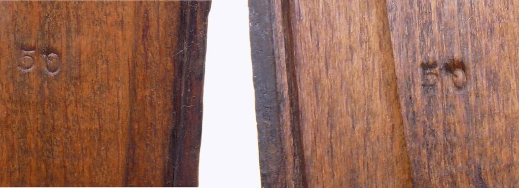

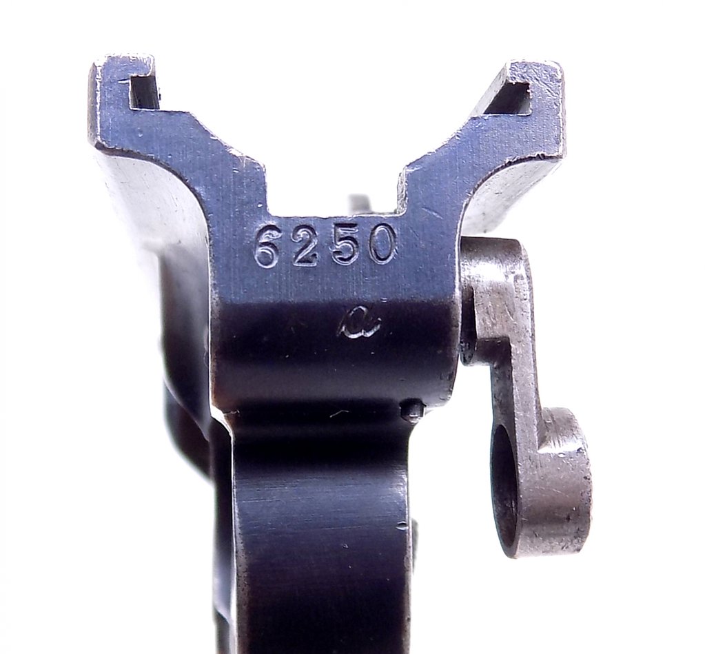

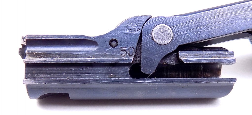

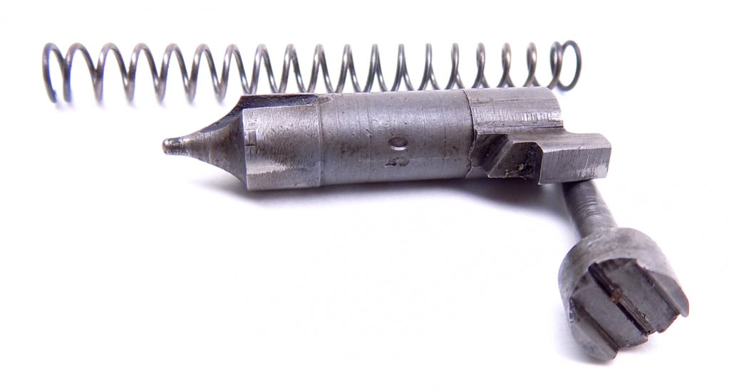

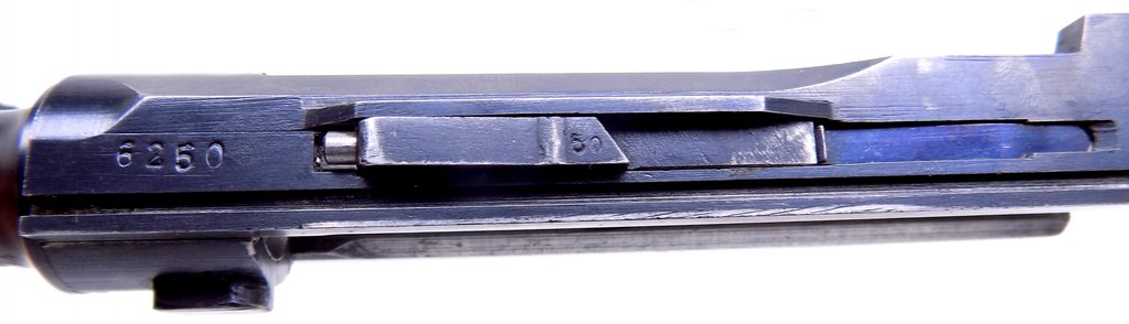

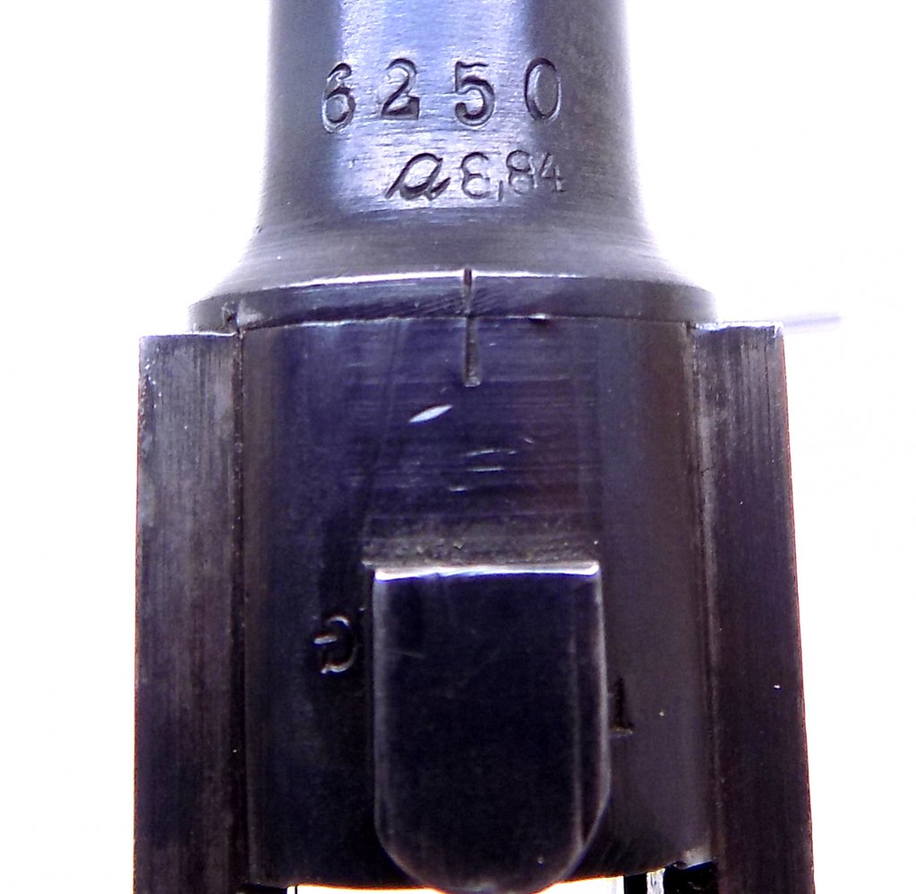

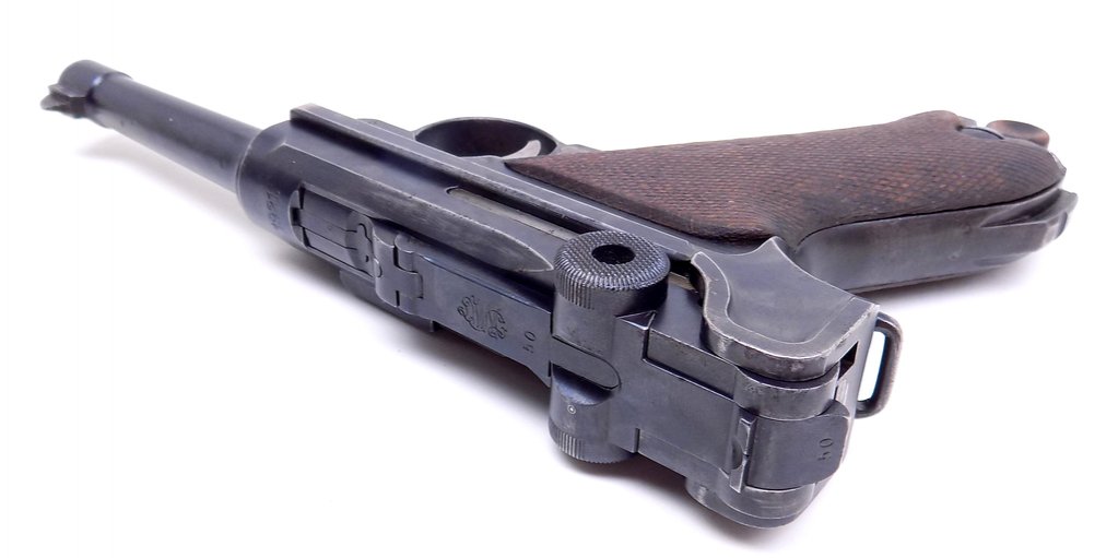

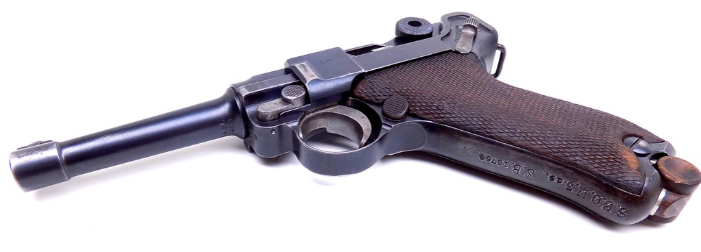

Here are some other photo's please let me know what you think as I respect your opinions. Thanks.

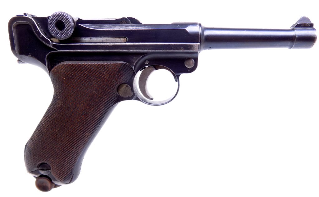

Forgot the most "important" one!

You have not shown the one picture I would like from above - a Berlin police would have a sear safety - if it had one, its been removed.
$1000-$1100 is a normal to low price for a police luger, even if it is missing the sear safety The weimar 'dove'acceptance markings and proof on far right were only done for a short time and I would expect this to be dated 1921 or if in 1922 - not dated Ed

Ed,
you can barely see the top of the side plate in the last picture of the first post; not cut. That is why I said "barracked" police.
