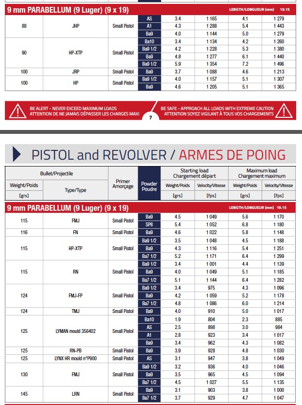

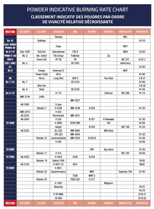

Is your gun a 9x19 and not a re-barreled gun in some government-approved other 9mm variant?
Always start at the start load and work up the load.
Vectan, Nobel, VV appear to be the biggies.
You can get some load data from the web site, you can get some load data from their "free" manuals (if they have them), or you can look for a complete manual. Attached is some data from Vectan.
File Type: jpg Screen Shot 2017-01-11 at 16.48.10.jpg (180.6 KB, 323 views)
File Type: jpg Screen Shot 2017-01-11 at 16.49.36.jpg (176.7 KB, 317 views)
