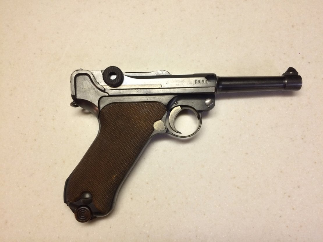

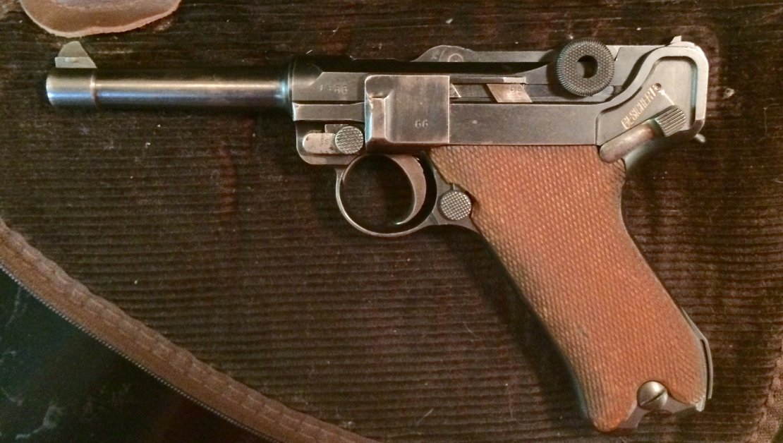

Hello,
My father left 2 Luger pistols after his death. Thank you for any direction on identifying these is greatly appreciated.
Not pictured, Luger with 34325.

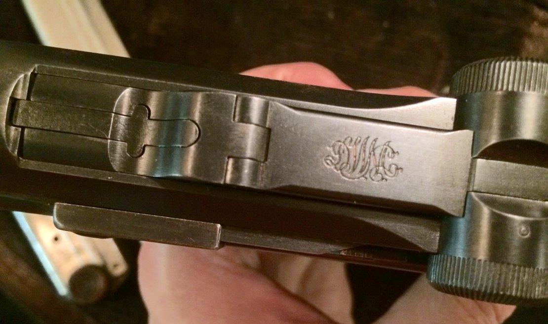

You will need more, and close up pictures.

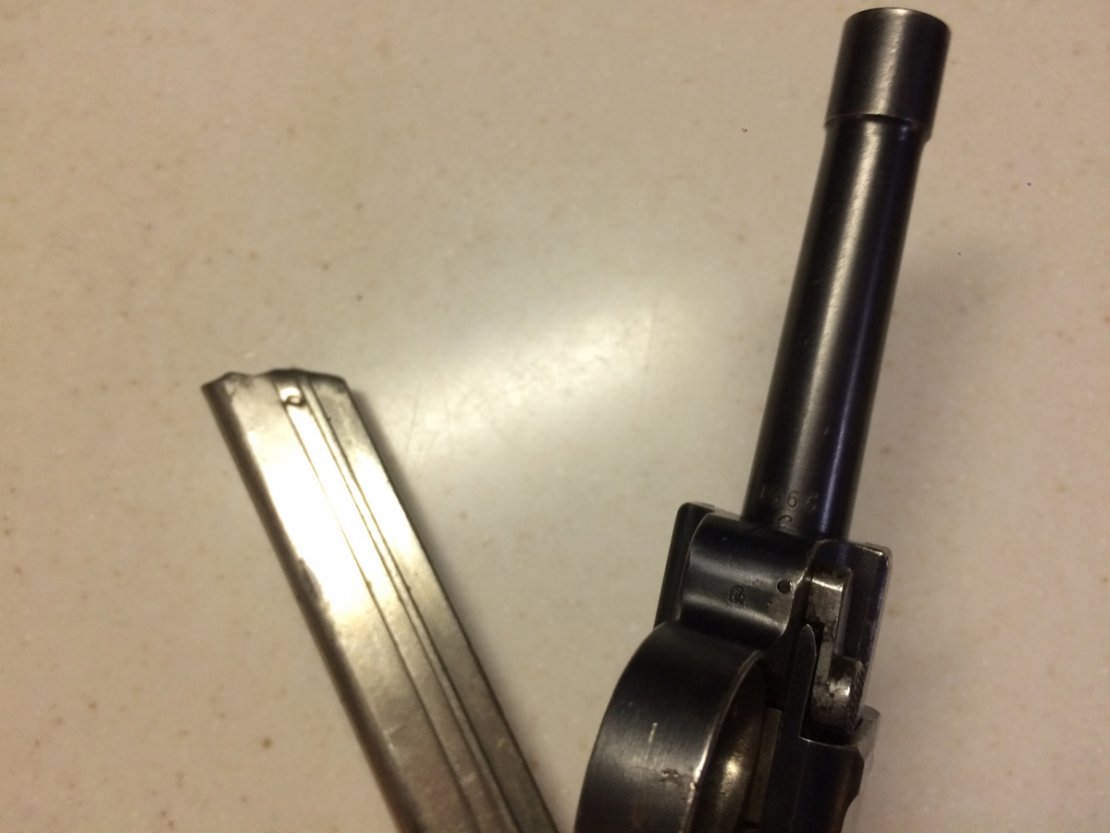

There is a date on the top of the chamber that I can't make out. The receiver appears to have DWM acceptance and proofing.

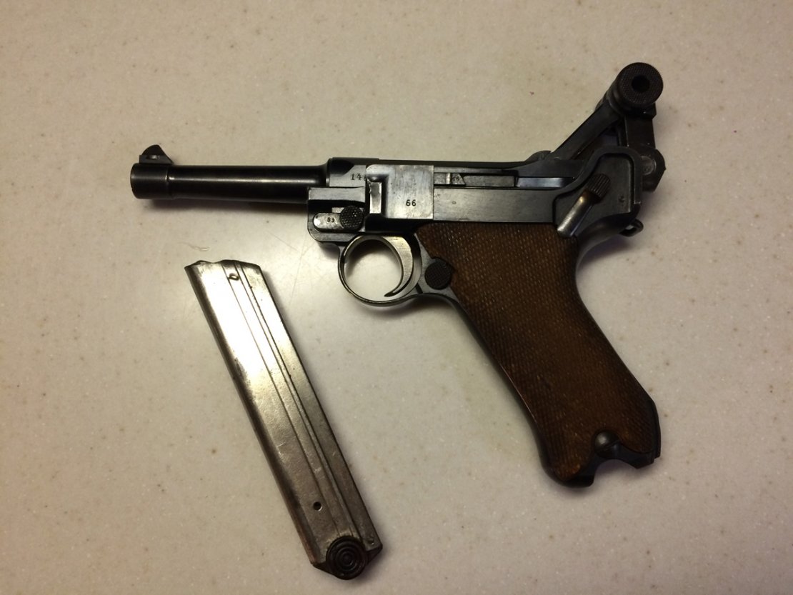

Unread 11-23-2016, 10:02 PM   #3

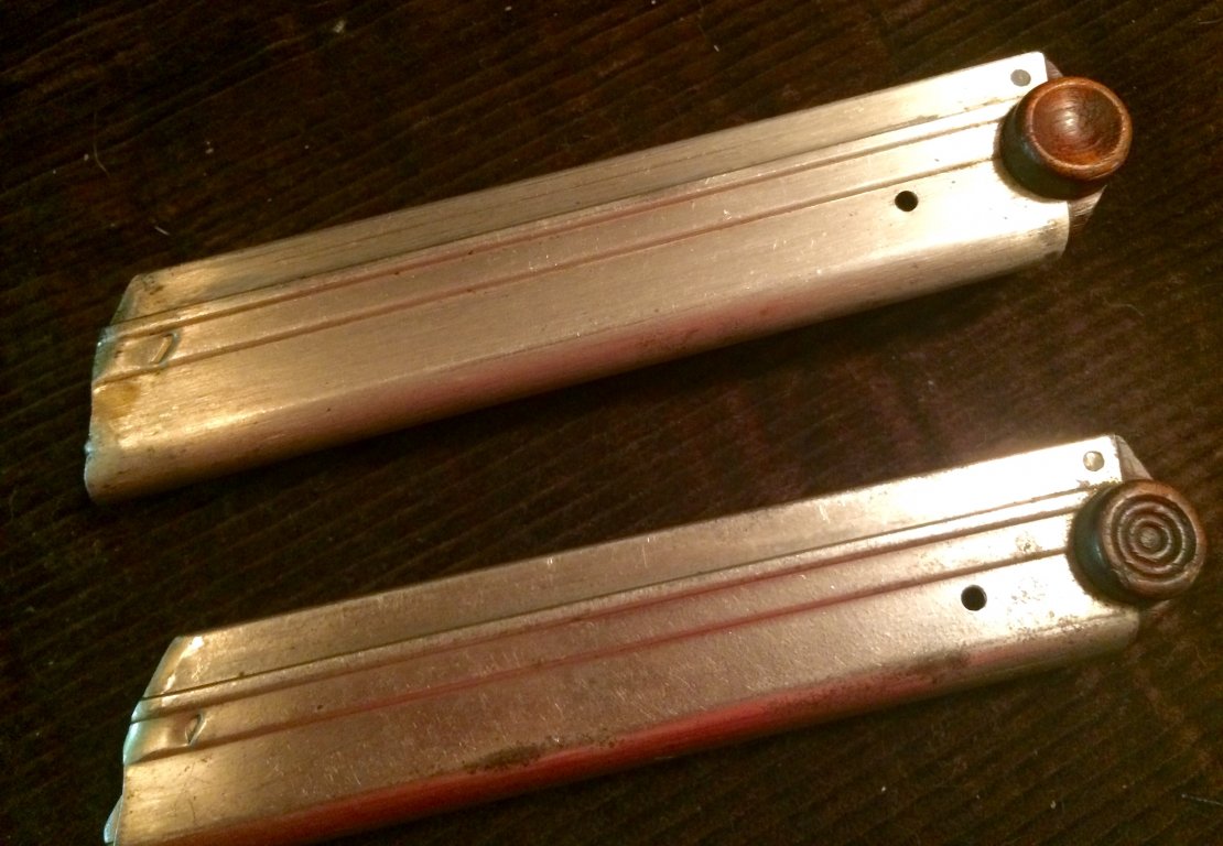

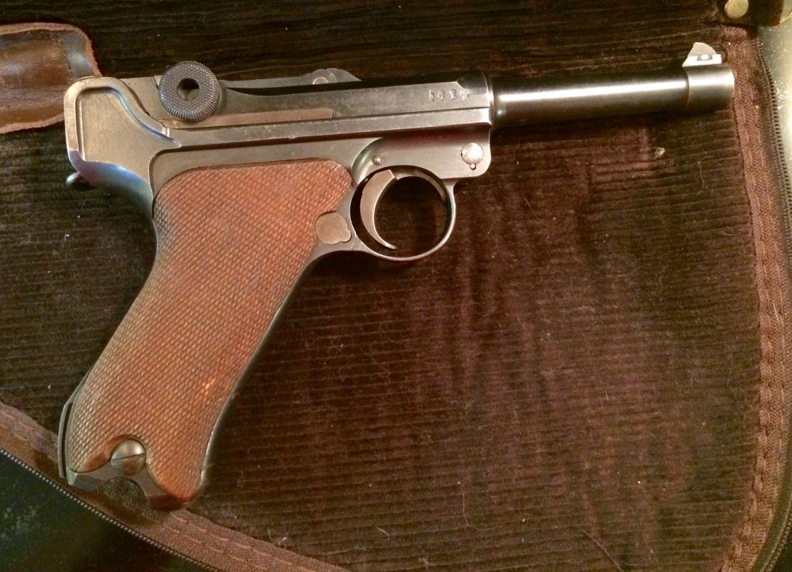

Looks like a nice WW1 DWM gun with original finish. Bad news is that the magazine is not correct to that gun, but the good news is that it is for a Navy model and is one rare bird.
The other gun is probably a commercial model.
More photos and info. on both guns will get you info. about them.

title says 1918 - assume by lack of erfurt, that it has a DWM toggle
as said above, words, lots of words and pictures

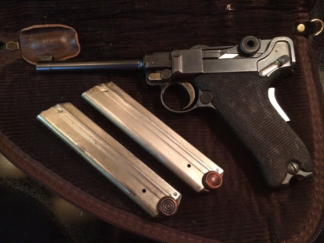

Thank you all for the advice. Brings back memories of my dad. I was just mentioning the one, with details, so to get one done at a time so photos wouldn't be mixed up or confusing.
Not really sure what to say about them other than they are 9mm (as far as I'm aware). I probably had the wrong clip in the pervious photos. We have fired them, but it been about a decade since. So, from what I know they do function. Again, not positive about the caliber.
Mauser(?) Luger marked with 34325. Post to follow with remaining photos of this model. Then will post about other Luger. Give me about 15 minutes for the other one.

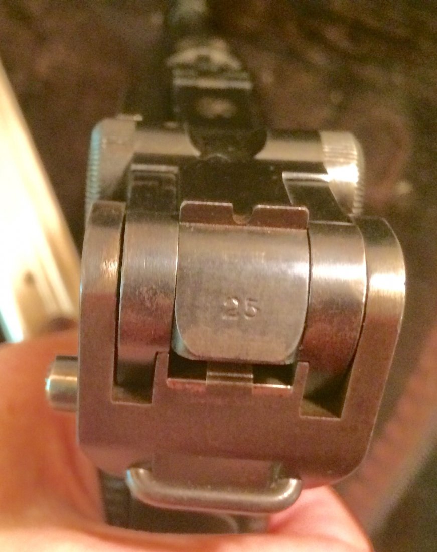

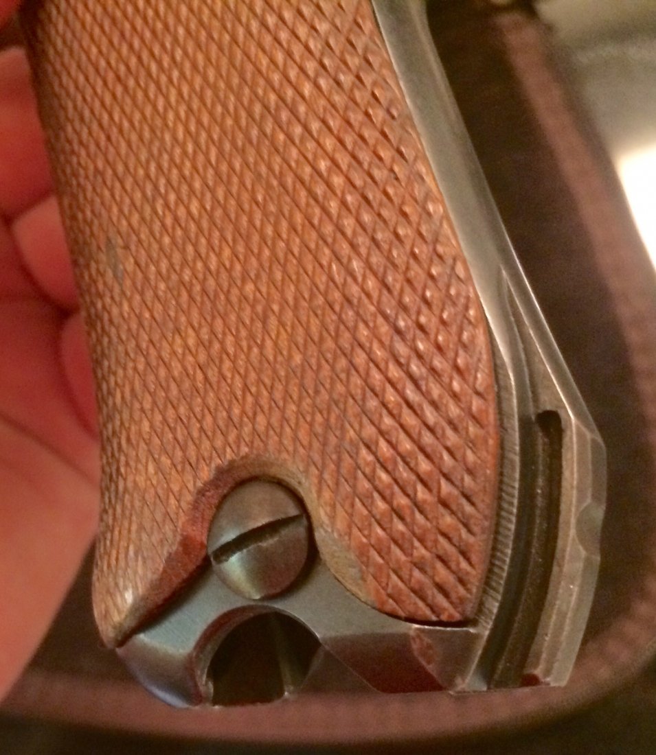

Additional photos of 34325

Hi Scott,
Welcome to the forum! The Navy magazine (the one with the concentric rings on it's base) interests me. Could you post a photo showing it's numbers and markings? It could be of some value to an owner of a matching number Navy Luger.
Thanks, Norm

Luger 1466 marked (following post will have remaining photos)

Unread 11-24-2016, 12:19 AM   #10
Not really my area, but 34325 appears to me to be a commercial model of 1906, made for export to the USA market, referred to as an American Eagle model. Most likely NOT 9mm, but .30 Luger.
Both guns appear to be unmolested originals, and very nice pieces.
Congratulations, and welcome to the forum.

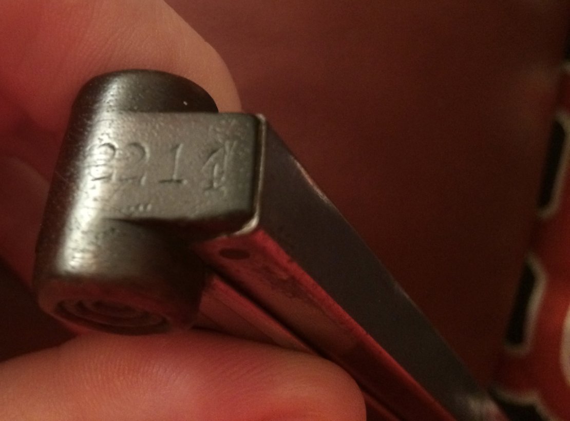

Sorry. I missed the question about the clip. Here you go. Says "2214" on the wood.

Unread 11-24-2016, 02:43 PM   #14
Hi Scott,
Thanks for posting the magazine photos. Unfortunately there are no known Navy Lugers out there numbered 2214, several close though.
Regards, Norm

Thank you Norm. Wonder if the one my father had was a fake then. Mainly now, I'm worried about the magazines these 2 pistols have. Might suggest some faking or alterations.

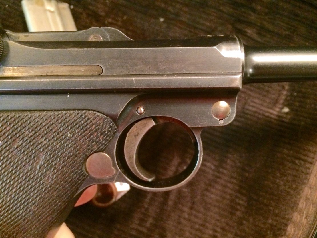

I believe the 1819 is faked on the 1466 (because the 1819's I've seen are stamped 1819, where this one is engraved). Still waiting for someone to try and ID that one.
Thus far, I understand that:
34325: 1903 American Eagle 0.3 (763mm?)
1466: WW1 DWM
Any suggestion for a title for these so I can sell on GunBroker would be very helpful. I don't want to price them wrong but also want to honor my father by not letting them go for too cheap. Planning to invest that money into my son's continuing education.

I'm not so sure the number in the magazine base is 2214.
Unread 11-24-2016, 04:52 PM   #17
I think he has it right. If it was an 8 or a 3, the top would be smaller than the bottom. The lines are right for a 2.

@kurusu, Think you are right about that. Might be that the "4" is just scuff/scratch. Very hard to tell. Might just be 221. Scratches kind of look like an off set number. "4" or a "1". Thanks for helping me look at it more closely. I definitely need to look into getting a new glasses perspiration.

We have a rather useful FAQ available. Just download the PDF you'll find at the FAQ reference page.
You have two collectible Lugers. They look to be in very good condition. In your earlier post were you referring to "1918" rather than "1819"? I don't see anything wrong with the date stamp above the chamber from your pictures, but better sharp pictures with more detail might help with judging that better. Rather than being engraved, it might have been struck with a sharp new die. It might also have been touched up by an engraver at some point.
The "RC" revisions commission (rework) mark is rather unusual on DWM made Lugers. This is generally seen on Erfurt manufactured Lugers.
The "c" is part of the gun's serial number, and a suffix letter.
