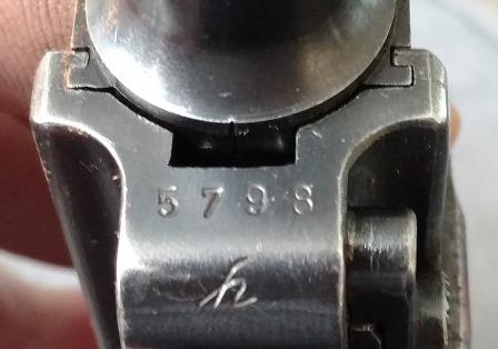

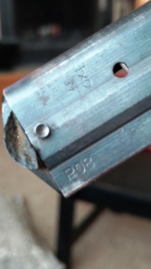

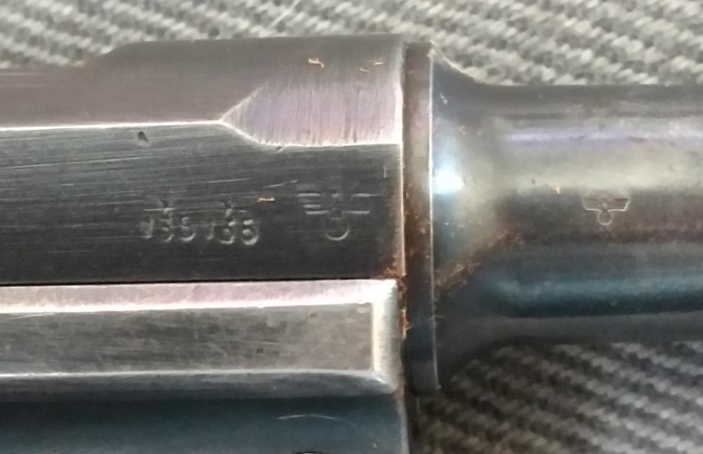

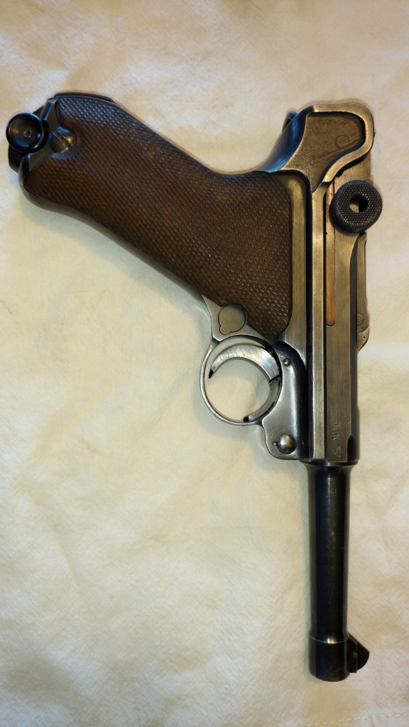

Hey guys, great site! Picked up my first Luger today - externally matching (haven't detail stripped it to confirm firing pin and internals match) BYF 42 with matching mag and spare mag with 5 rounds of WWII era ammo included. Only obvious issue to my (a complete Luger novice) eye is the cracked FXO magazine base. I think I got a pretty good deal on it based on pricing in "Standard Catalog of Luger" but I did have a question on the spare magazine. From some quick internet research it looks like a Luftwaffe mag but I have no real idea. A P38 was actually next in line for my collection but I couldn't pass on this. Any additional info on the mag would be appreciated as well as any issues I might have missed. I'm not looking for value to sell but hoping for once I didn't take a bath on a collectible pistol I've wanted and finally bought

Sorry for the poor pictures, they didn't resize well on the phone. Stamp on the magazine base is a droop wing eagle with "2" under it.
BKS613 is offline   Reply With Quote
Unread 11-06-2016, 04:22 PM   #3
Post some usable pictures. Particularly of the base of the aluminum magazine and the top of your Luger and other exterior markings present on your Luger.
E/2 marked magazines would go with Krieghoff Lugers.
"BYF" is the concealment code for Mauser made Lugers.
If someone ground down and force matched the magazine by renumbering it, they did you a great disservice. If someone somehow found a magazine with a matching number, that would be quite a feat...
There are members here like GT that can repair your plastic based FXO magazine.
Is there a suffix letter on front of the frame under the numeric digits of your serial number? If so, it's part of the serial number.

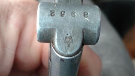

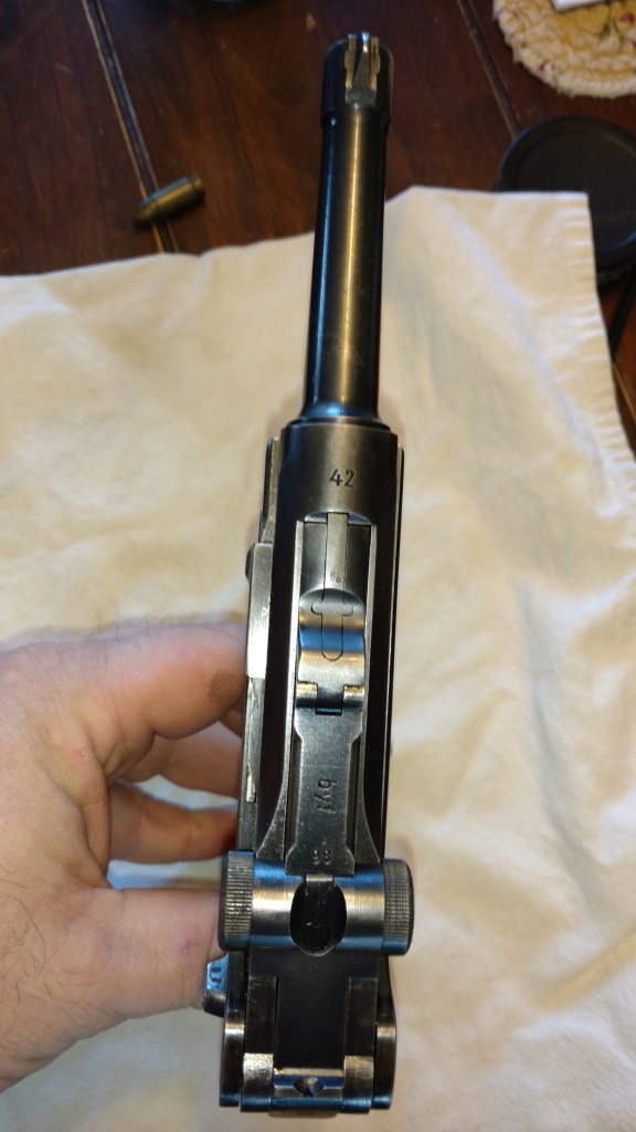

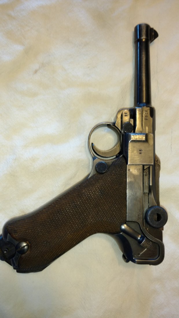

Thanks for the reply! I knew BYF was Mauser based on my other forays and what I meant by matching mag is that the P08 and FX0 and eagle/37 stamp look correct for the gun based on my limited research. Better pictures attached. Thanks!

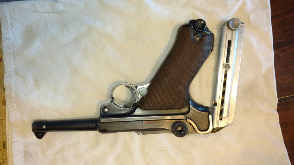

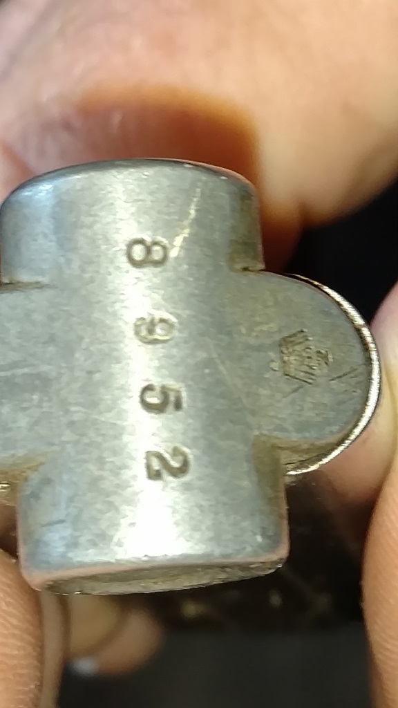

Additional photos. Looks to be a 5xxx "h" block pistol. Thanks!
Yep. That is a very good score in itself.

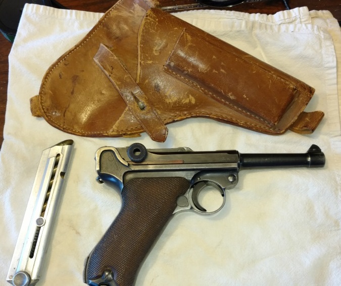

Your holster is aftermarket, probably made here in the USA after the war.
I sent you a PM about your magazines.
Your 42 byf Luger sn 5798h is in great original looking shape. If all matching, it is collectible. I would not shoot a high condition collectible Luger because of the risk of breaking a numbered part.

Thanks Marc! All external part serials I can see match - I'll check the firing pin and extractor when get around to detail stripping it. Any other serialized parts I need to look for while I have it apart? I figured the holster was either post war or if original so damaged/cut up as to be of no value other than keepiing the spare mag with the pistol Thanks again for the information!

I have bought a couple of decent (and this one is far better than decent) for $1000 and re-sold the Krieghoff mag for a profit - they are worth more than 'normal mags'...
I was at a gun show in Chantilly, almost across from Geo's table was a guy with a barely decent WW1 luger. I looked at it and it had a Krieghoff (eagle 2) mag in it. Asked if I could buy it, he said, no, I should leave it with the gun, thats how it came. I said I understood, but a wood base would be correct. I said, I would trade you a wood based mag and $100 for yours. he looked at me like I was an idiot. I walked over to my table, grabbed a wood mag and traded him...
I would not say that I made a huge profit when I sold it, but a small profit and got an ok kreighoff back into collectors hands

Nice catch !!!!!!! The Krieghoff mag is VERY desireable and many hoard them as your PM box has probably shown you . FWIW I have 1937 HK serial 8309 with the wrong mag in it and I also have minty black bottom mags for your byf . Your Krieghoff mag is worth WAAYY more than the black plastic ones and if someone hasn't already talked you out of it send me a PM . Also read the threads at the top of the Krieghoff forum to get an idea of how hard it is to buy Krieghoff mags with all the hoarders chasing after them . Again nice catch and a really good price . Dave

Thanks guys! I had no clue about the HK mag. I assumed it was a $100 mag since it had the Waffemamt on it but I was actually disapointed it didn't match the one in the gun until I found out what it was. Maybe I was due as I've l lost a few bucks on WWII stuff due to lack of research. Haven't decided what to do with it yet other than be happy it's in my safe!
