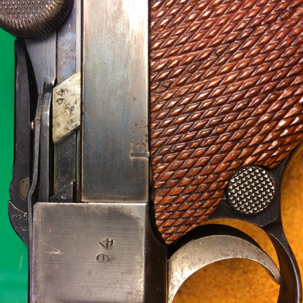

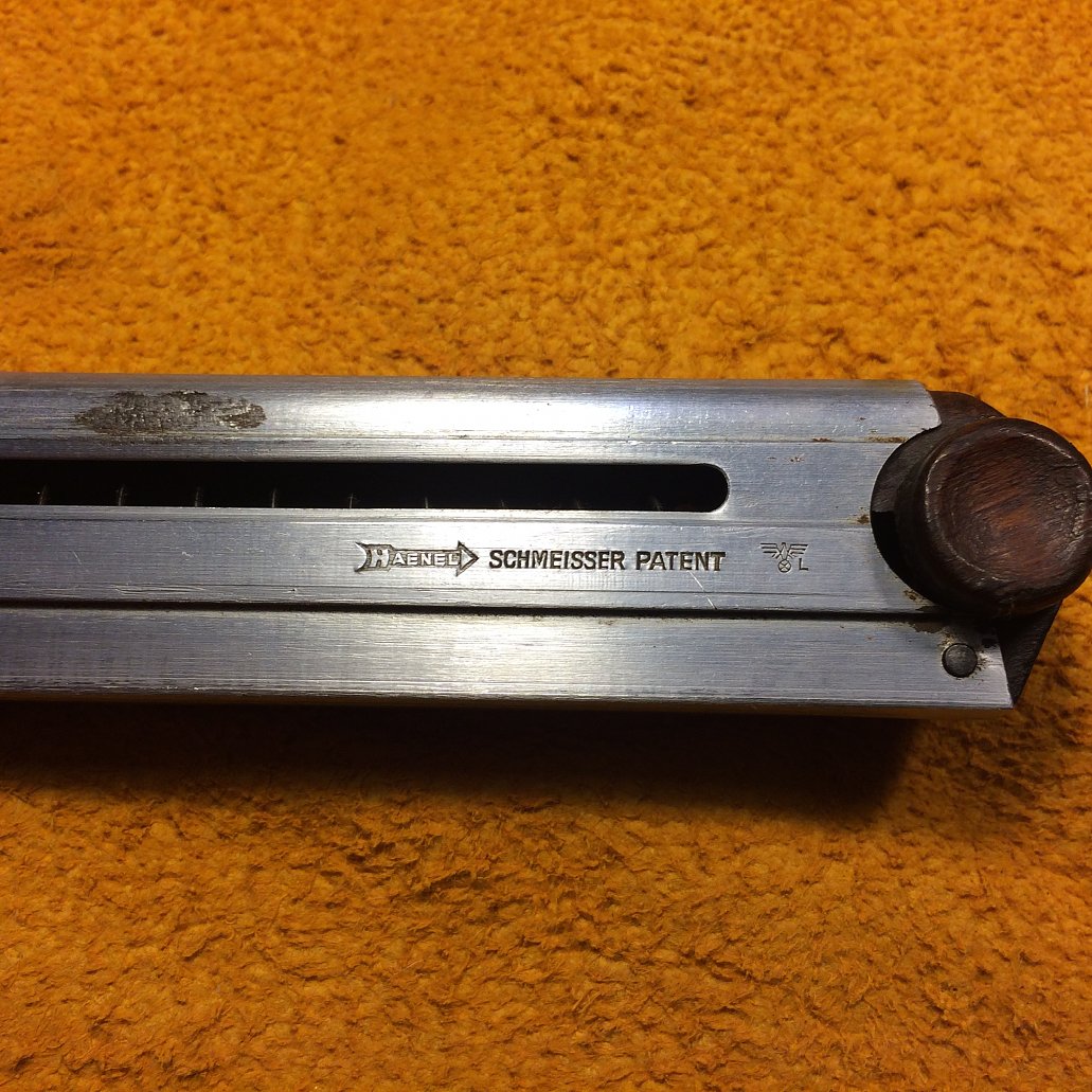

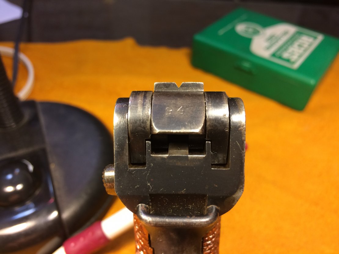

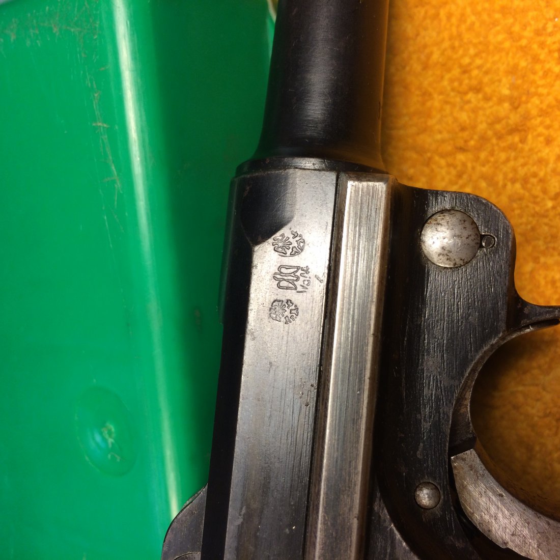

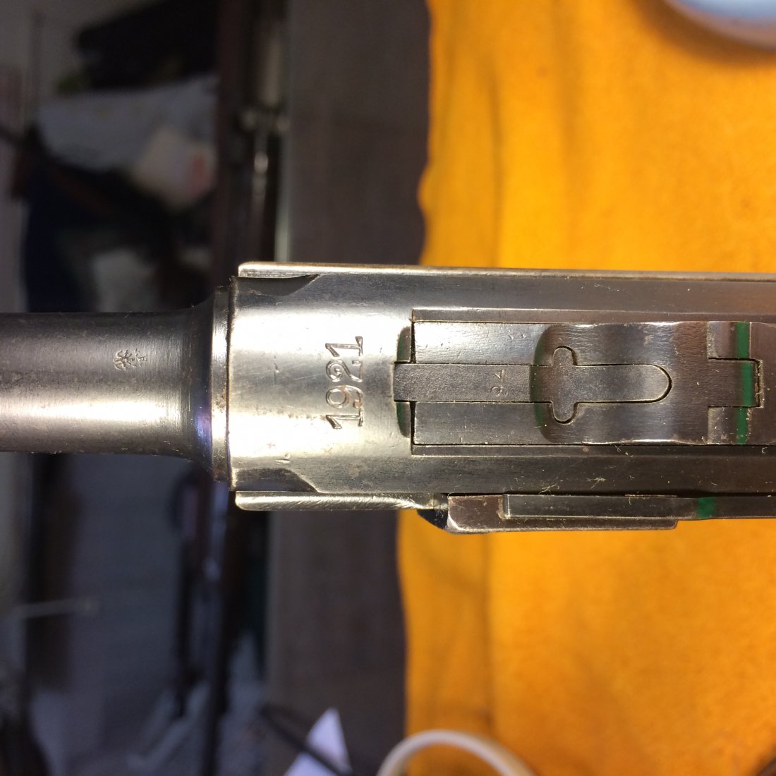

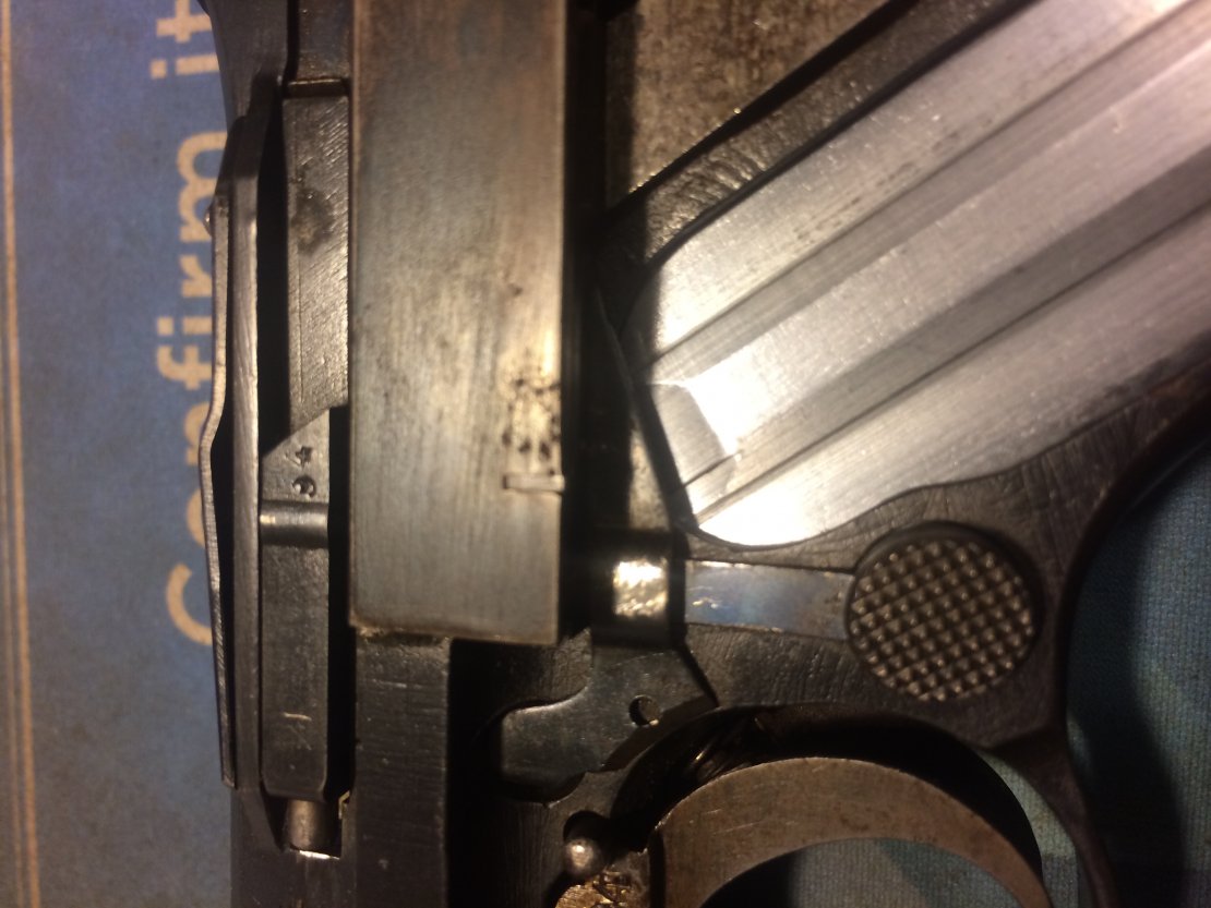

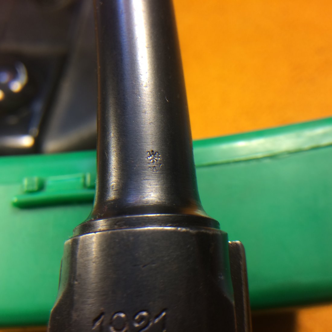

Hi..just purchased a luger and need some help identifying it. First I state what I think I know
DWM all matching, 1921 chamber date, 4 digit ser #, bore code listed under ser #, no numbers on front or back strap, has sear saftey, has magazine saftey not working but there is a part still in the frame though it dosen't protrude into the magazine well, the only numbers on the gun are the ser # and bore code. grips were refinished (ouch),
My questions are...What does the 1921 chamber number, proof marks on the right of the reciever and top of barrel mean...What can you tell me about the magazine.
here are some pictures
Any help is greatly appreciated

Unread 10-31-2016, 07:28 PM   #4
Datig states that he has observed chamber dates of 1920, 1921, and 1922. on 'new' Lugers manufactured/assembled for the Army. (pg 131, The Luger Pistol).
Your pistol also has the Schiwy sear safety indicating Police use. There is also evidence of the magazine safety having been fitted, also indicating Police use.
It would be interesting to remove the left grip and see if the magazine safety is intact.

Hi Bob, and welcome.
What does the 1921 chamber number = year the luger was made;
proof marks on the right of the receiver = inspection after processing stages and final proof;
top of barrel = barrel firing proof;
What can you tell me about the magazine - Magazine body made by Haenel as it says, wood bottom is beech, a police magazine as indicated by the two, and mismatched to the pistol you show.

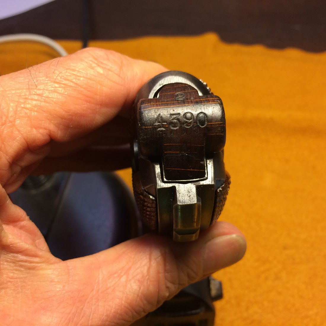

You don't show the serial number, either on front of the frame of left side of the chamber; which usually helps to id the pistol.

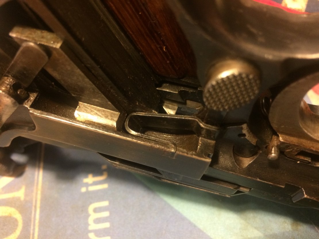

Unread 10-31-2016, 08:28 PM   #7
Bob B
Join Date: Oct 2016
Posts: 8

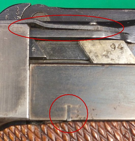

there is part that goes from the area circled over into a hole in the fame...it dosen't protrude into the magazine well . I've attached a couple of photos
Bob B is offline   Reply With Quote
Unread 10-31-2016, 08:43 PM   #8
Your magazine safety is deactivated in one of several "ways" that are seen. The projection into the mag well and behind the trigger have been removed.
Some are cut back even farther with just the "U" left in place; others have been removed entirely and the slot left open; still others- but not as many- were removed and the "slot" filled by welding and the repair spot refinished.
I have two pistols with magazine safties that have been "repaired" and now look and work as they were originally intended.
Only one or a few "original" intact magazine safeties have been reported.
Datig's book is pretty "dated" now, more recent fully referenced works have not reported the 1922 dated production. One of the members here has seen a "1922", original? Maybe maybe not, but they sure are not seen on the market- not even by the "fakers" of rare lugers.
Unread 10-31-2016, 08:46 PM   #9
Bob B
Join Date: Oct 2016
Posts: 8
Thanks for your reply.....how does the serial # help id this pistol?
Unread 11-01-2016, 12:53 AM   #10
There is a slim possibility that this pistol came from commercial production. The serial number would determine that.
Unread 10-31-2016, 10:03 PM   #11
The year dates it pretty exact. It was made in 1921. Also, see the dove acceptance, that's only for a short time.
Unread 10-31-2016, 10:08 PM   #12
Hi, the proof marks are appropriate to your pistol, and represent early Weimar period acceptance of the pistol.
IIRC all the Haenel Schmeisser milled magazines had aluminum bases. It looks like someone replaced this with a wooden base at some point.
The full serial number with suffix helps confirm that the frame and receiver are correct for the date (1921). (reference to 1922 was a typo...)

Thanks for all your help...the serial # is four digits, no letters, listed on the bottom of the barrel and the front and side of the reciever....the bore code is 883 and is listed beneath the ser# on the barrel
Unread 11-01-2016, 12:47 PM   #18
kurusu
Join Date: Sep 2007
Posts: 1,225
Thanks: 2,679
883 is not a code. You're missing a comma. It should be 8,83. And it's the bore measure in mm.
