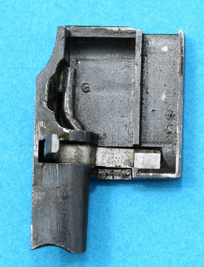

Thanks: 119
The inside of my 1917 artillery Sn 7412a has a "G". Or maybe it's a 6.
Tom
Unread 09-01-2016, 09:32 PM   #11
Tom
You are not looking in the right place. The numbers are on the bottom edge of the side plate interior. They are damn near impossible to see but they are there.

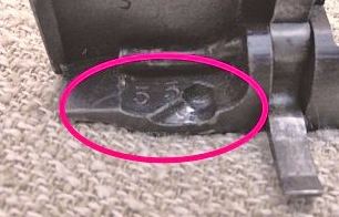

Unread 09-01-2016, 09:49 PM   #13
Seems like a heck of a pain to mark them in the first place?
Even on 1917 and 1918 Geo?
Not if one was finishing more than 100 side plates in a batch.
Without the inside two digits, one could not tell which pistol it was fitted to.
The very same reason Mauser marked their side plates inside; only mauser marked them on the flat side, not the bottom ledge where the lever pin locks in.
For those who didn't follow the link, here is the picture mentioned above with the inside DWM numbers circled:

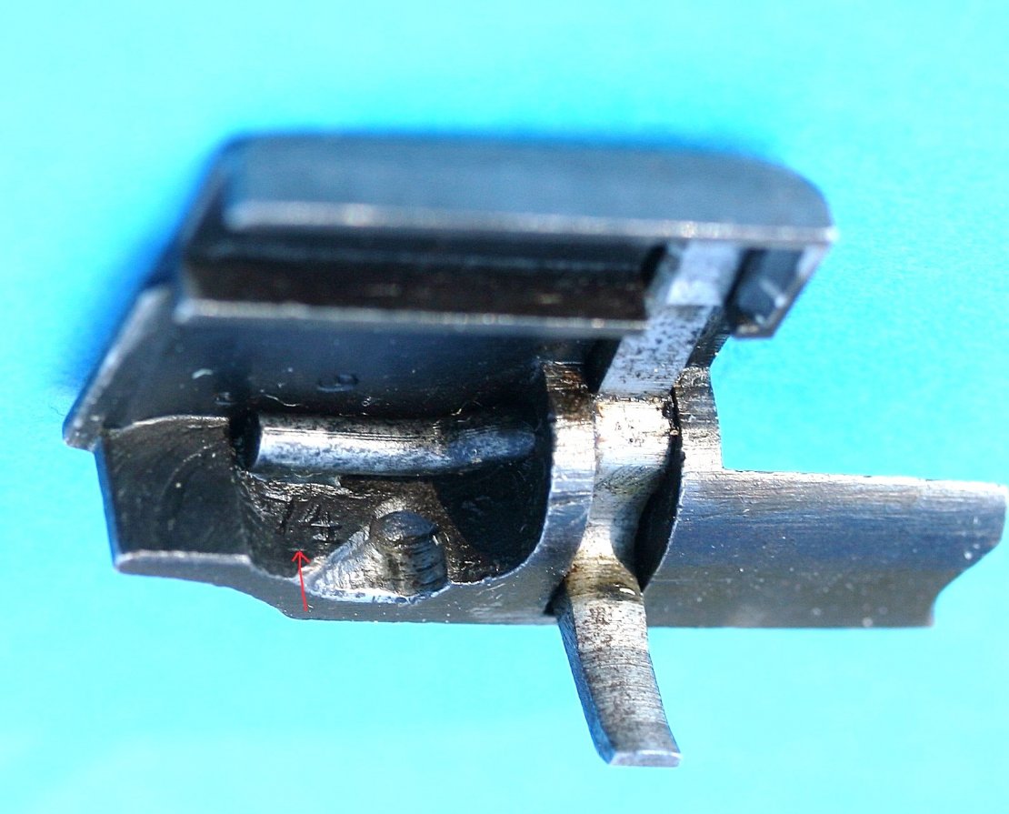

Oh look, a #74 !!
Unread 09-01-2016, 10:30 PM   #16
Yes, a 74!
They tend to be hard to see; one required quite a bit of cleaning to see- the numbers tend to fill up with crud and oil and "disappear".
