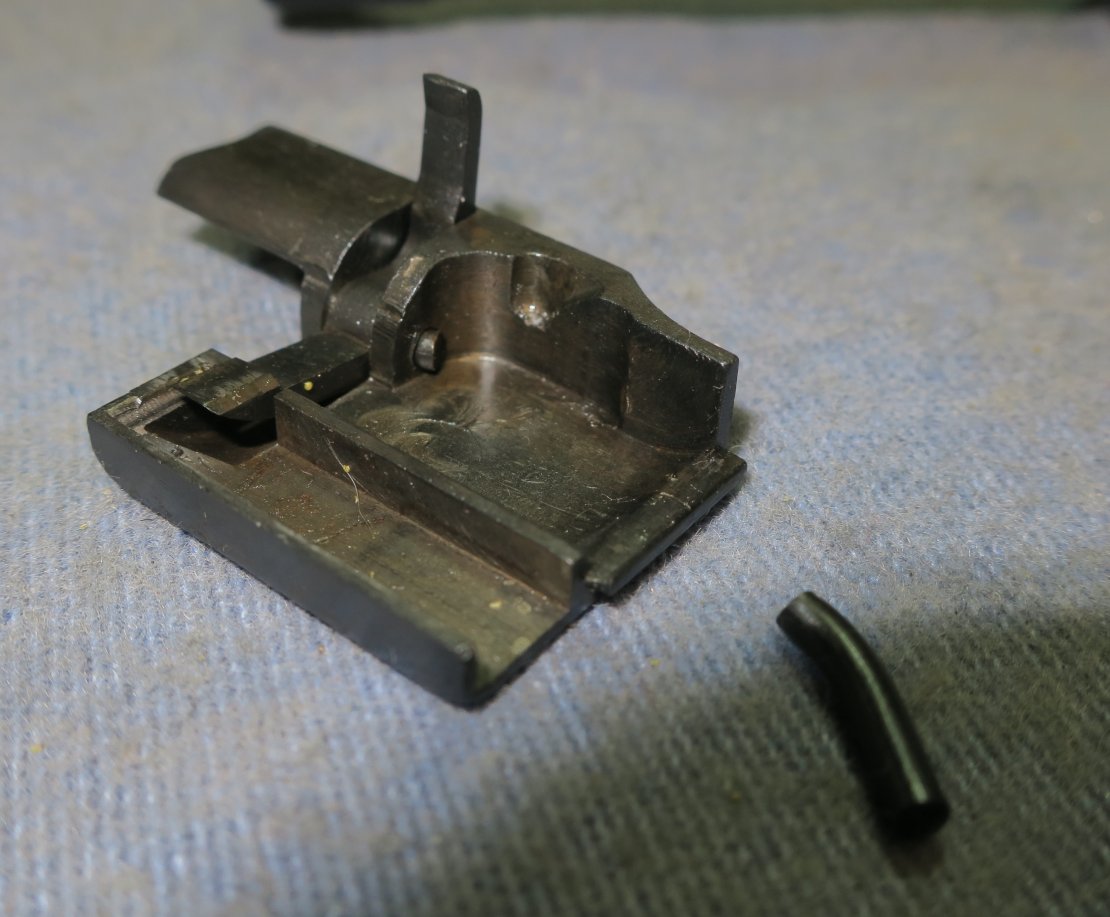

Hi all, several months ago, I posted about my well worn, plexiglass handled Luger:
http://forum.lugerforum.com/showthre...189#post282189
Thanks to many on this board, that Luger was transformed into a nice shooter. But today, it broke.
We were at the range (I think the 4th time since the gun was refurbished), shooting 115gr target loads as usual. After a shot, the action only came up a quarter of the way, and would not come up any further.
Brought it home, dis-assembled it and found that the trigger lever pin broke.
Is this common?
What causes this, just fatigue of a 75 year old gun?
Should I be concerned, or just replace it?
Any other thoughts?
Thanks.

I would not be concerned. It is a piece under some slight tension to hold it in place, and may well have just broke from fatigue ["old age"].
Tom Heller [Lugerdoc here on the forum] should have those pins in stock. If not, I just noticed today that Apex has them. I was surprised that Apex had any Luger parts, but live & learn.
It's interesting that it somehow jammed the sear/action. Maybe it got stuck under the trigger lever???

i have both originals and new repros in stock. PM sent. TH
Unread 10-02-2016, 02:09 PM   #4
Not common in breaking, but i have had them 'worn' and bent.
Just part of shooting I am sure

Jack, Push the broken piece out with a drift. It has to be pushed into the plate to come out.
These were hardened and if the tensil strength is too hard they simply crack like glass. I have seen quite a few broken.
When you replace the pin, you may have to force it a bit to make it snap in place. This could possibly be enough to crack a pin that's too hard. Whatever the cause may have been, there's no reason for concern. Just replace it and keep on shooting.

In an "emergency" or being lazy, you can just put a touch of blue loctite on the inside boss, let it set and shoot on; the curved part only holds the axle in place.
When you get a replacement just drift out the pin as Jerry says, use a hair dryer to heat first and it will be easier.

You can use 3/32" steel rod and peen one end of an approx. 3/8" long piece and then blue the rod. Push the new peened pin in from the outer side of the side frame and the take down lever will hide and prevent the pin from coming out. You have not modified your gun and it has worked for me after several hundred rds. Mine is a 1940/42 "Black Widow" model that looks like it did the day it was made.

That would be an excellent 'field expedient' repair, but maybe not for long term use. 3/32" is .0938" and the Luger blueprint calls for 2.5mm rod = .0984". ~.004" doesn't sound like much but it's that much more slack in the trigger chain. Pin inside trigger lever = .004"; pin inside trigger plate is another .004". So that's .008" slack - the thickness of two sheets of ruled notebook paper.

Sheepherder's remark is why I usually don't post to any forum and probably will never again. I was just trying to give the first writer a fix that is easy and works. .004" of play in the trigger lever is probably impossible to notice since older original pins have some wear anyway. I am not shooting a slacker, I am shooting a gun that the pin will probably outlast yours.

Sheepherder is an engineer/machinist and thinks in half thousandts; so cut him some slack, please.
Your suggestion is just fine, I have used fractional bits and rods for luger pins when I didn't have the correct metric size, most times they work just fine.
One can always "finish" the repair when the correct piece is available.

I guess the part about shooting a "slacker" got to me when it shouldn't have. I still have the original pin, but like shooting this gun and not having any worries about the original pin falling out. I actually got some new stock of 2.5mm rod and have already made a new pin which fits better. I have already been out at the range this morning shooting and enjoying the gun. I have no problems with sheepherder and his precise standards.

The Houston-made stainless Lugers use a simple rolled spring /tension pin which holds itself in place.
